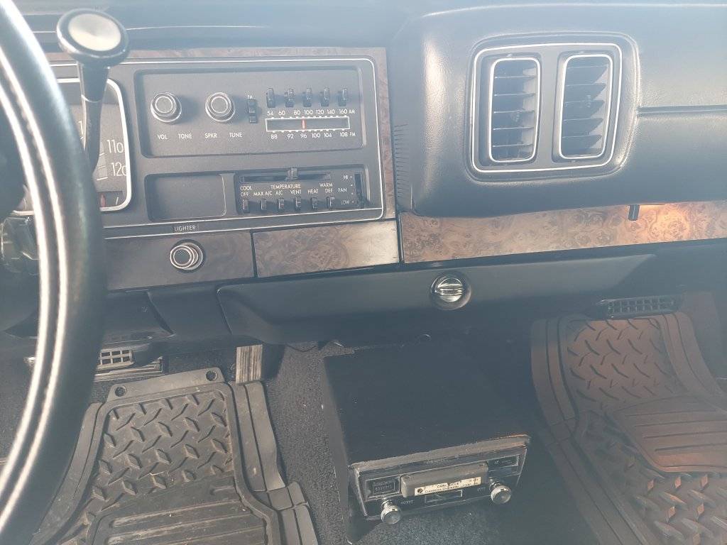

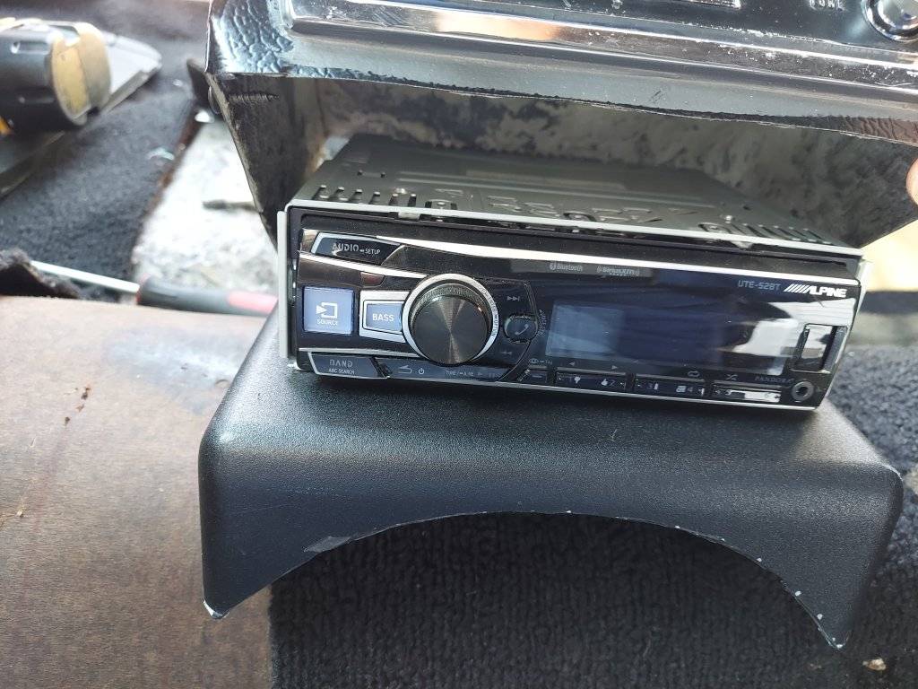

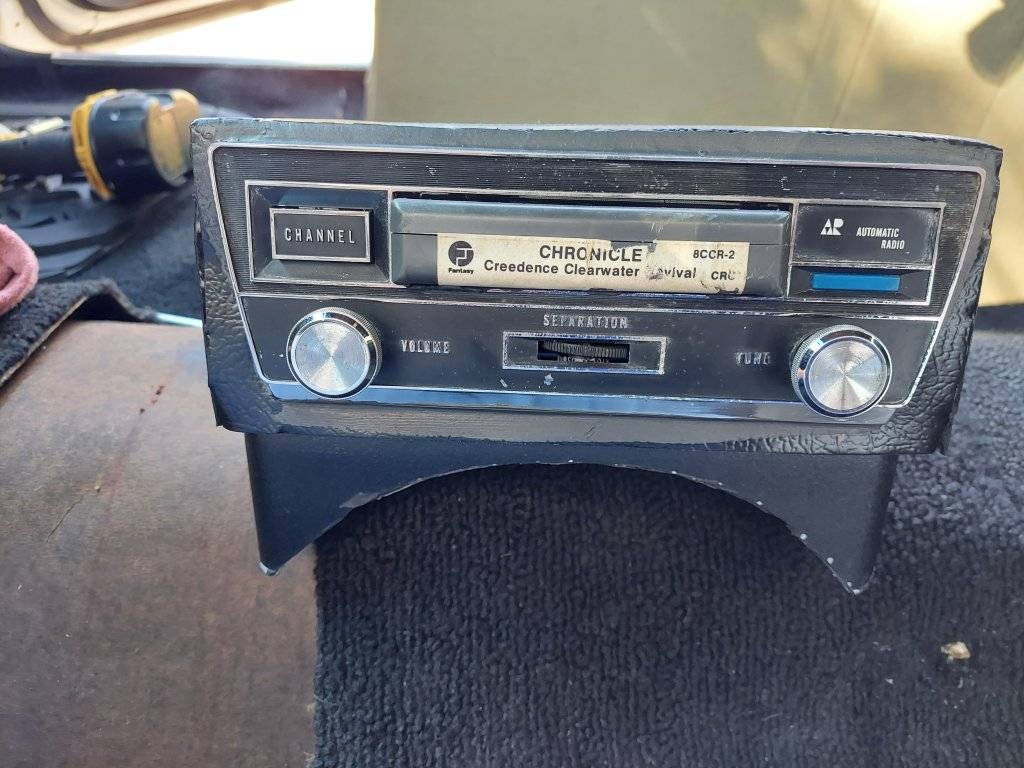

Here is what I did.... Blue tooth, so I don't break the law when someone calls, and I took the power wire from the clock to keep memory on the station presets. New Alpine 6x9s in the rear deck and a retrosound 4x10 { i think } in the dash. The head unit I traded for, so it was all but free. I made the box out of what was let of my fridge whan it died. I cut all the metal off the sides. I bought an 8 track on ebay for $35 and used the face only. The plastic base is a Metra under dash mount I flipped upside down and cut to fit. The speakers from Crutchfield. I have less $100 tied up in the whole thing. Oh the Creedence was $1 at a local junk store. I wanted "The Blues Brothers" but, they were too much on ebay.

Admittedly it's not my idea, I saw it at the end of a "just rolled in" video. I thought I can do that. So, there it is. I really tried to find a mopar 8 track pedestal. Well, I wasn't willing to pay what the person wanted. Thanks for the compliment

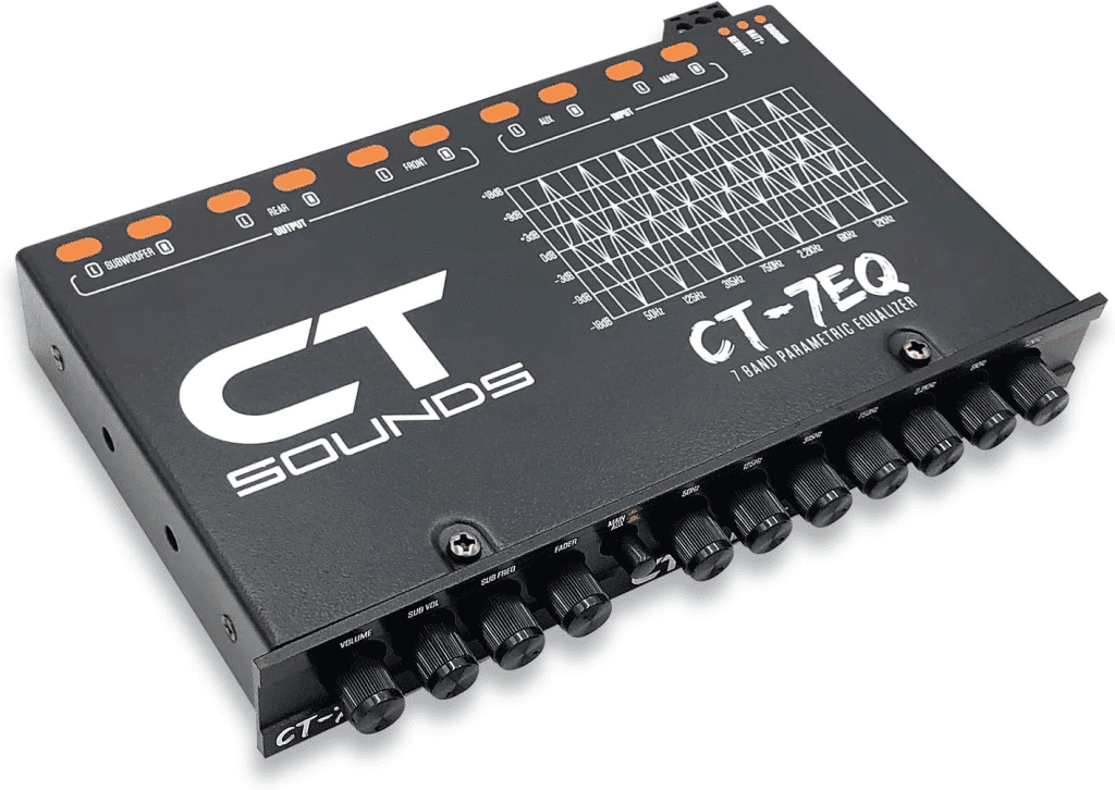

Not knowing your budget, what you want your music source to be, or the sound quality you want, it's a guessing game.
An option is to mount a slim EQ like this under the dash. Leave your orig radio in place for appearance sake?
Find an EQ that has a volume knob, like this one. (most have it, but not all)
Some also have a 3.5mm input jack on the front panel.
Connect your MP3 player to it with a 3.5mm cord, or a 3.5mm-adapter into the RCA jacks in the rear.
You'll have volume control from both your MP3 or the EQ (although that one will be a long reach).
If you are playing via Bluetooth from your phone, you could find some type of BT adapter to mix into this.

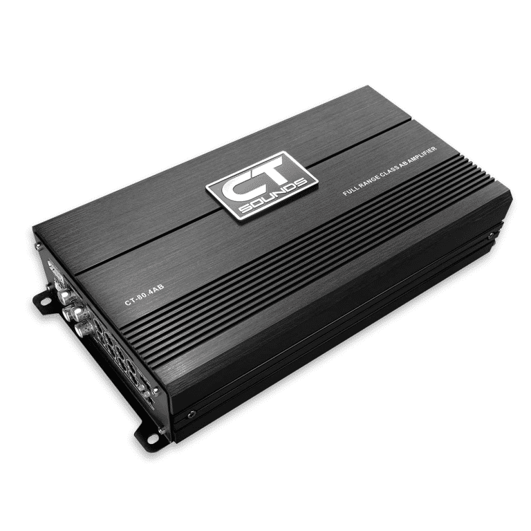

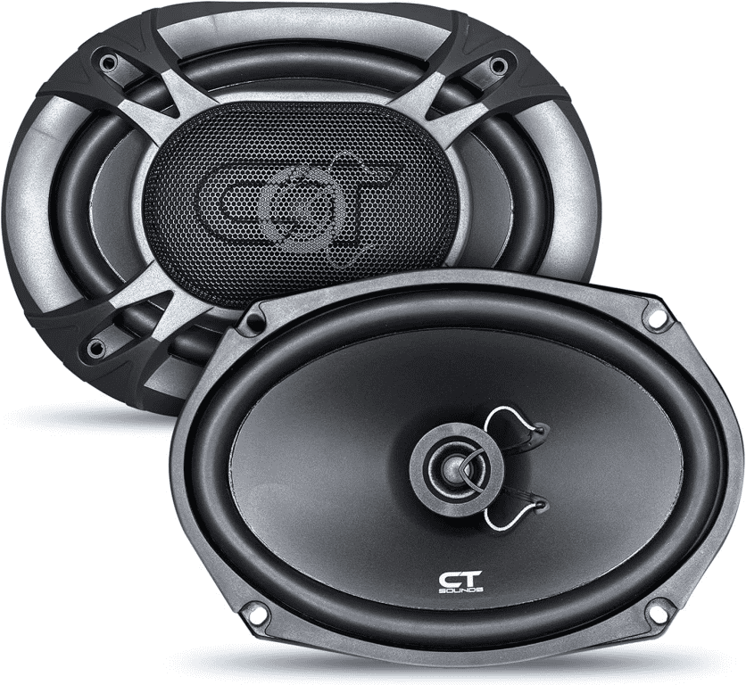

I have this little EQ and it seems OK, and CT Sounds has a decent rep on amazon.
The 6x9s have a silk-dome tweeter and should have non-harsh highs.
The amp is 4-channels, so if you ever wanted to add front speakers or a wooferbox. (a single 8" is sufficient for most of us old guys)
If you want to cut cost, a Boss 2-channel amp should suit well.
If this route interests you, I could make more suggestions.
If you are wanting to listen to AM or FM - I have no more suggestions.
