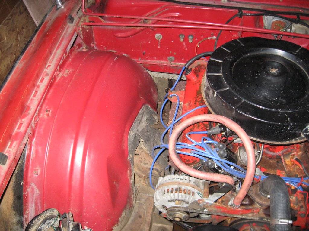

Side question here - is the “holder” supposed to be engine color or satin black? I’ve seen both …
Correct color matches the valve cover color. In the case of the crinkle black valve covers on some 426HEMIs, the case is black, also. Otherwise, engine color. By the time the Chrysler Blue started, the valve was on the lh side and put into a rubber grommet rather than a tube.
