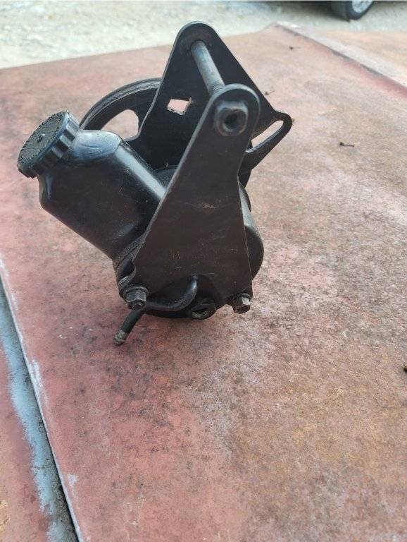

I asked before and I'll ask again, where God can I actually get a power steering pump?
My current set up has a lot of play in the steering wheel. I plan to get a firm feel gear box to go with this. Hopefully tighten it up and not have so much slop, and no leaks. I did pm rainy day so hopefully that is a good option.

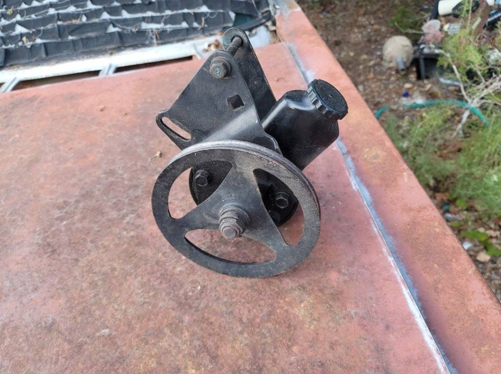

The question to ask first though is what is failing with the present pump? That tennis ball in the existing bracket makes me wonder what's going on with that.
Because the pump is adjusted wrong. The two brackets should be next to each other with a rubber bumper that goes into a slot on one of the brackets. It's the same bumper as a manual trans clutch pedal bumper. The pump bracket should be pulled from the bottom when adjusting.

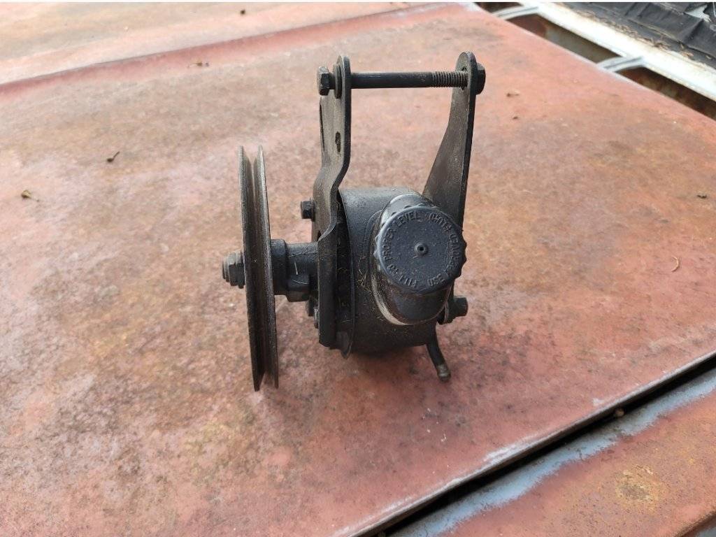

Here's the saginaw power steering pump setup I have.
Have a 68 Newport 383 with a Thompson style power steering pump. I've already had it rebuilt and it's failing again. I just want a reman already done I can just quick swap. Was told is part number 20-6107. I have looked high and low, far and wide. Everybody sends me links that carry some other year or from a quick glance looks like the part but isn't. I'm just shocked a simple part can be this difficult to find. And bonus points if it comes with a reservoir cap which seems simple but isn't. I love my car but Damn it's difficult. I seriously have spent hours upon hours looking and calling. I'll be getting a firm feel gear box but they'll only redo my pump, none available to buy. Help!!!

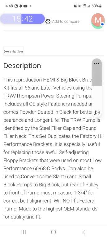

The bracket on other hand I deleted it for a new repop that does away with the glop that causes belt ssqueal.
You will need a different size belt, cant remember if it is a 15545?

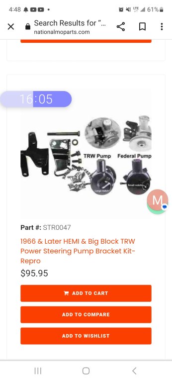

Nstionsl Moparts has the bracket, pump rebuild kit, or msy have a good used pump. Tell rm I sent ya!!
National Mo-Parts – Est. 1987
