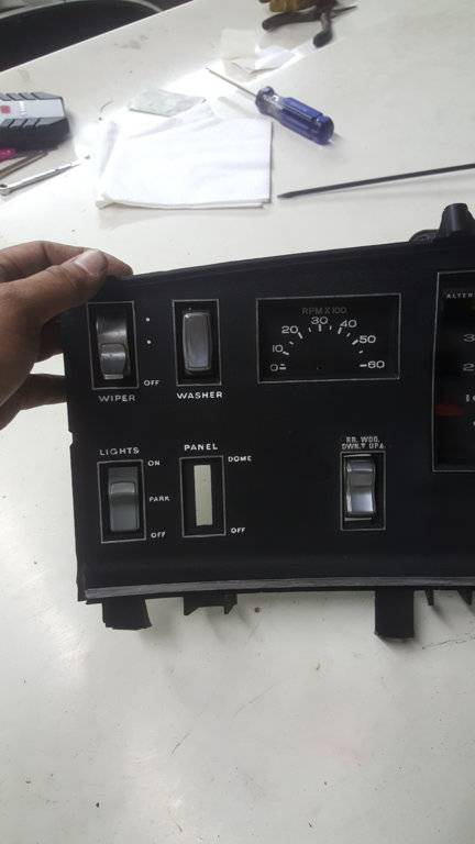

    @Welder guy got the sticker done now just gotta find a RPM guage to fit the clock housing. And get it ready to go in my 70 wagon.

    Hey man looking good!!

    How was The install of the decal on the clock face ? It’s good to have a steady hand. If you can find a tack like the 2” one I used, the new needle fits on to its shaft nicely. The 2 1/2 tach I first had didn’t work nearly as well. Check eBay for them !

    It wasn't to bad just took my time making sure to line everything up nice. The material used is awesome i got lucky and had a spare cluster without a clock so there is no hole to fill in. I'll be searching around for a small tac thanks for the help again.

    Hey the bezel with no clock adjustment hole is the perfect choice for the tach conversion ,It looks perfect ! I’m going to have to keep my eye out for one of those now. Keep me up dated with pictures.

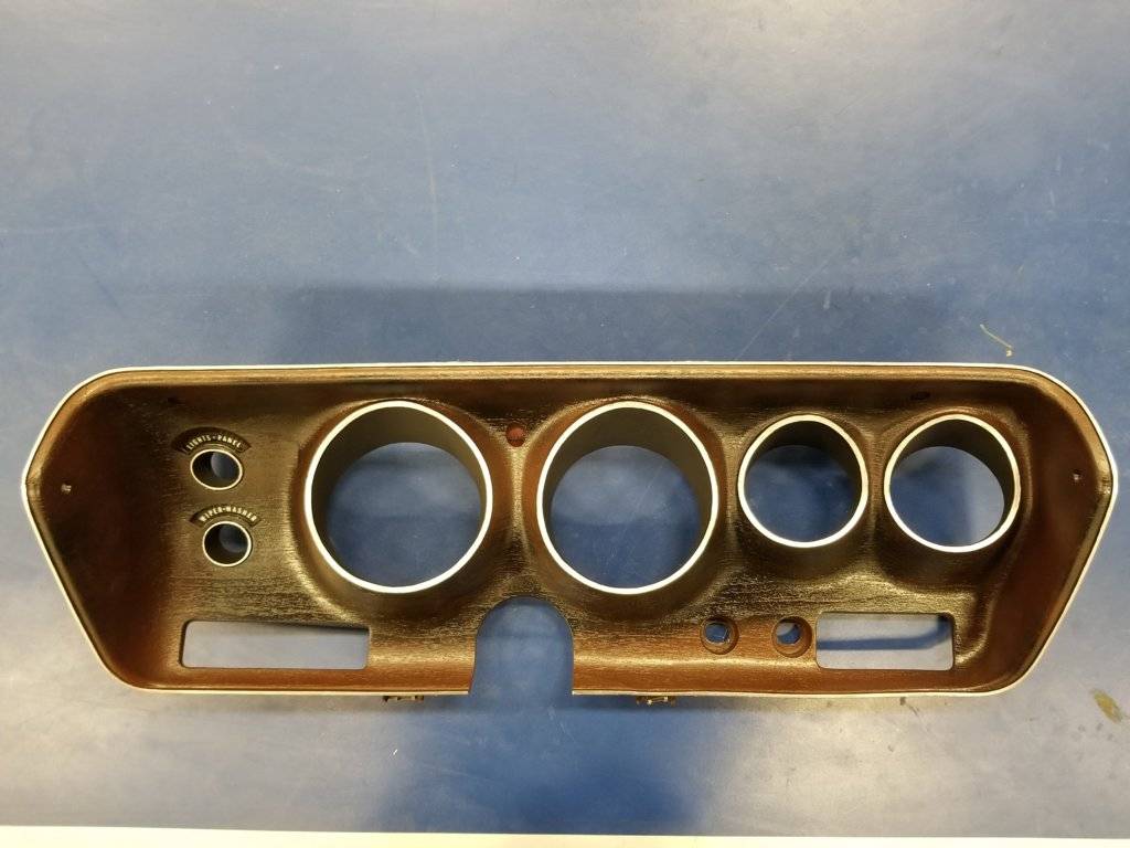

    I cleaned up the dash bezel parts And polished out all the cloudiness and scratches from the clear speedometer and tachometer lenses with and optical grade rubbing compound . I used A MOLOTOW liquid chrome Marker for the chrome detailing around the switches , speedometer and tachometer edging . This stuff was damn expensive but looks good!! It works well for detailing small chrome plastic parts . The next step is to have the clock adjust hole filled in by a friend of mine that owns an automotive vinyl / plastic restoration shop . That man does wonders with grills , dash bezels and interior parts . 4C725D4C-247A-46EE-B862-730911DA1CD7.jpeg 4F57E50C-8F6D-4145-A9EC-8A5C2A8E87F6.jpeg 6440904E-A34E-4D90-80F5-D7678D8564BF.jpeg 8F3715B4-C975-427D-8C82-4DAE53D2E962.jpeg 3170E110-A52E-45D7-AC14-7655E64652C5.jpeg 8C915254-2353-4A39-92CF-BF70D97BA13F.jpeg 57C8DE84-BC7D-41B6-88F5-C1A876F7814E.jpeg 23CCE939-1026-4987-86E7-D351C73CFCFF.jpeg
