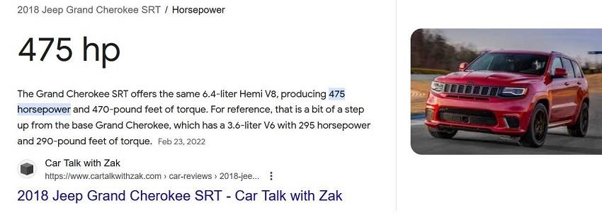

First off...how are you getting that HP figure?:confused:Have Moser build you a custom Dana 60. Forget the AWD...sell your current transmission and get an 8HP from a Hellcat or SRT Challenger.I am assuming you went with Sound German to control the 8HP.

Here’s where I got the HP donor car stats
2018 Jeep srt
Forged drop ins
Full Bwoody
P1x procharger-9 pounds boost
Eibach-pro's
1050 injectors
Gt haus exhaust
90mm BBK
MMX Cam
870HP
93 gas

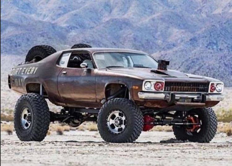

Sometimes a conversion to AWD doesn't need to look like that. Here's an Trackhawk morphed into a Charger/Magnum...
There's a whole series of this build, granted it is easier than a c-body.
