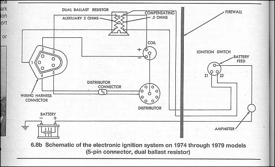

Wiring errors can be found by comparing your wiring to the wiring diagrams at the end of chapter 8.
