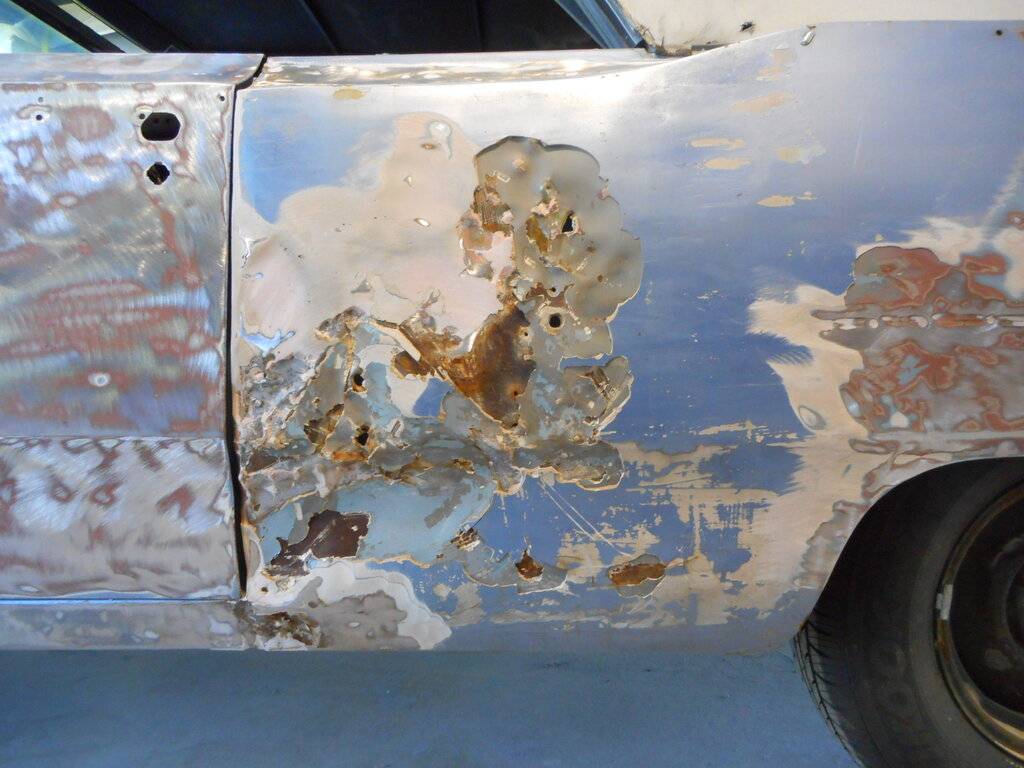

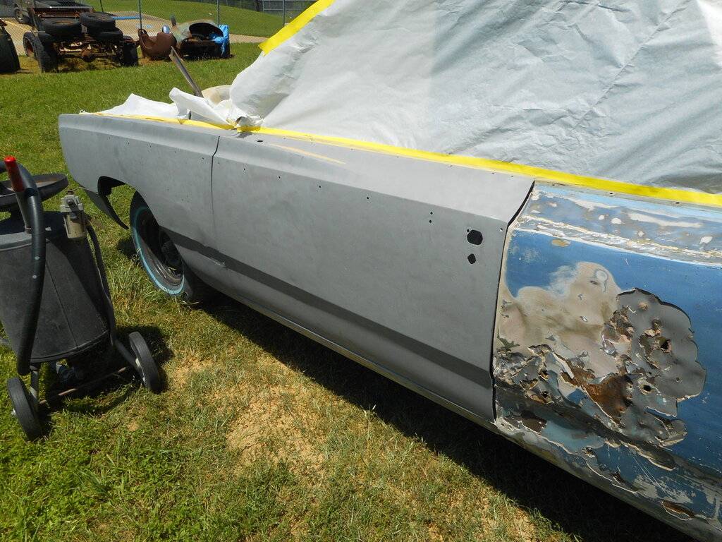

I am restoring a 67 Plymouth Fury III convertible. I have the engine annd drive train 100% restored and shining :) I have the body repaired, sanded and primed... with one exception. The drivers side 1/4 panel is beyond repair. I have searched high and low with no luck. Can anyone tell me what I do if I come to a point where I simply cannot find the correct body part? what is the proverbial last case scenario?

Your ambition and fortitude to do this car right is quite nice to hear. I'm sure all of us wish you luck, and maybe we'll keep our eyes out for the quarter you need. You KNOW it's out there somewhere.
For that matter, can a non-vertible quarter be sectioned in?

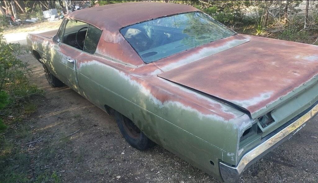

I am in the middle of acquiring a 67 Fury III coupe. I may part it out.
This one:
1967 1968 Fury 3 car has salvage title
PM me.

The outer skin on the rear quarter is the same for a 2 door or a vert if you splice it at the trim line at the door handle. You might also be able to splice the damaged area by cutting the door skin off of a 4 dr.

Start by getting all that mud off. Can’t truelly see what has to be done that quarter. Looks like a lot of shrinking of the metal is needed. Very time consuming process but well worth the effort.
Have you contacted Wildcat Mopars in Oregon? Check with ACME - fmmpar on eBay - he has an expensive right side. You never know. You may be able to use a partial quarter panel. Maybe someone cut off the back off or lower quarter panel but left the forward part.
