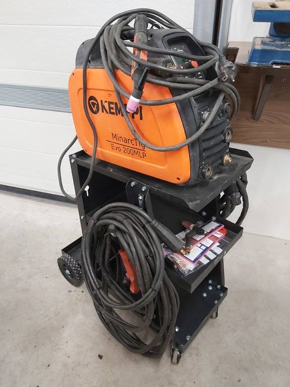

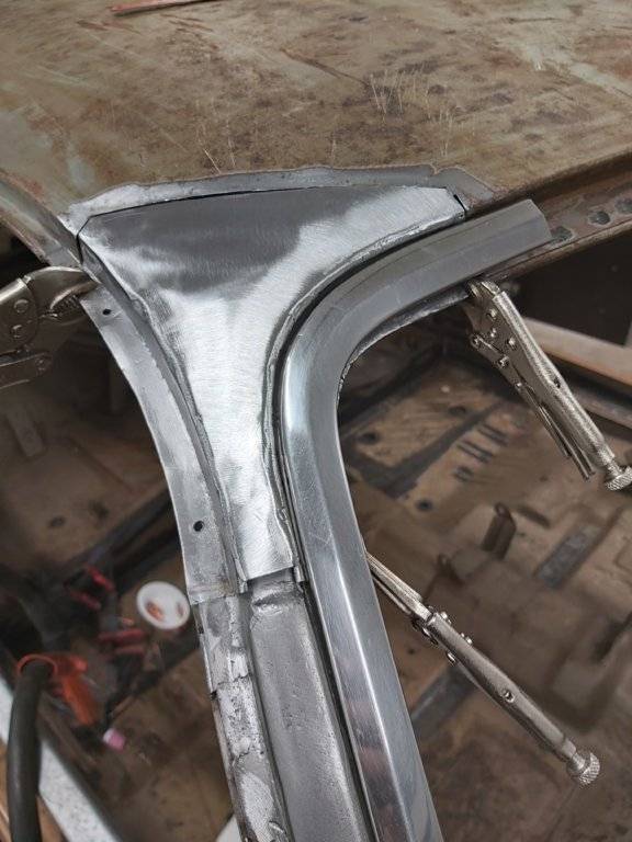

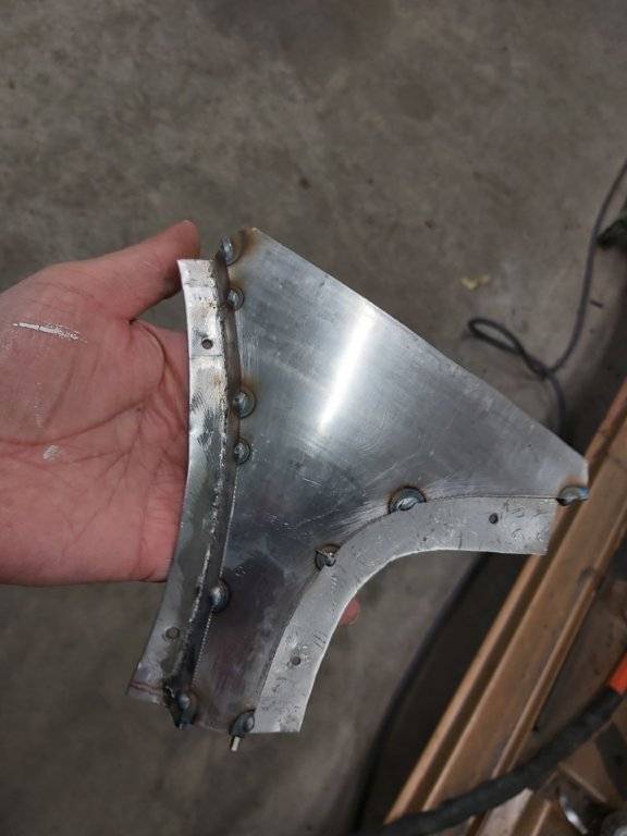

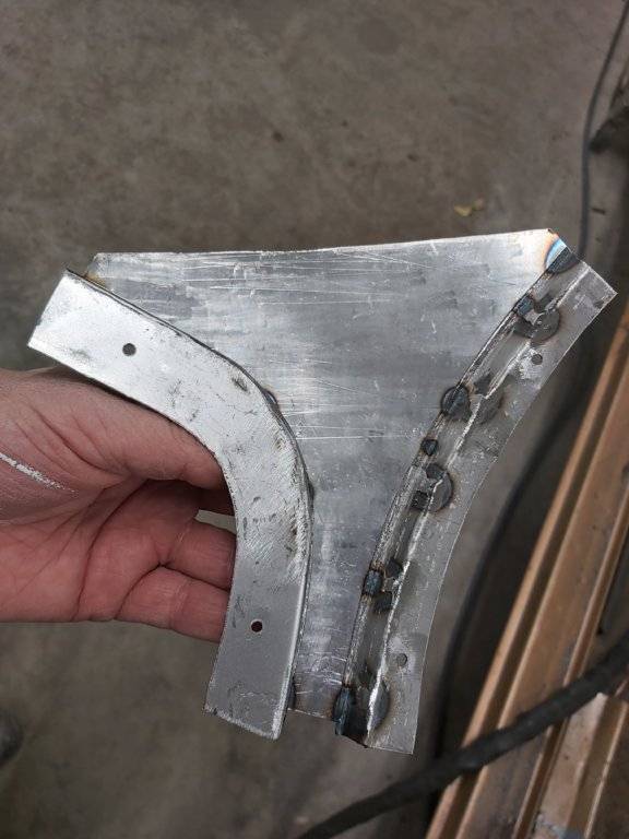

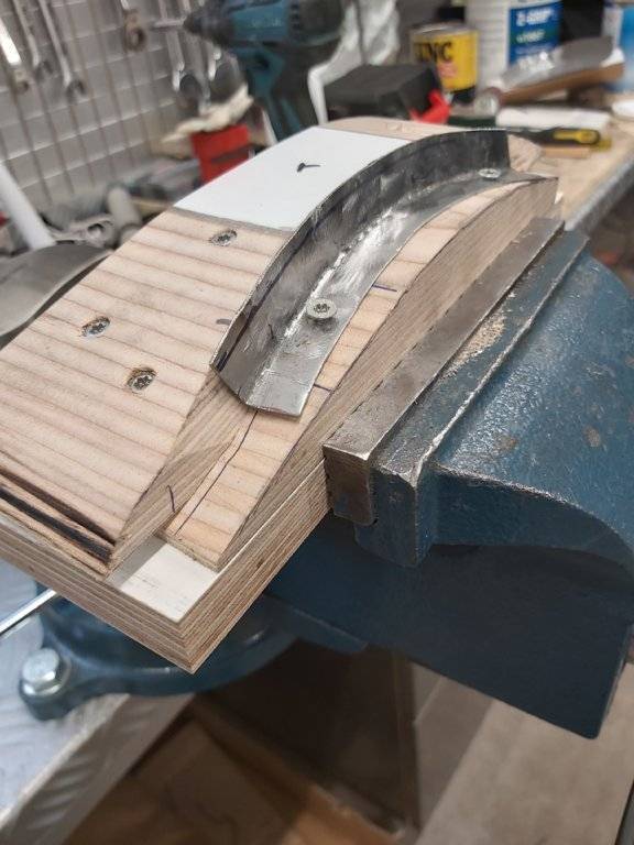

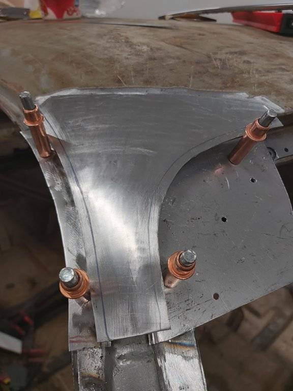

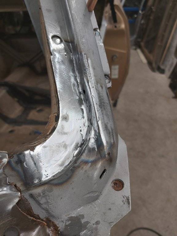

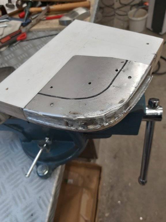

...I do my best! And I'm learning every day more! Finally starting body work on Baron. I already had very VERY old mig welding machine but it still working ok and now I also have a tig welder beside that. What I can say about tig welding...I need practice, a lot! Some pictures of progress..

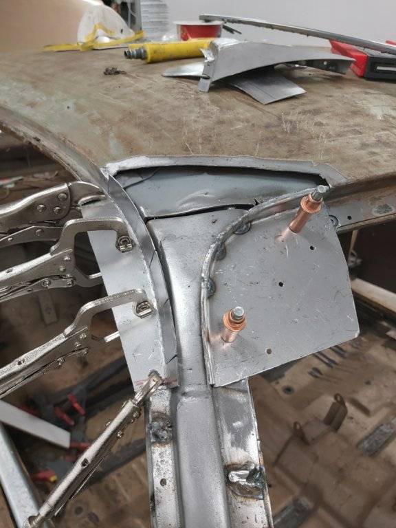

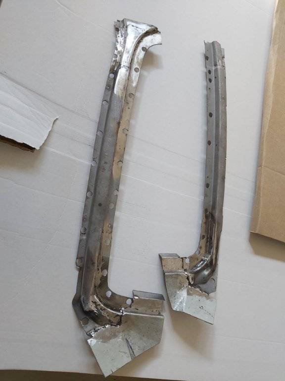

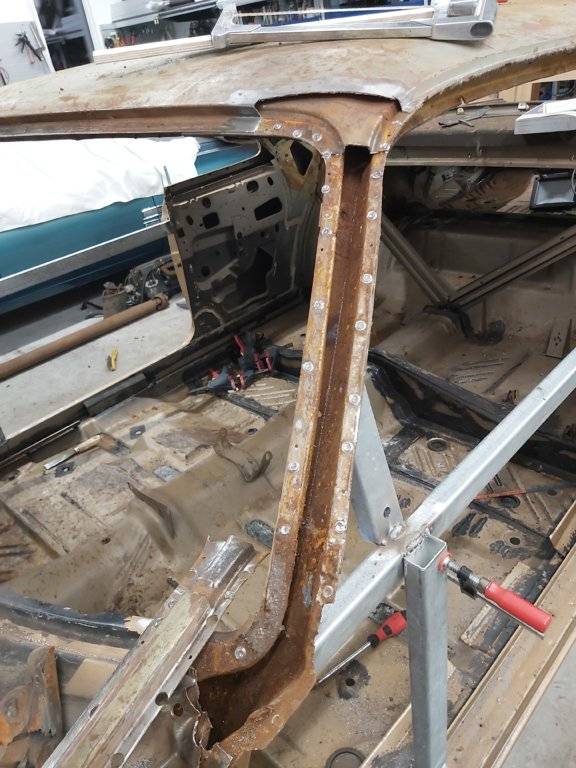

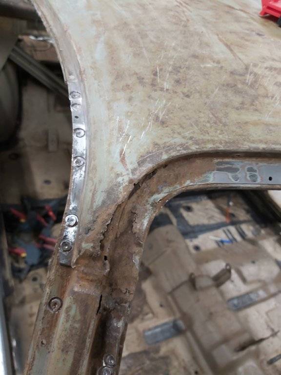

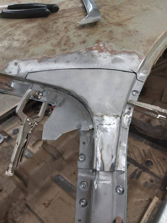

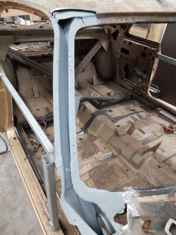

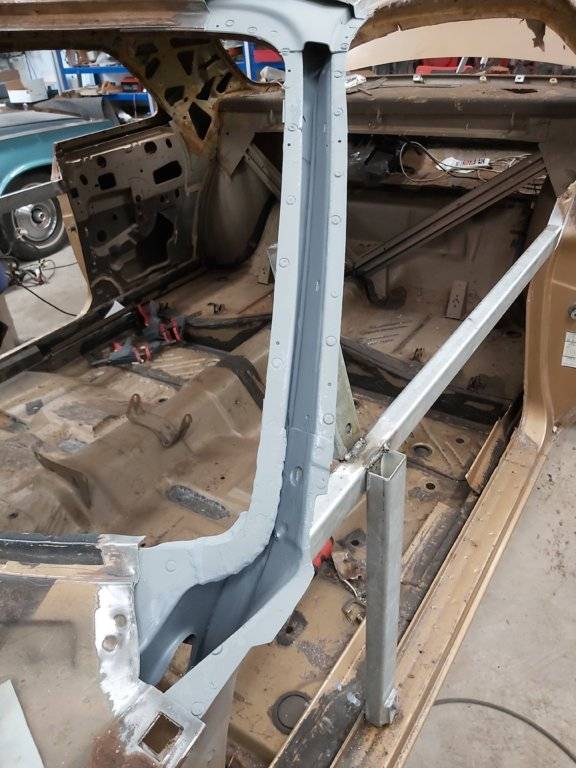

Right side ready for welding, first some sandblasting and zinc paint for back side. Windshield molding fits somehow alright, maybe little bondo here and there for perfect fit.
