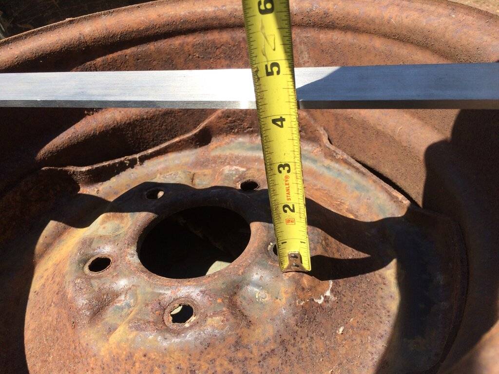

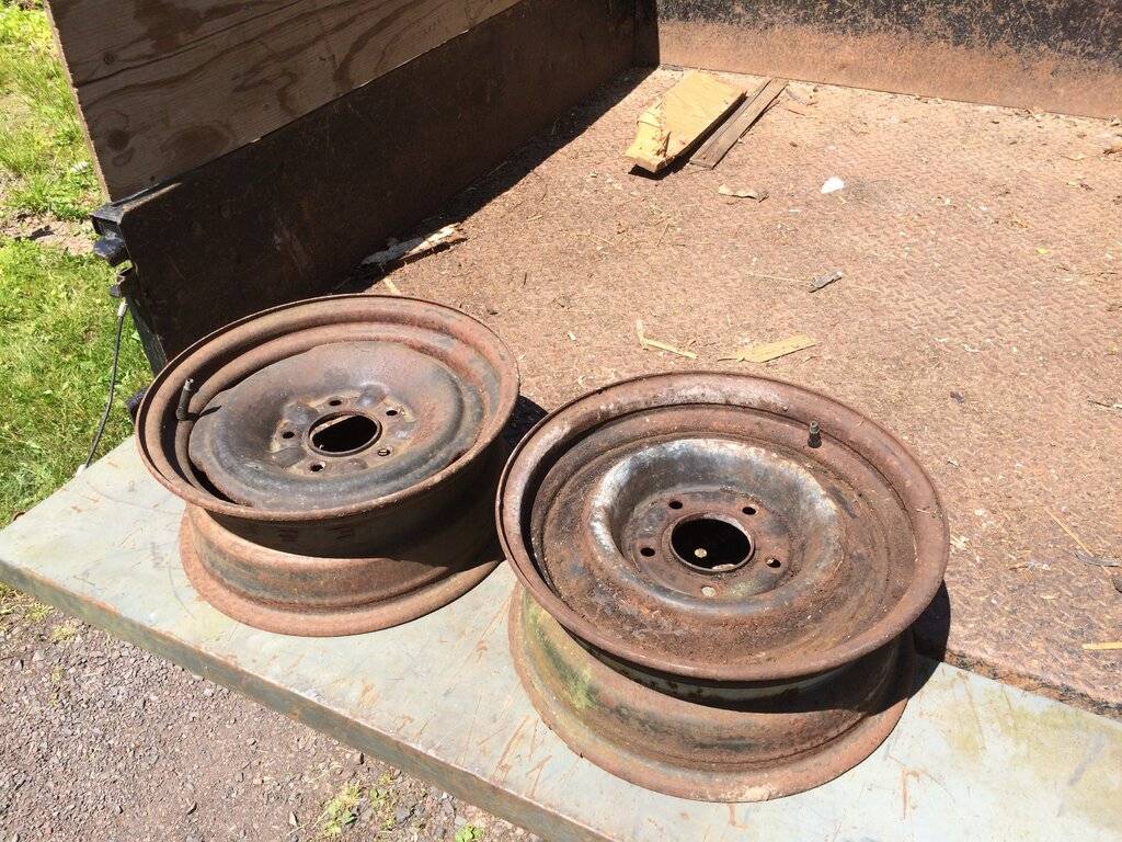

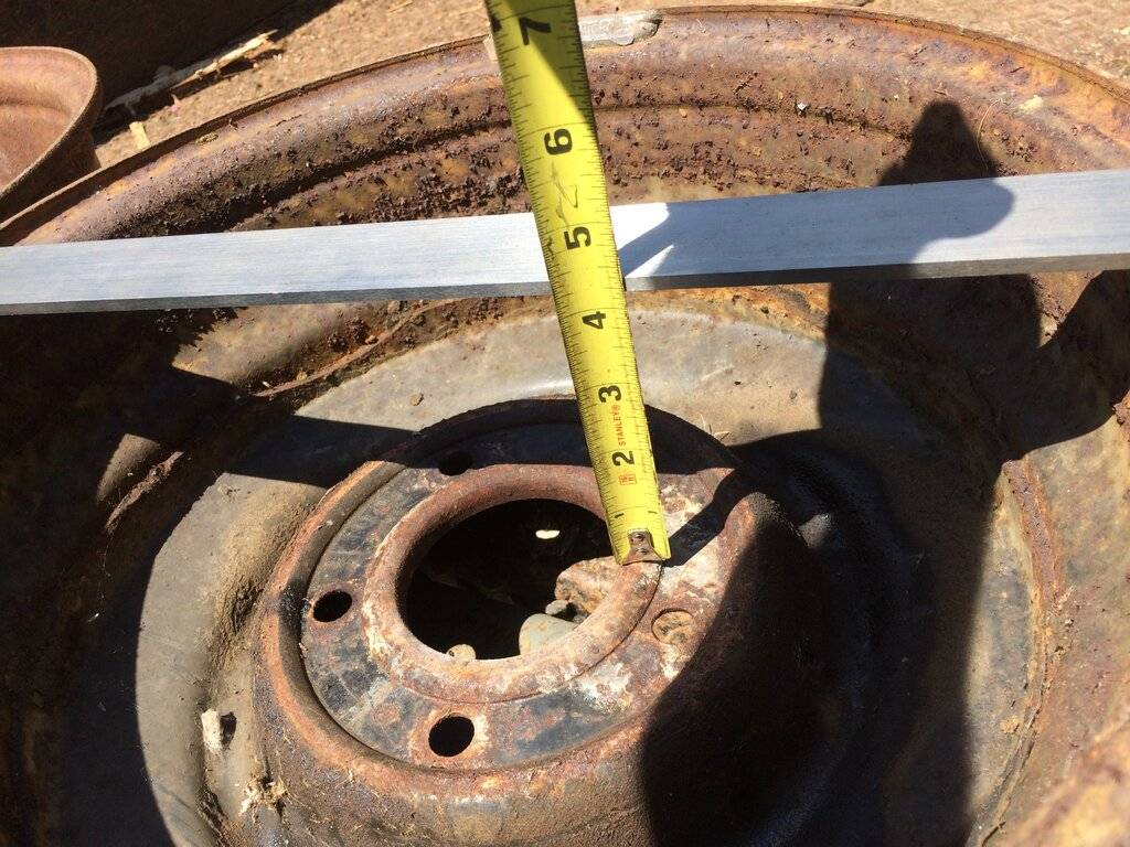

Although the '70-'73 wheel looks deeper on the front side, it's an optical illusion. Backspacing between the two is within an 1/8 of an inch.
'67-'69 on left. "70-'73 on right.
'67-'69
'70-'73

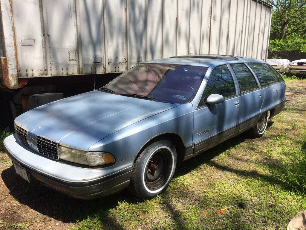

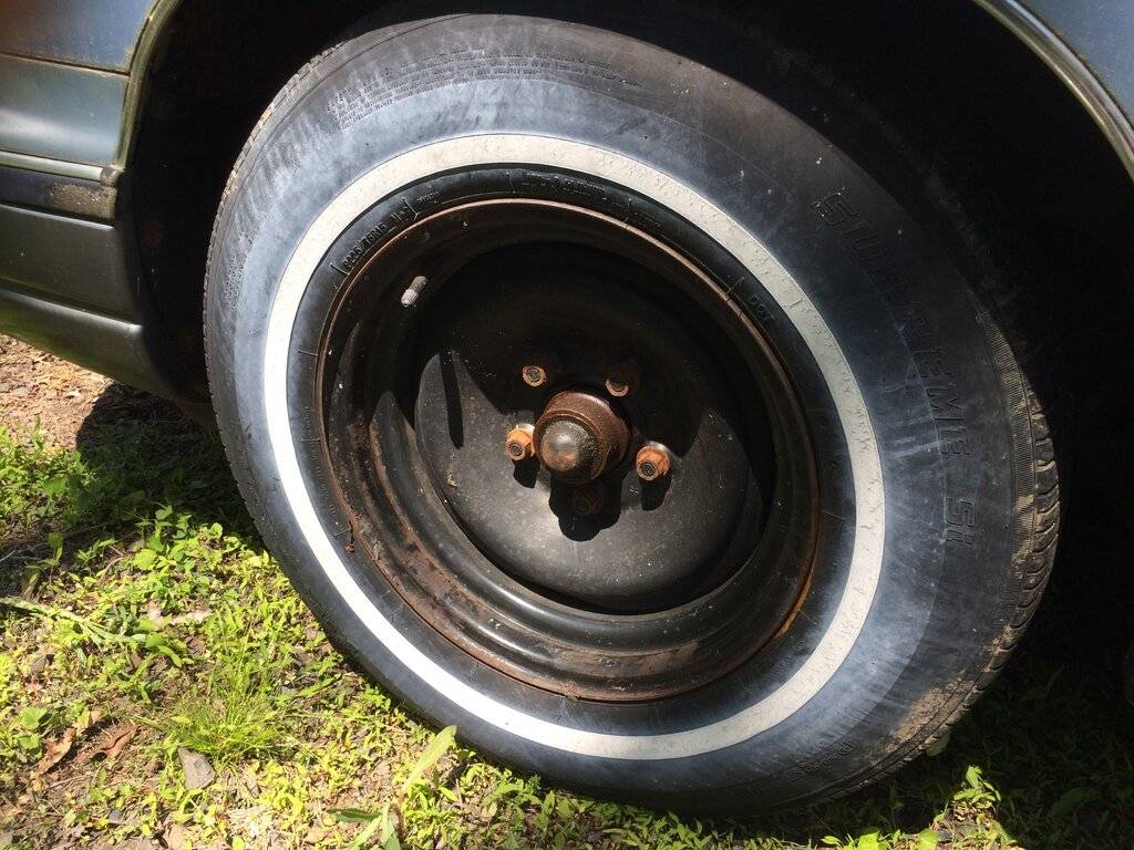

Anyone wanting to upgrade an Imperial to 7 inch wide wheels can grab a set off a '91-'96 GM full size wagon or Roadmaster sedan. The wheel design is very similar to the '67-'69 Imperial.
