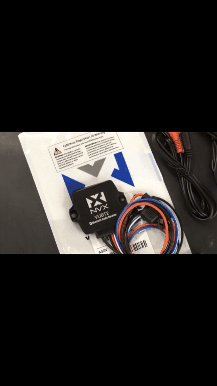

I want to keep my stock radio in my car but would like to have it Bluetooth capable. Prior to restoration, I had installed an AM/FM digital radio and paired it with an amplifier and 12 disc CD player (1990's technology). I would now like to reinstall my stock radio, leave the CD player out, maybe use an amp. and use Bluetooth from my phone; simple, or so I thought, question. Can I get get a Bluetooth receiver like the NVX VUBT2 Universal Bluetooth as a plug and play or do I need to install additional equipment to achieve my purpose which might included a hidden stand alone system. Looked around the internet for answers but it makes my head hurt. I am old and like the KISS approach. Thanks.

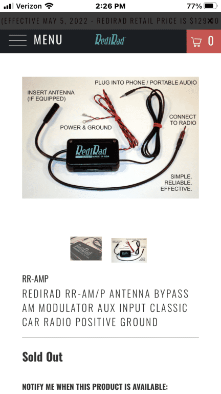

I am hoping I found the solution while retaining my stock AM radio. It requires a two unit assembly of which the parts were hard to find; sold out but sometimes it’s the hunt and they are on their way.
I plan to install a RediRad AM Adapter into the stock radio via the antenna lead which is suppose to convert the iPhone, MP3 player, etc. to an AM signal. Ahead of the RediRad AM Adapter, I have purchased a unit identified as NVX VUBT2 which plugs into the RediRad. This units function is to recieve the signal from the iPhone, etc. and transfer it to to the RediRad which then, again transfers it to the radio. With the signal coming in originally as stereo, I may have to take the signal from stereo to mono but if it is necessary, the thought is to use the RCA plug going from 1 to 2 and reverse it and go from 2 to 1.
The part that still dad me confused is how to have a front and rear speaker off the radio when it only has one speaker wire coming out of the radio; worse case, both front and rear wired together with no front and rear option.
