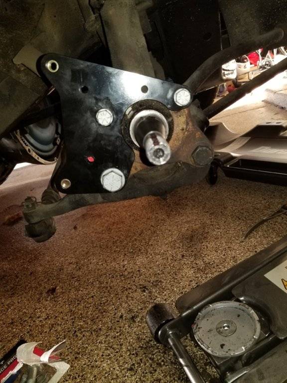

Or another thing you can try, Jacking up like you are sometimes the weight of the car works against you. You are jacking the right front, try putting some blocks under the left rear bumper and then jacking. If that doesn't work, you will have to back off the Torsion bar. You DO NOT want a jack under the arm if you have to back it off, BUT PLEASE put a stand under the car so it does not fall on you.
