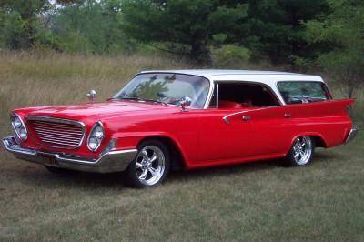

Somewhere on the engine will be the casting date - there's the same number on both sides of the engine, so try the other side to see if you can come up with the casting date - it should look very similar in location to the pic of the red motor in one of my previous posts.
