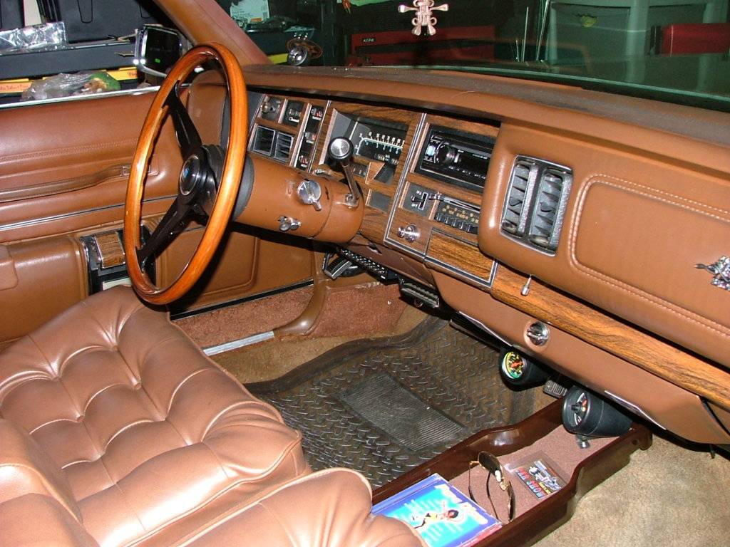

I don´t remember the brand, but one makes adapters to get aftermarket steering wheels to fit to a tilt/tele column.
I've searched the world....there isn't a kit for a T&T conversion.
However, I did machine/mod a leather wrapped steering wheel from a 77 Daytona that worked wel I'm with my 78 T&T.
Agreed that the wood wheel looks good in the brown interior, the part I can't get over is the spokes and hub. Looks like a 68 MG.
Nardi is world renowned.The wheel itself matches the dash trim very well.You really only need the modify,somehow,the center and black spokes.You need a chrysler motif of some kind in the center,maybe glue vinyl onto the black areas?But it,s not a deal killer because the circumference of the wheel is good.I,ve seen much worse,small diameter wheels and so forth.The wood on the wheel does look great.My dads Jag E-Type had wood.And leather.And shitty Lucas switches.heh.B.B

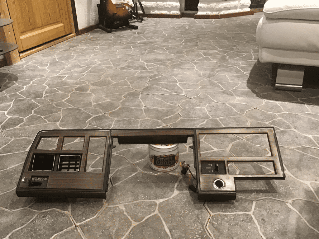

-Cleaning up the dashboard

also included picture of my dash ;)
Hope this helps.
Regards...
I like your wheel a bunch, but I hope to never see another done. Some things I can only accept once.
Hell no. Every and any aftermarket steering wheel looks like **** in Formals.

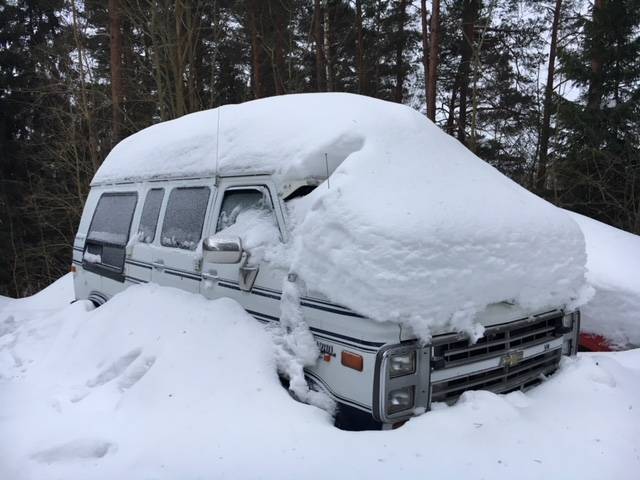

Summer 2019 is coming and snow melts. What you can find under the snow?
Here she is, my New Yor...oh ****...this is my old Chevy Van. Where is my New Yorker? I swear that I left her here.
In fact, she has been in a warm garage whole winter.
Most of the work has already been done, I have bought a lot of parts from Rockauto... :lol:

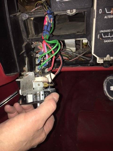

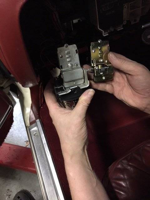

The ignition lock and light switch have been replaced.

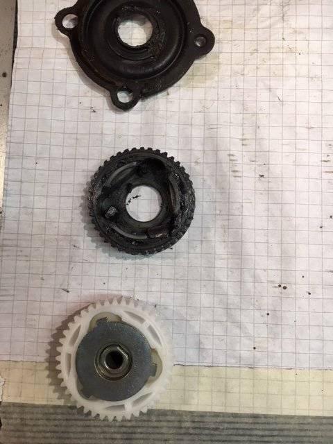

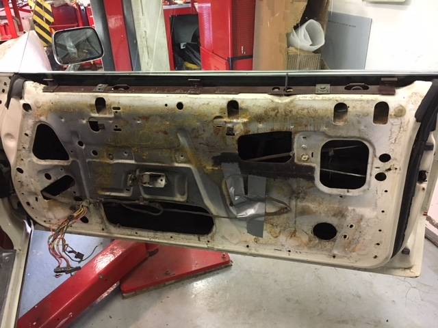

I changed a new gear kit to passenger side window.

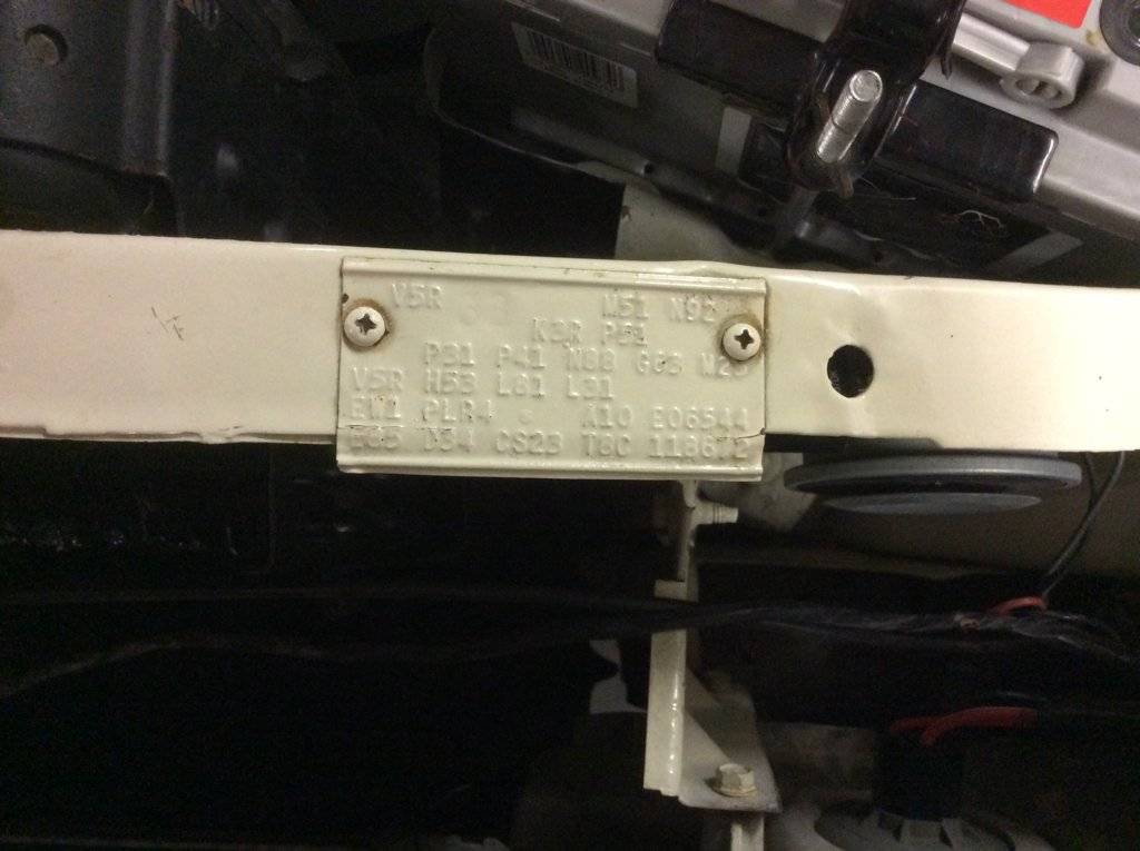

The E at the end of the second line from the bottom, indicates an EXPORT Special Order Number. I've seen a couple of other '78 fender tags that had the E at the start, without the stand-alone U, C, or I for the Specifications (USA, CDN, or International), and those were both Export cars with metric speedometers, like your car.

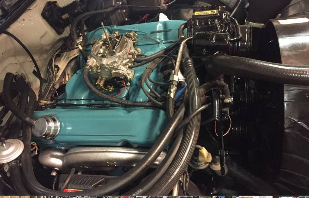

Cruising season 2019 is almost over, but let's go back to last winter/spring. In spring we focused on interior and the engine bay.

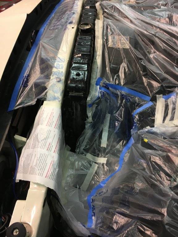

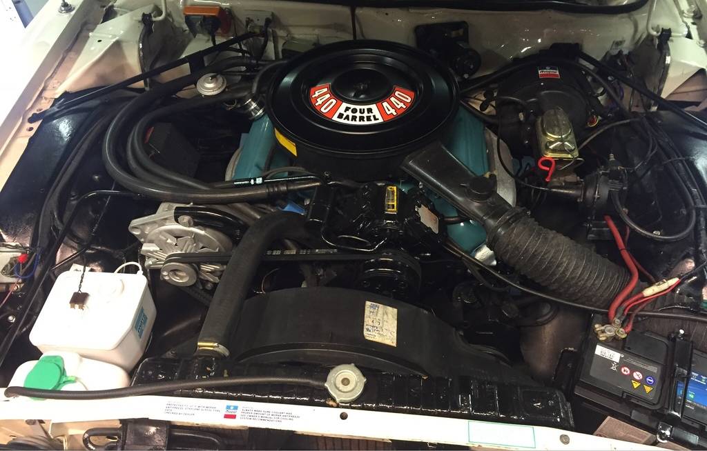

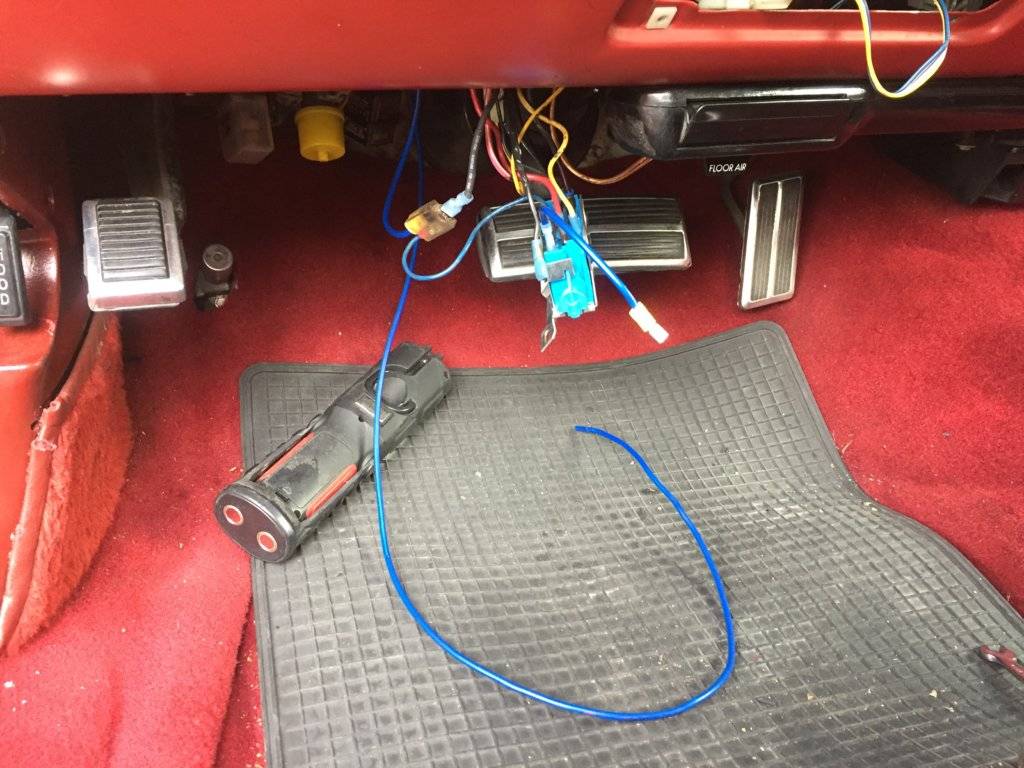

The earlier problem with the old ignition lock and blue wire caused a leak from the battery, so we cleaned, sandblasted and painted the area around the battery.

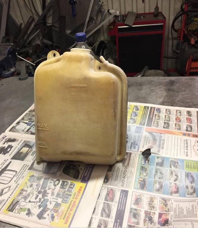

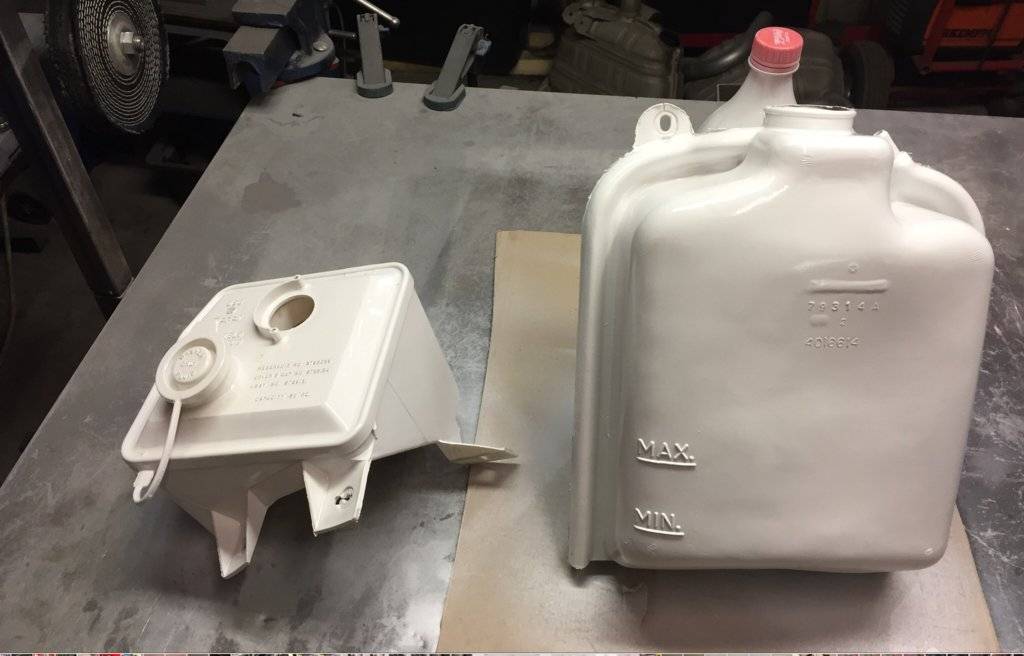

I tried to clean old reservoirs, but the result wasn't good, so i decided to try to paint them. Priming and painting, good enough for me. If someone has new ones, you can offer.

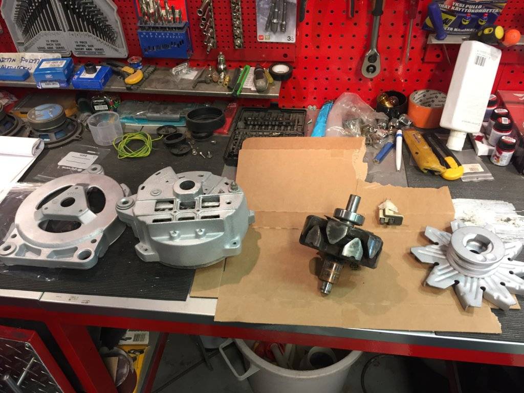

The alternator got new bearings, brushes and paint.
Valve cover gaskets leaked a little bit and in addition of replacing the seals, we also painted the valve covers. The situation escalated and we also painted a/c compressor, water pump, inner fenders, exhaust- and intake manifolds etc. We also sorted out the wiring harness and wrapped the wirings with a new wiring tape.

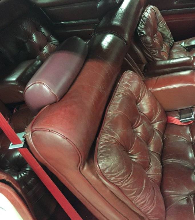

Despite the use of conditioner the seats looked surprisingly faded and we decided to try out dyeing. Results were surprising and the colour has stayed on the seats.

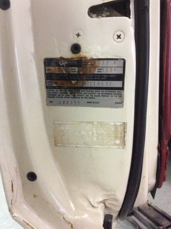

Here is picture of fender tag:
And here is production sticker, is that lower sign of emission decal or where it could be?
I have been looking for Build sheet, I have been looking for it under rear seat.
As @Ross Wooldridge bet, it look like this:

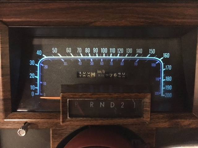

Although the odometer is showing, it is not clear what the first digit is. So how many miles or kilometers are on your car?
