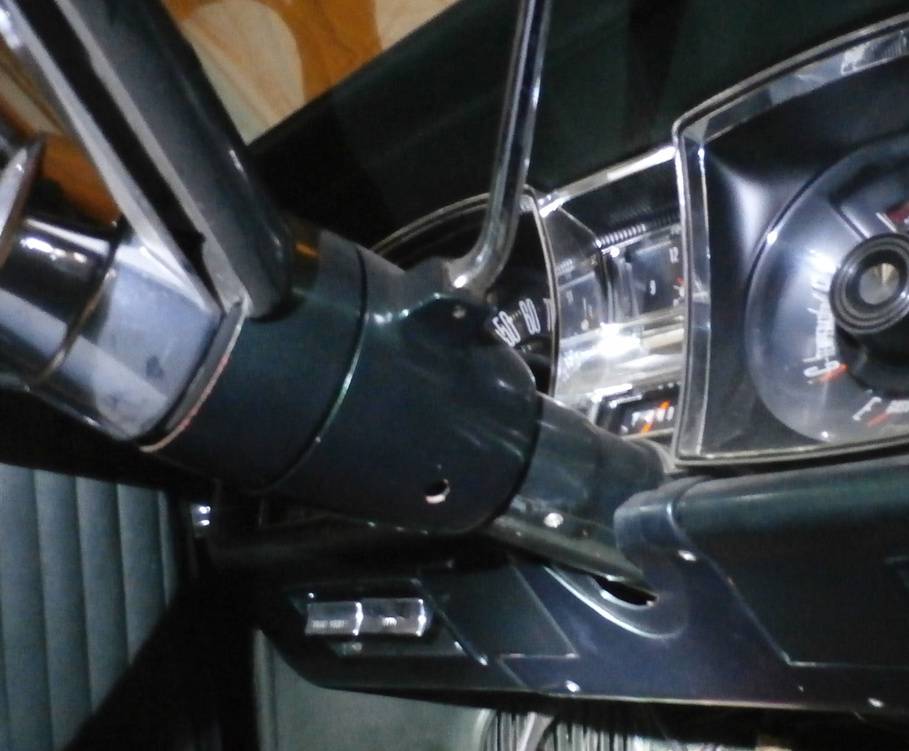

Ok, the weather's nice (but we'll pay for it, we always do). I've gone into the car one last time until spring, took a few photos.
This is with the glovebox door up. I see where my paint job ends and the original paint begins. I didn't take the dashboard out when I painted it. And yes, I can feel the texture of that flat paint. The new paint looks darker in this photo, but the angle is wrong except for the curved front, the color is a good match.
But I do like the glossy look better. If I had to do it all over again, and I had the dash out and all prep'd, and I had the flat textured paint in one hand and the glossy paint in the other, I honestly don't know what I'd do. Be true to the original, or kick it up a notch?
Hmmm. The cover trim looks like it's a different color. I wonder if it was plastic. I wonder how the tilt column will change the position of the steering wheel. The housing on that tilt column looks pretty long. But I see there's a couple of inches of space where the housing could extend backwards towards the dash.
I've taken the ashtray out, it's been painted so it will make a good sample when I bring it to a shop to get a color scan.
I will paint the tilt column with a matching gloss-green, but I will put it on my list to obtain the correct textured paint - for some future restoration job down the road...

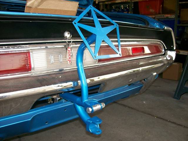

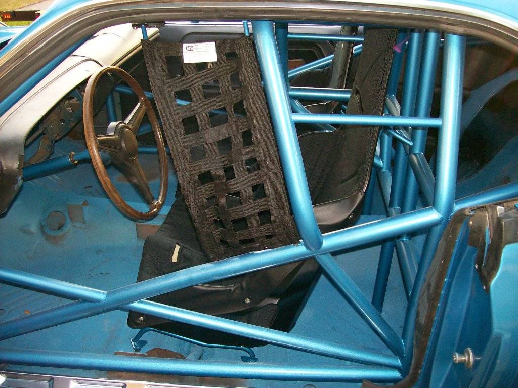

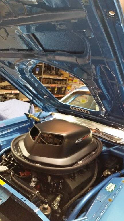

I was painting the door surrounds and engine area (71 Challenger, engine out and doors off) just today with B5 blue mixed at a local auto paint supplier. Cost was about $30 a can for matching spray paint. Returning the car to B5 from POs Plum Crazy.
I had a local paint supplier mix up my B5 in cans also to paint my roll cage, engine bay, hood and other parts also.
