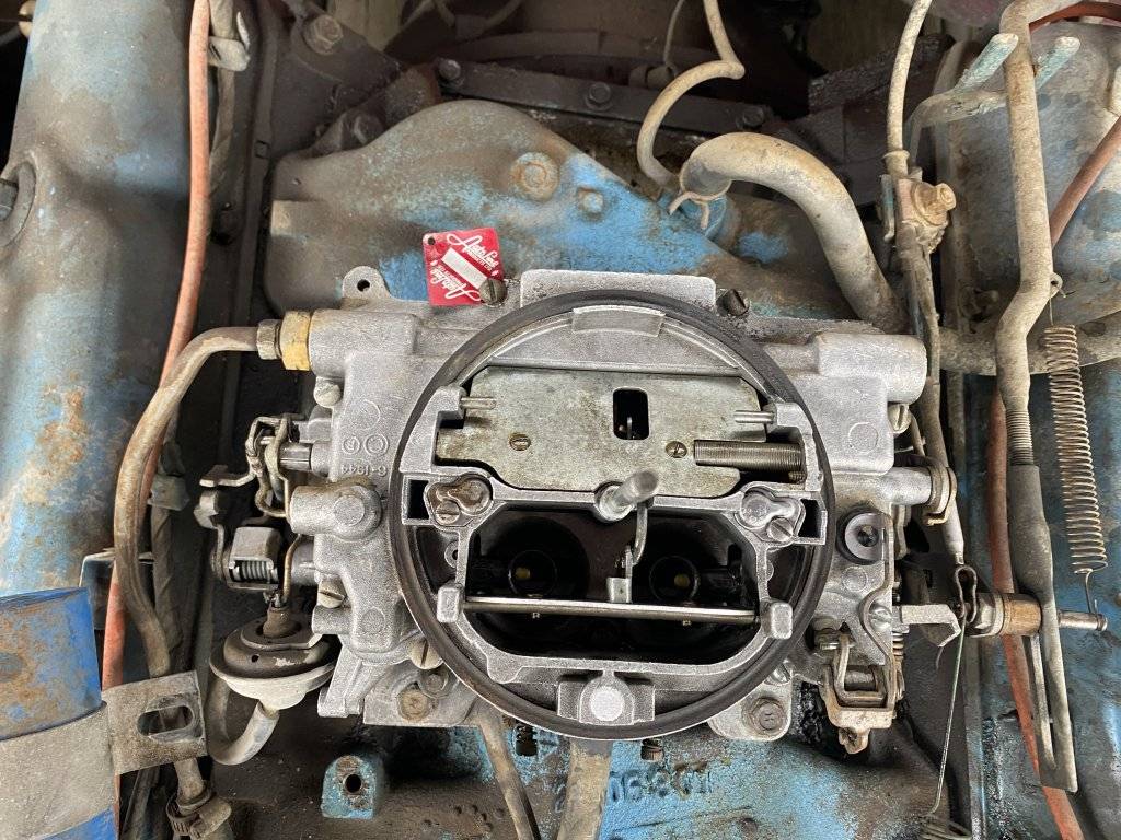

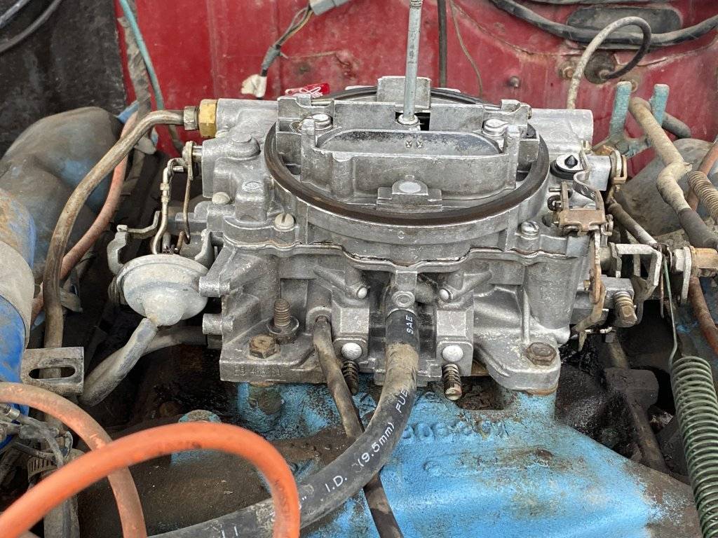

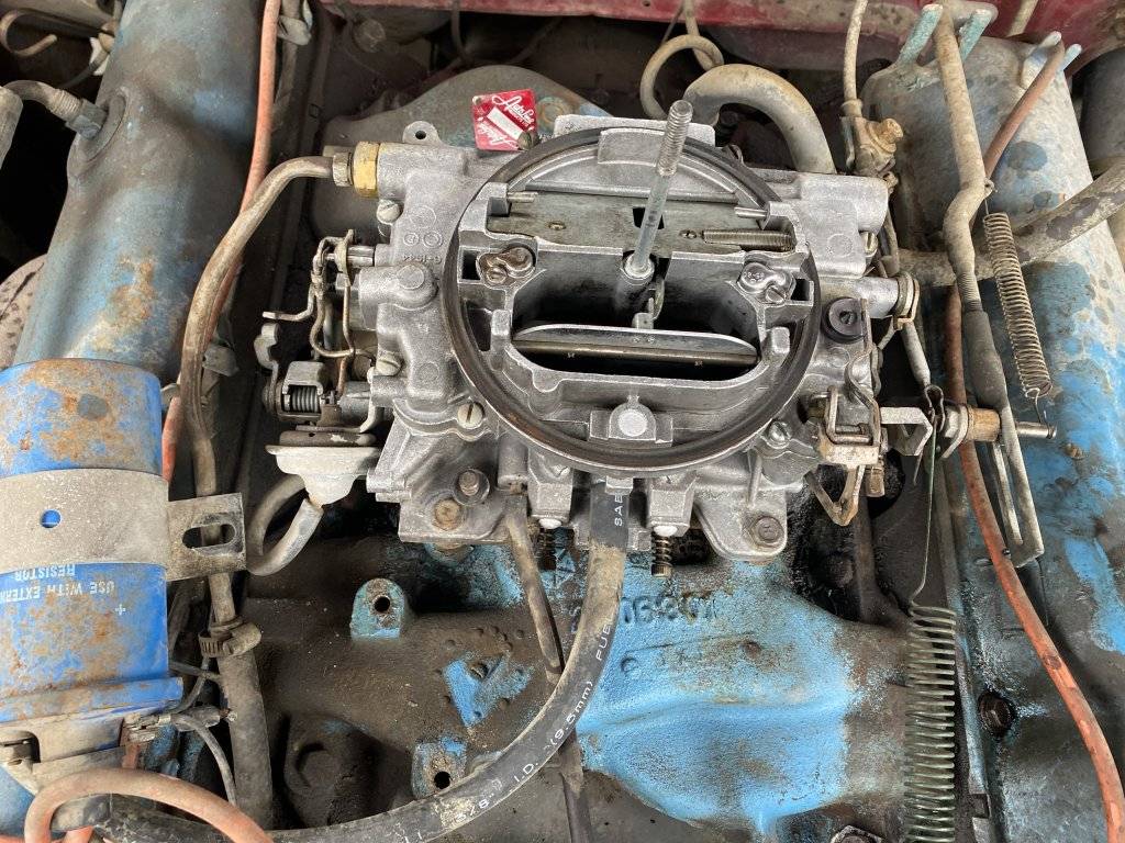

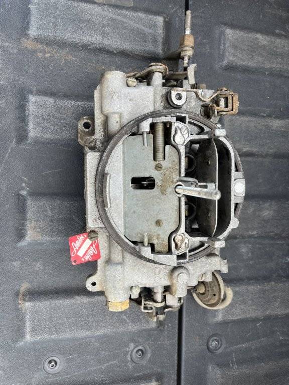

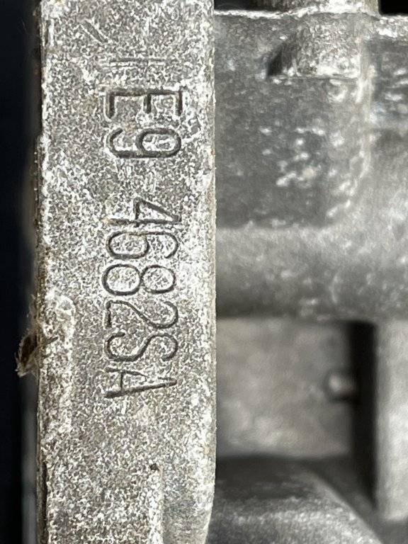

Original Carb for a 1969 Sport Fury 383 HP is a Carter AVS 4682SA
Cool Thanks for the pics .... This car now has a Holley 4160 but odd enough the numbers on the choke housing referenced a Plymouth or so I thought, I'll need to do more looking after I get it sorted out and insured .... And also RockAuto had both carb kits so I obviously ordered the Holley kit... But if given the choice I'd go original equipment since the car has not been hacked to much.

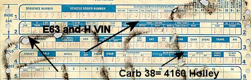

69 C body 383-4bbl with A/C is engine assembly 903 with CARB 38 = 4160 Holley
There is no such thing as ANY 1969 383-4bbl with a/c being an HP assembly. They will all be 330 horse whether they are in a B or C body.
Only A, B and E bodies got the 68-70 383-4 335 horse HP assemblies. C bodies got either 2 or 4bbl (330 horse) assembly.
