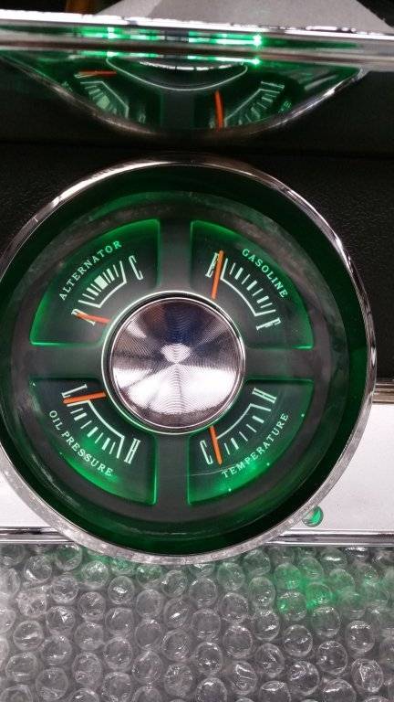

At the risk of being branded a heretic by the C body faithful, I present a couple of picture showing the LED bulbs I installed in my dash:
The camera makes them appear brighter than they actually are.

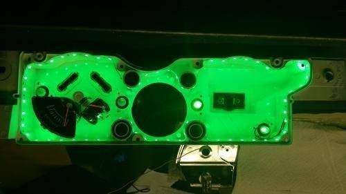

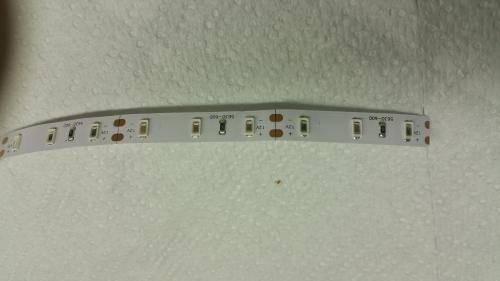

I went with 12V 5630 LED flexable light strip and installed it around the perimeter of my gage housing. Its bright and dimmable. In the pix i'm using a 9v battery to test it. Very inexpensive too. Evilbay $7 shipped for a 5 meter roll, about 15 feet.

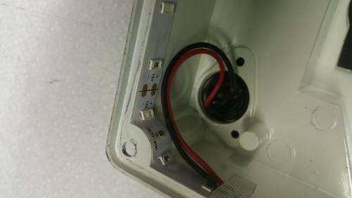

I only used about 4 feet. I tried the led bulbs. Only 4 places to plug them in, had lots of dim spots on the gages so i had to Tim Taylor it. The nice thing is because of the amount of light they put out, if 1 or even several LEDs on the strip go out you will likely never notice a dim spot.
It also comes in lots of different colors. Bright white, antique white, blue, red, green, purple, orange, also can get with tricolor leds and a controller to change through a full color spectrum and pick exactly what color you want.

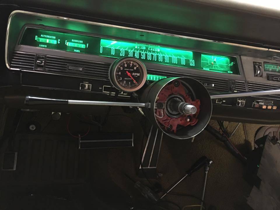

My entire car is lit using LED's including tail lights, backups, brake, dash and turn signals. Way brighter than OE and the only change you'll have to make is install an electronic flasher in place of the original. Just plugs in.
Dont forget, if they dont light, turn them 180° in the socket and reinstall. LEDs are polarity sensitive. If not negative grounded they will not light. Its prob best to use a 9v battery and some alligator clipped test leads. Run neg batt term to cluster housing ground, positive batt term to cluster back lighting pin, and install the leds. This way you can turn them and test to make sure they are lighting up before putting the cluster back in the car.
