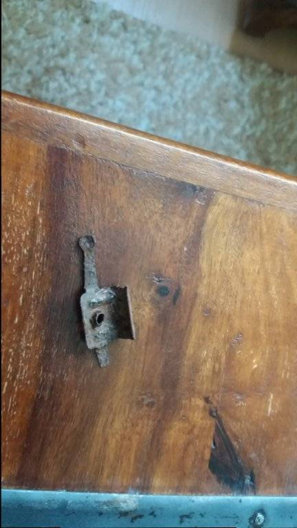

May 26, 2016 #1 furyfinn Senior Member Joined Jan 17, 2013 Messages 1,008 Reaction score 618 Location Finland Sorry for a bad pic, hope you can make something out of it: And yes, it's a bit broken. A hint: It came out of my convertible...
May 26, 2016 #2 Big_John Illegitimi non carborundum FCBO Gold Member Joined May 21, 2013 Messages 20,605 Reaction score 30,482 Location Marcellus, NY Holds the rear trim around the back of the top on the dutchman panel. If you have any extras or know a source, let me know.
May 26, 2016 #3 furyfinn Senior Member Joined Jan 17, 2013 Messages 1,008 Reaction score 618 Location Finland That was fast, Big John! It seems we share the problem here... I was hoping someone would step up and say: Hey, I have a bunch of those! Well, someone still might do that.
May 26, 2016 #4 Big_John Illegitimi non carborundum FCBO Gold Member Joined May 21, 2013 Messages 20,605 Reaction score 30,482 Location Marcellus, NY Yep, I haven't found a source for them, new or used. I tapped them a size larger and replaced the screws with some button head allen screws and have just enough to hold the trim on.
May 29, 2016 #5 furyfinn Senior Member Joined Jan 17, 2013 Messages 1,008 Reaction score 618 Location Finland Thanks, your pics are much better than mine was! I too have enough to keep the trim in control, but could use some more...
