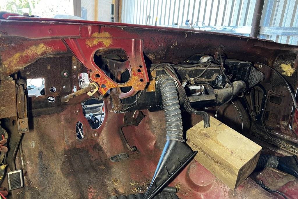

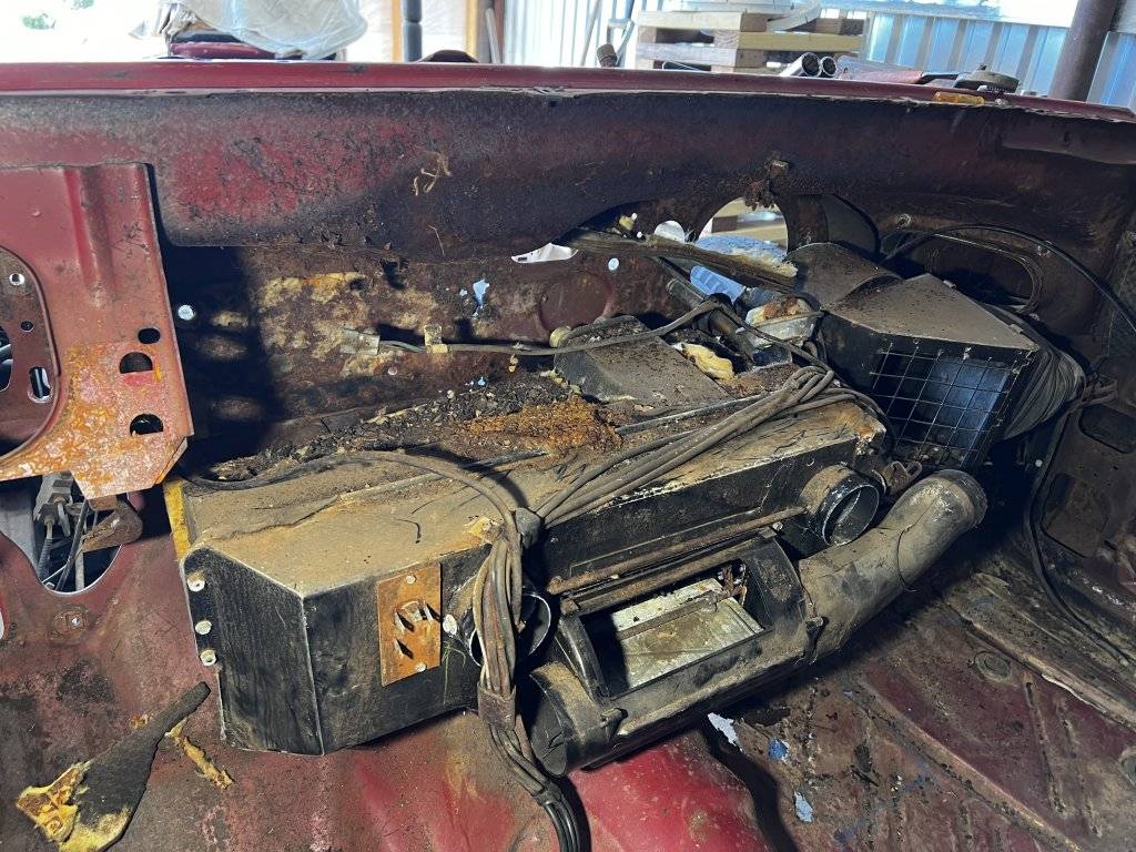

For one thing, even removing the box was a pain, because even while removing the entire dashboard to access it, there’s still a few connections to the dash and I don’t have small hands to reach up there and disconnect them easily. Still got the job done lol.
This also is a reminder to how this “Solid southern CA car” really was (not!)

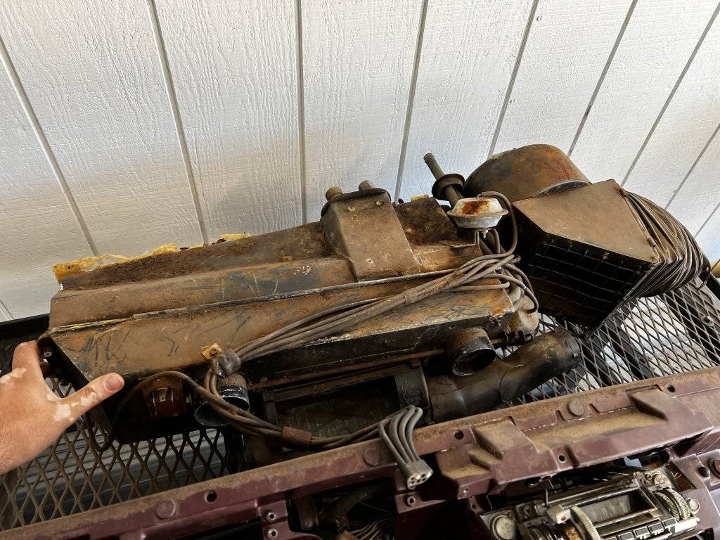

Just about everything on this box was absolute trash. Thankfully the evaporator core had been left hooked up / sealed from the elements, so it was still good. The heater core was replaced with a newer unit.

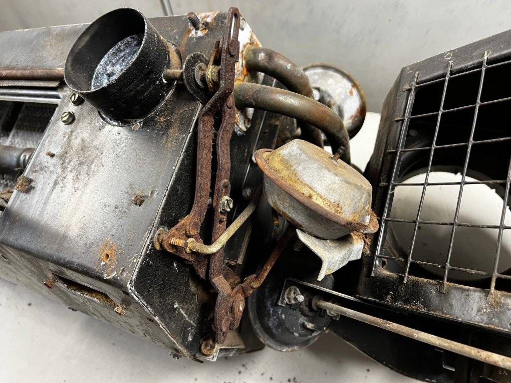

A new H Valve also! Would you believe the original linkage on my box that actuates the blend door was rusted almost completely away? It nearly disintegrated when I removed it…
I’m actually having trouble with that linkage binding up, so we are going to study that another time but definitely before it goes back into the car. I really, really don’t want to deal with it again

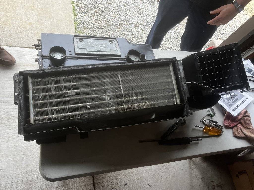

AC Evaporator after I had it cleaned / tested. I probably will never even hook the AC back up. At least not for many years. Going to look into a nice looking cap / plumbers fitting or whatever they have that I can use to block off the connections from the firewall.
