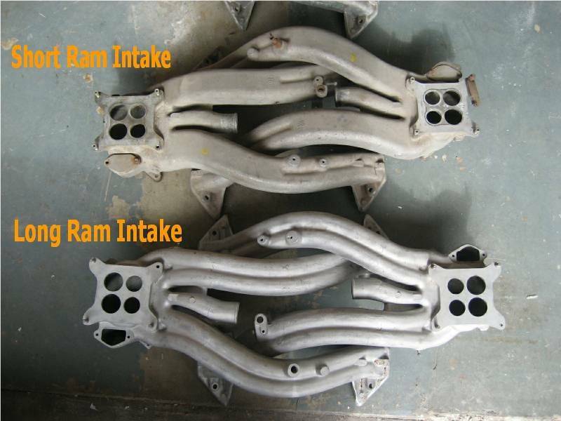

Measure the dividers near where they attach to the cylinder heads. Many cut the manifolds apart there and shortened the dividers, which should be obvious, I suspect.
Long rams are 2800
short rams are 3600.
The physical size is the same, dividers different
please post a photo or list casting numbers from manifolds.
Also check the choke pits, if they are rotted out, that makes the value a lot less.

Long rams are 2800
The above numbers are the RPM where they work, not a dollar value. Sorry for any confusion.

yes , one of the tricks was to mill out the passage wall from the under side and than weld up the gap in the outside tube . from the top view you look stock . bit the motor would rev high on the torque curve .
