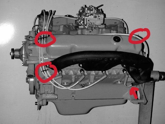

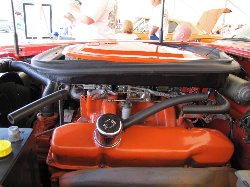

I always thought the #7 wire was supposed to go along the top of the valve cover then down the back and around?
I wondered about that myself.
Factory photos show both 3 in front abd 4 in front. I don't understand which was what. That's why im interested in Nick's project. Details like this.

To put it simply (and I'll be damned why anyone is having issues understanding this)
I want to know the External differences, Manifolds (Intake and Exhaust), Air cleaners are fairly well covered by Nicksgarage.com, But I would like to know what the manifolds ESPECIALLY exhaust manifolds should look like, just because some interweb site says its correct doesn't me squat, I want photos of all and to be able to decide according to factory part numbers from FSM's.
Nick
If I'm building a 1973 440 U code engine for a 1973 Fury Pursuit clone, I want the Damn engine to look like it came that way, I want to be able to if I so chose to take a so called expert, put a piece of tape over the VIN and Fender Tag, then pop the hood and ask him to tell me what doesn't belong.
If I'm doing it, I'm going to do it right, I'm a very anal person in some regards. I want to be able to leave my hood open at a show without overhearing anyone giving the usual hey look someone swapped this in, this is____, that is_____
Sorry to say Nick, but even if you had a complete original car that is totally unrestored and even had the original plugs, leads etc there will be those people who will tell you how this is wrong or that is wrong. In the end, do what you see as right and correct and be happy with it no matter what anyone else says. "Cos in the end, opinions are like a@#holes, everyone's got one.
You are correct.......but there are some exceptions. '68 &'69 B-body cars don't have that tab to hold the #7 plug wire.
Here are some original examples........
2011 Chryslers at Carlisle 039.jpg2011 Chryslers at Carlisle 220.jpgWM23M9A309948 061.jpg

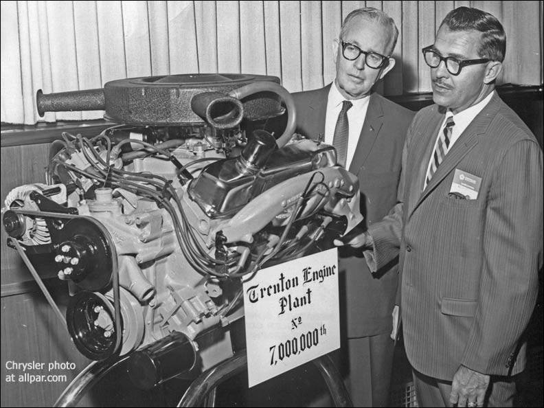

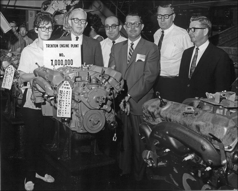

anyway, Trenton MI engine plant, May 21, 1968, celebrating 7 millionth engine. probably 1968 model year still in production, but at least we can see some visual details of what this plant was actually building.
http://www.allpar.com/corporate/factories/trenton-engine/7-million.html
View attachment 66471View attachment 66473

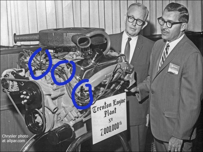

Those are not the same engines. The top appears to be a 67 B body 440 HP for an automatic - Chrome valve covers, plug routing, dual snorkel intake. The bottom 7,000,000 has painted valve covers
yeah, something funny going on maybe. different engines or different times?
the "suits" are wearing the same clothes in all the pics indicative of same day shots, but maybe when they finished the plant walkthrough and went to lunch or whatever, the 7 millionth display engine (air cleaner, accessory drive, pedestal, etc. added) was embellished it a bit for remaining shots that day and subsequent visits?
what caught my attention on the photo in the first place is the engines had HP manifolds indicative of the whatever the hot 440 code was in 1968 and it showed some fine external detail as visual cues.
I am insufficiently skilled to discern model year/application of the final display piece beyond the date of the pic and what SHOULD have been coming down the line in May 1968.
but the "suits" are wearing the same clothes in all the pics indicative of same day shots, but maybe when they finished the plant walkthrough and went to lunch or whatever, the 7 millionth display (air cleaner, accessory drive, pedestal added) engine was embellished it a bit for remaining shots that day and subsequent visits?
Unless 68 A body 383s came with chrome valve covers (I don't know...), the one appears to be a 67 B body assembly.

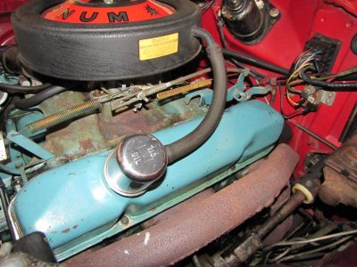

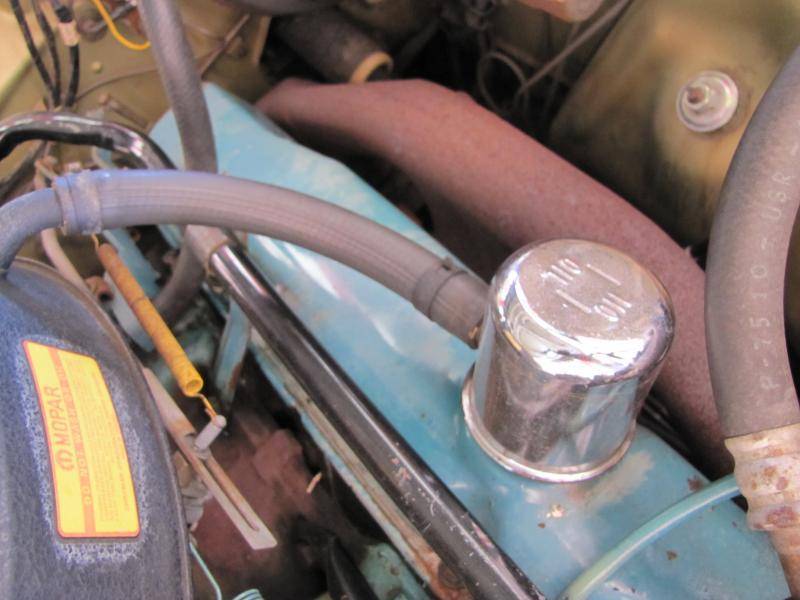

Don't forget the valve covers. Looks like they mixed and matched a gazillion combinations.
Spark wire clips, harness tabs, oil breathers, pcv valves, colors, etc.
Make your head spin.
