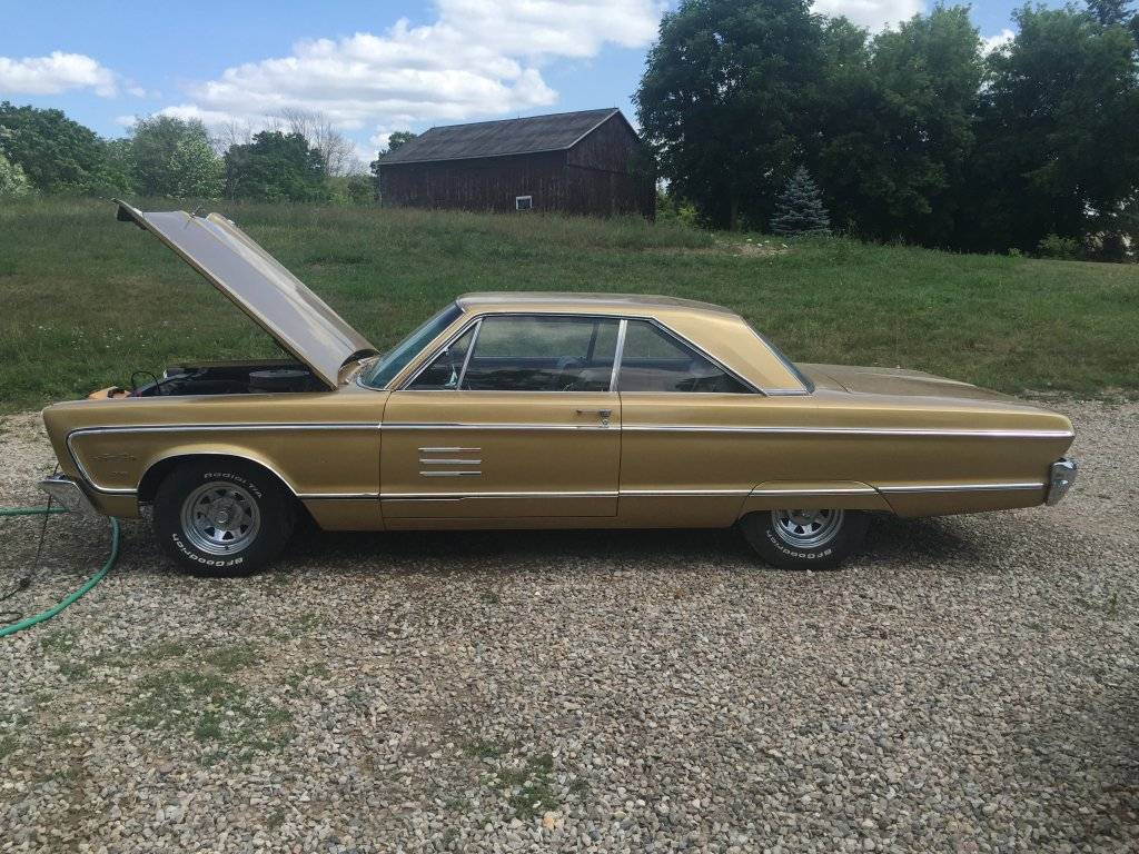

Hi everyone. I have a 1 owner 1966 sport fury 318 2bbl 2 door hardtop with only 68000 miles. This is a special car to me. The first owner was my Dad and he bought it new in 1966. His first new car. Almost everything is original except for the paint rims tires and wear parts like brakes. My mom said the only reason it was painted is because Dad waxed the paint off it. Now Dad told me he always kicked himself for not buying the 383 car right beside this one. I am wondering what I can do without wrecking the originality to add a few more horses? My Dad also had a 69 Hemi 4sp numbers matching yellow super Bee. I think he said 14 built that year. So I am a die hard Mopar man. He told me that the s fury (that's also the license plate) was a Windsor, ON build. I guess there were 2 different factories? Any advice from people more knowledgeable than me will be much appreciated.

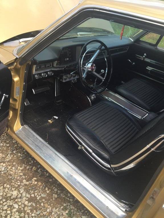

Also there are 2 Springs either side of the driver's seat that are trying to poke their way out. Suggestions?
Nice! Looks to be in wonderful shape, outstanding interior! I would just freshen everything up and drive the crap out of it! The color is quite different but looks to be well done. Lucky you to receive such an awesome gift from your dad. By any chance is the Super Bee relaxing in the barn, or? CG

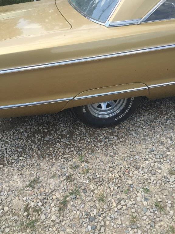

And I do drive the sh!+ out of her. 4 lane to the cottage about a 200 mile drive. Takes just over 2 hrs when I do it at night. I think he said 2.73 rear end. Correct me if that would be wrong. But it will bury the 110 mph speedo. Dad said he could keep the taillights of most hemi cars in sight at least. Lol. Did they sit more level when new? I have dropped the front tortion bars a couple times but it always look bum heavy.
