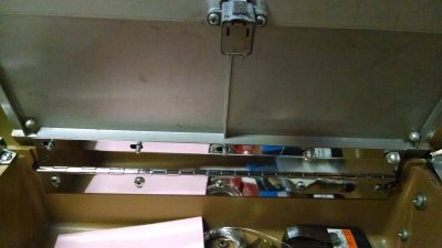

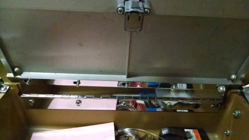

Wow, Mike. With so many shared parts between the '65 and '66, I'm surprised to see a change in the Console Lid Hinge and a poor design change at that! Below is a pic of my hinge. Note the (3) bolts on the Console end and the Lid end. Sorry I can't be of more help. Way more sturdy design.
Now that I look at your pic again, I see the big difference: mine opens front to rear while yours opens side to side.
I knew yours was different I have wished they had never changed it, plus yours is just cooler with the 300 badge on it, hint hint I forget exactly how it looks. :)

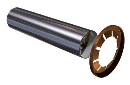

Instead of twist-on, how about push-on fasteners like these starloks?
These were common for door panel assemblies through later 90s and early 2000s... look at Grand Cherokees... there were lots of sizes on different cars/components. I'm not to sure after that...
They are very strong, usually just cut them off to save time when doing work so the dealer may have new ones in stock. Try Dorman for aftermarket replacements.
