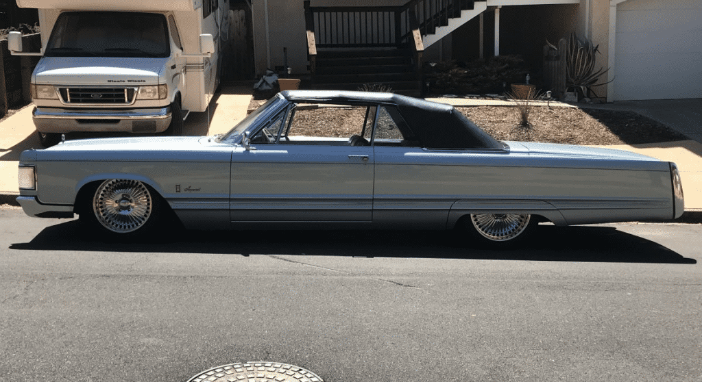

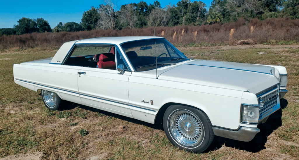

thread above is too big to go through easily, and their arent that many 67-68 Imps there with NON-OEM wheels/tires IF you're considering that direction.
but something 29 inches max in diameter, 8 inch rim width, maybe 9-10 inch section width, 4.0-4.5 inch backspacing .. I would guess .. is biggest NON-OEM wheel/tire combo you could fit WITHOUT modifying the car to create more clearance.
