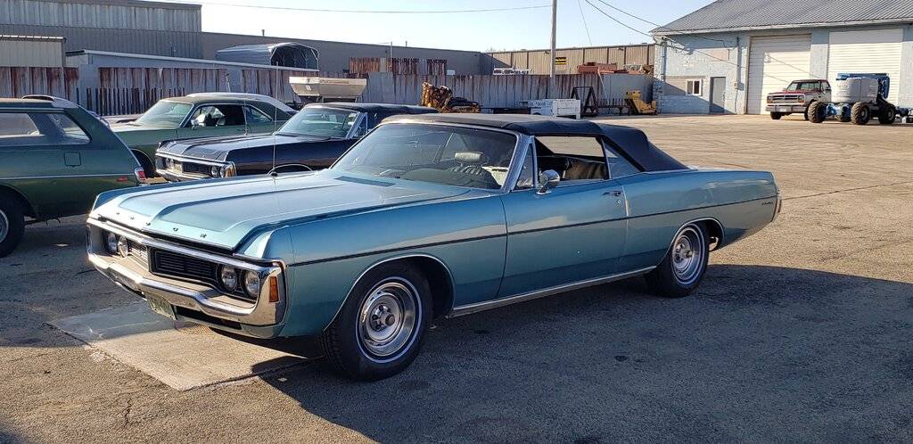

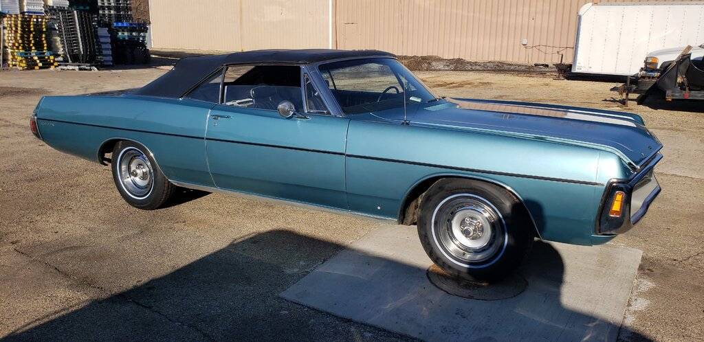

I acquired DL27L0D148841 from @Tobias74 earlier this month. This Polara convertible's scheduled build date was 51 years ago to the day: October 31, 1969. The color is my favorite, and I had yet to own a fusie C-body with a console, so I took the plunge and thus deviated (some more...) from my long-term goal of keeping ´only’ four fusies.

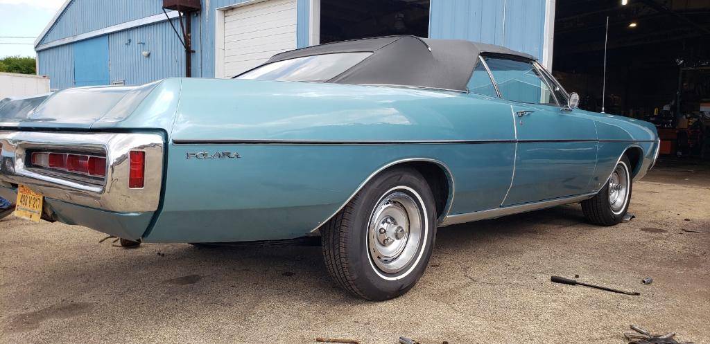

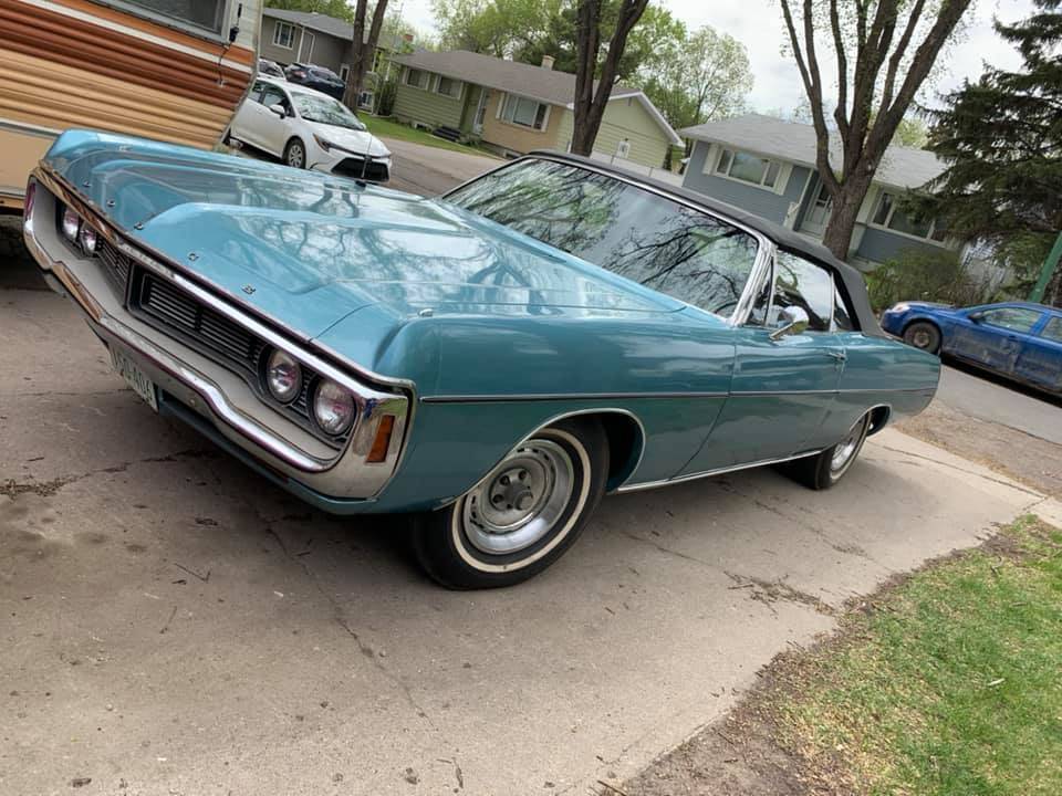

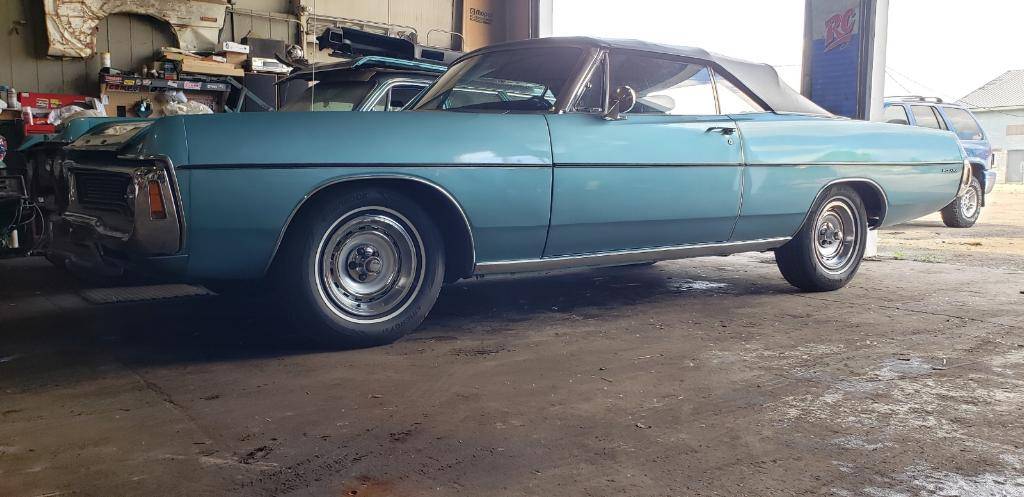

Tobias himself had scored this ragtop in August from a seller in Regina, SK. That person apparently had gotten it from the original owner, who is now very old. Here she is when she was being advertised in Saskatchewan this past summer.

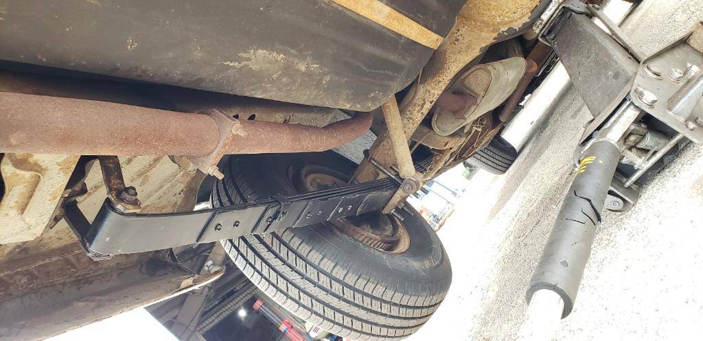

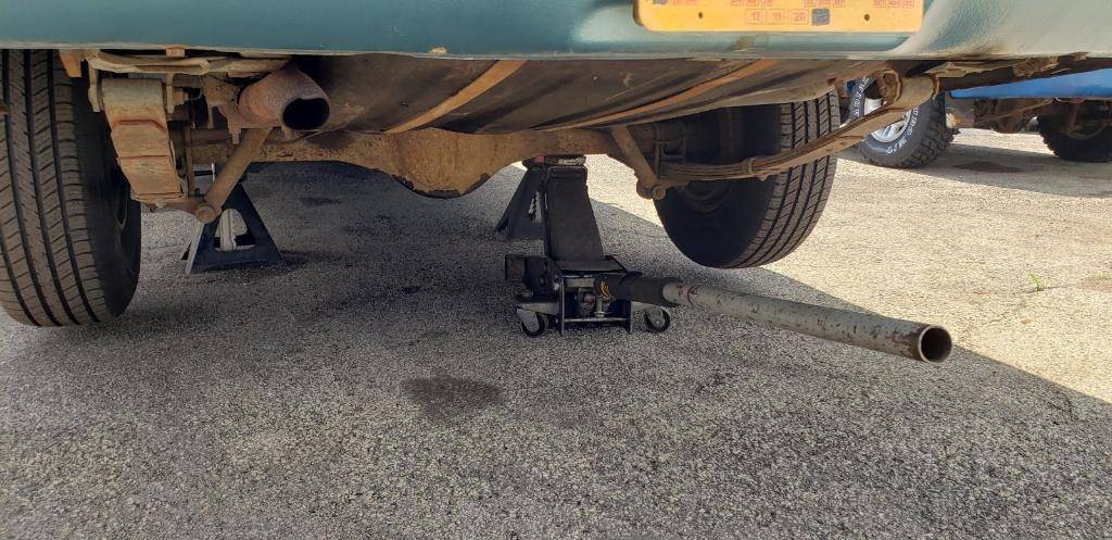

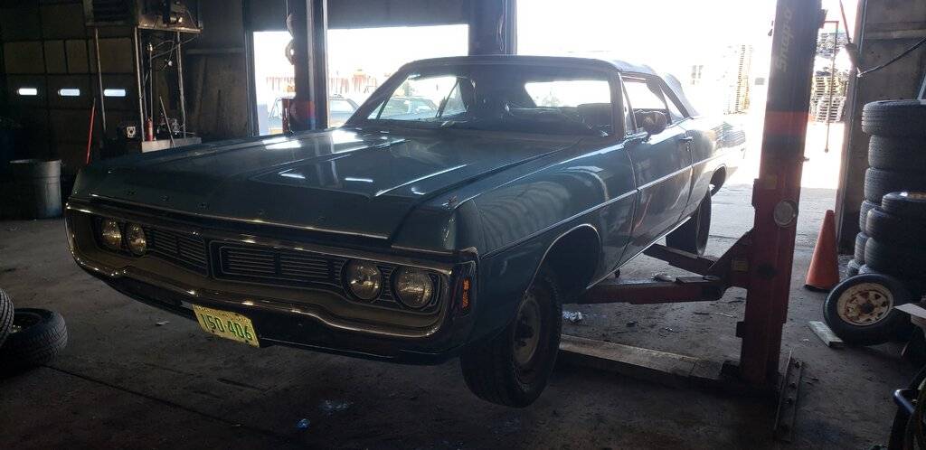

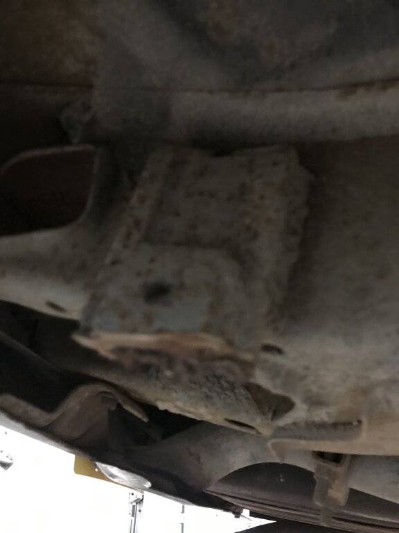

We learned in this post that the car was bought by the first owner for his wife. Tobias also told me that the 'vert was used in local harvest parades. The car must have been used for some other things as well, because the first time I put her up on a lift, I found evidence suggesting that an aftermarket hitch was at one point welded on but later was removed (see the photo below). Tobias has promised to help me get in touch with the first owner, and I look forward to hearing first-hand about the car's history.

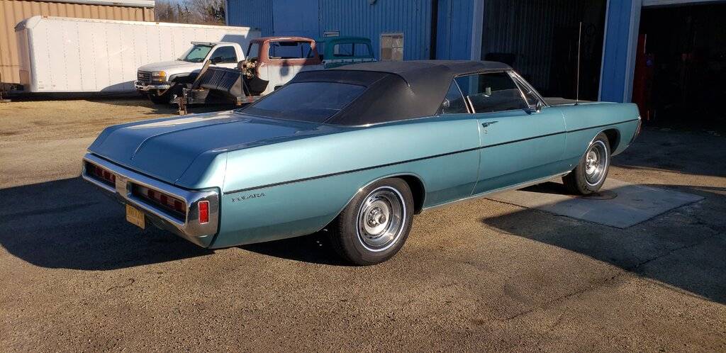

Even if she was built on the day of Halloween 1969, Regina is neither a ghost nor a Frankenstein. She was repainted in the original metallic light turquoise. Tobias had told me that the paint job was professional one and indeed, while it is not flawless, it looks good -- among the few imperfections I found are a bit of "ghosting" on the hood (which I hope will buff out), three small bubbles and a hairline crack on the deck (Dutchman panel, driver side), a couple of bubbles on the RHS front (of which I was aware before buying the car) and rear fenders, and a couple of bubbles on the RHS rear fender extension. There is some overspray on the gas cap and on the springs, but that's easily fixed. Most importantly, the car appears to be very solid underneath. The only bondo that I could find when I put her on a lift is a bit of fiberglass on the left-hand lower rear quarter, just behind the wheel; the rest of the underside appears original and free of any structural rust.

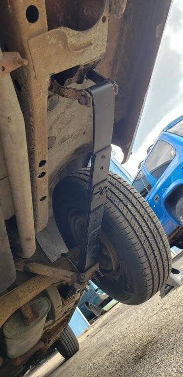

1. tires, suspension, steering, mounts, driveline: the original tires were old, so new 235/75R15 whitewall tires shall be ordered at the end of the winter; the A-arms, idler arm, and ball joints will all be replaced and the steering box will be rebuilt as there is some sloppiness in the steering; the shocks need replaced front and rear too; the rear springs looked fine at reception but are now almost flat, and so they shall be replaced as well (which will take care of the overspray

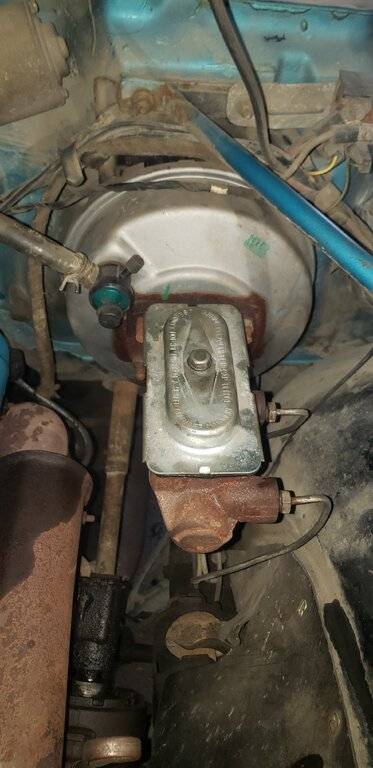

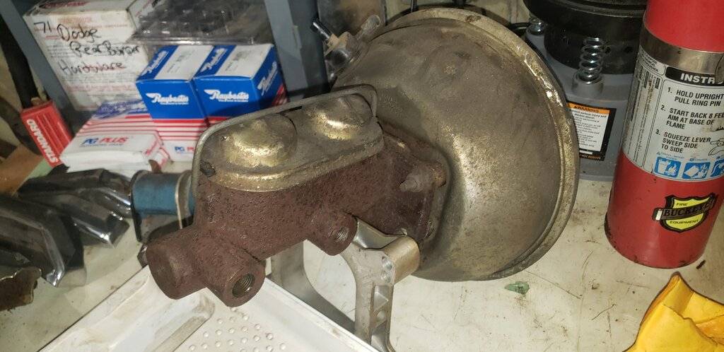

Edit: I forgot to mention the brakes. The four drums work fine 99 percent of the time, but at very low speed (parking speeds, approaching a red light or drop sign), the power assistance seems to disappear. The booster will be rebuilt, and the master cylinder may get replaced.
