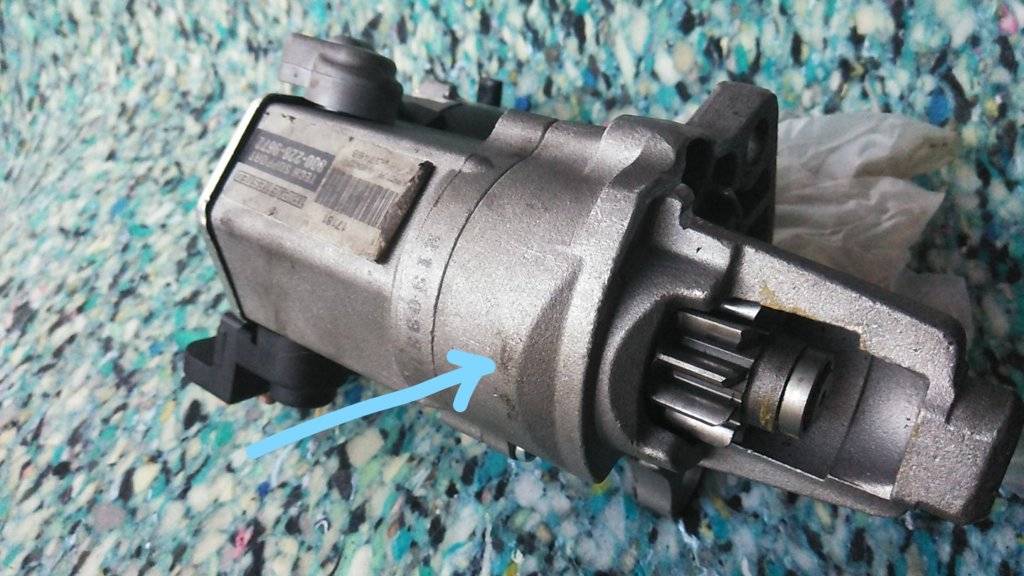

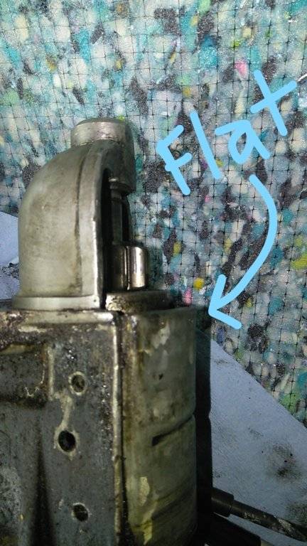

Did a test fit and it seems that at the flange where it mounts over the stud, there some interference. Won't let it seat correctly. Not on the face of the mounting surface, but rather on the outside edge, adjacent to the face. Will try taking off a tiny bit of material. There's also a difference in the housing, but it isn't causing any issues.

Sigh. Mini starter - 1, Christine - 0. Finally figured out where the fitment issue is. The solenoid housing protrudes slightly more (maybe 1/8") than the factory housing (will post pics later). I can only assume that it's specific to this specific starter. For now, I'm sticking with the old school starter. I'll keep this one around for a smaller motor. Perhaps it will work better on a 318 or 360.

Here's the interference I was talking about. This particular new mini-starter has a bump out at the solenoid side, which contacts the engine block. I wasted time filing down areas that I *thought* were hitting, but I was wrong all along. It wasn't off by much, but enough to prevent the starter from engaging the flywheel. Live and learn!!!!
