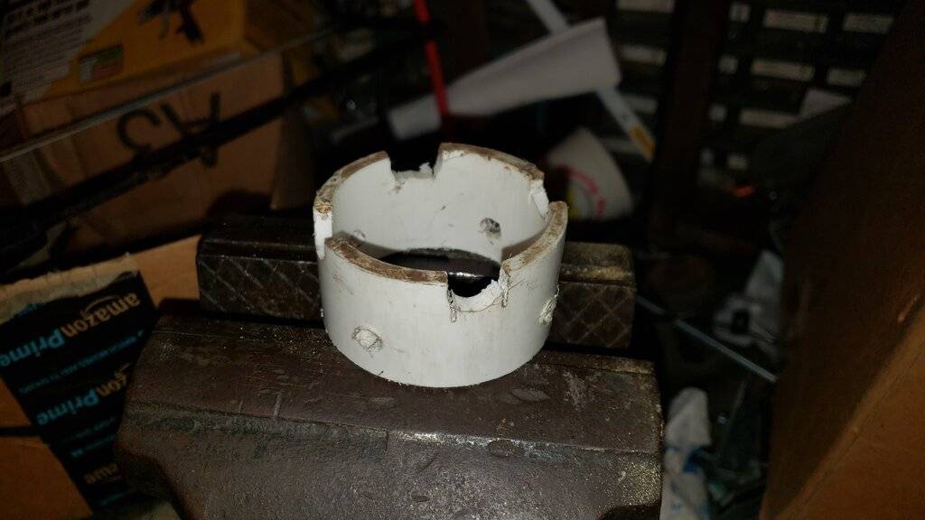

I never had a brass deal so I always used a piece of wood like a small wire brush handle to knock them around
I used a ball peen hammer and a flat head screwdriver. The tank was empty at the time BUT I am sure there were still some remaining fumes from draining it.
