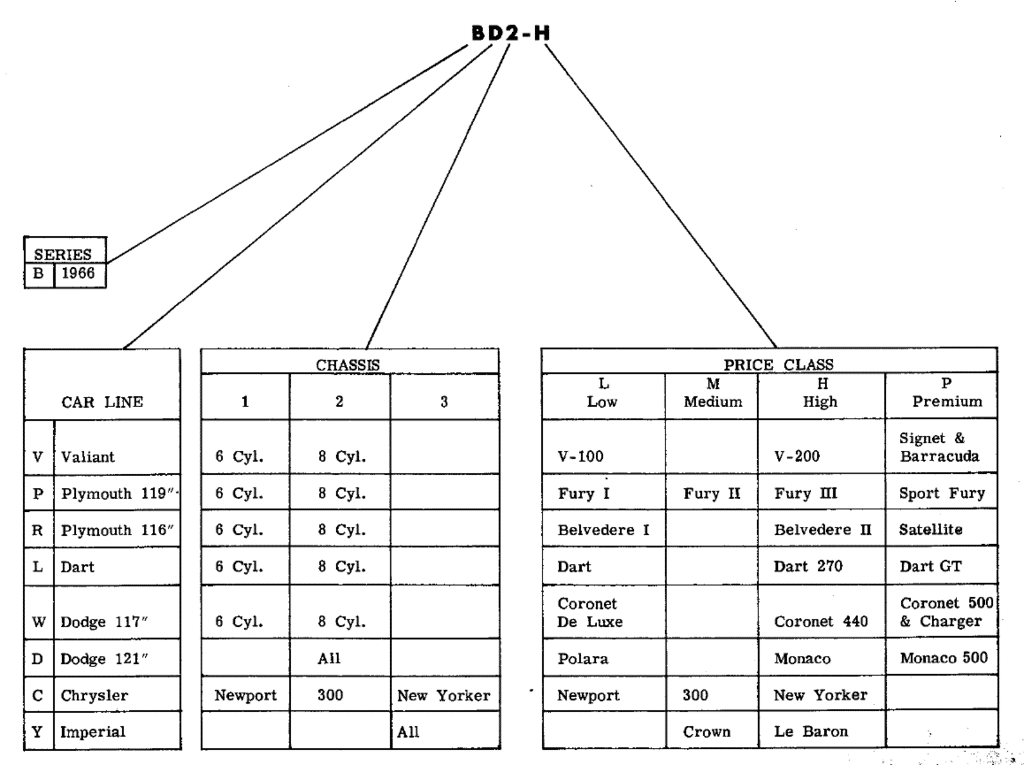

FYI for anybody that isn't familiar with the model codes, here is the chart from the 1966 parts manual.

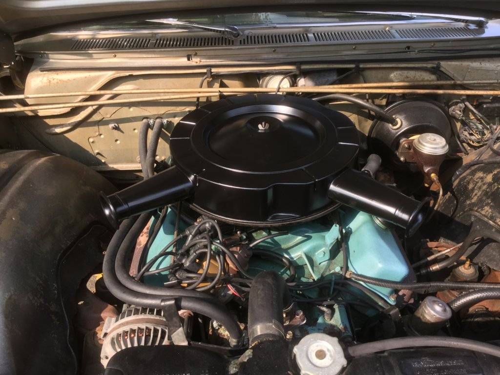

So I'm trying to plan things out and the first problem I've run into is the double snorkel doesn't fit the holly on the existing motor. Does anyone know if I'm gonna have this problem if I buy a new holley for the NY'er motor or are there different size bowls? available. Or will I be stuck with a rebuilt Carter?
Ross I have the Carter that came with the NY'er motor. The car hasn't ran since 79....
The air cleaner bottom plates are interchangeable. I have a dual snorkel cleaner on my Monaco. I have been told it's from a 67 or 68 big block with Holley. The upper section fits on my old base plate for the original Carter.

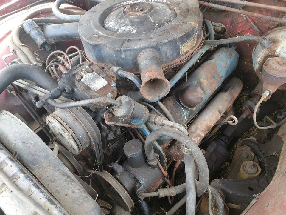

rapidtrans yours is newer than mine. Here's the only pic I have. I dropped it off at the powdercoater this morning.

That's the correct one for your car, as you know.
