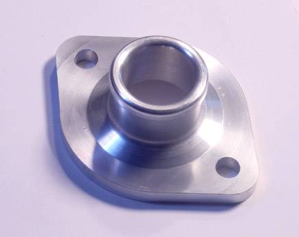

I use the billet aluminum one from 440 Source. I had problems with the stock ones leaking. A little pricey but I never had another problem.
Water Necks (Thermostat Housings)-440 Source

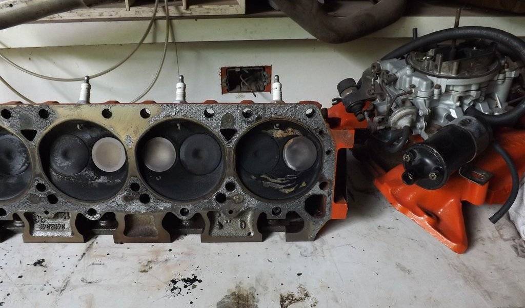

I pulled the head on the drivers side first, note the moisture corrosion on the surface of No8, strange.
IDK... I would have really liked the combustion gas test at this point. If even a little coolant got into the chamber I would expect it to be shiny and steam cleaned. It's off... may as well check it over carefully before going back together.
the area where the soft head gasket material didn't adhere is suspicious in itself. flip's dead nut right above. any evidence of steam cleaning in the combustion chambers or piston tops indicates a leak. checking for combustion gases would have eliminated a range possibilities. this seams more like a circulation issue though, more inline with post #73, with the engine in fact NOT skipping and no coolant smell from the exhaust on first start-up when over night cold.

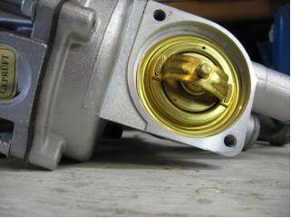

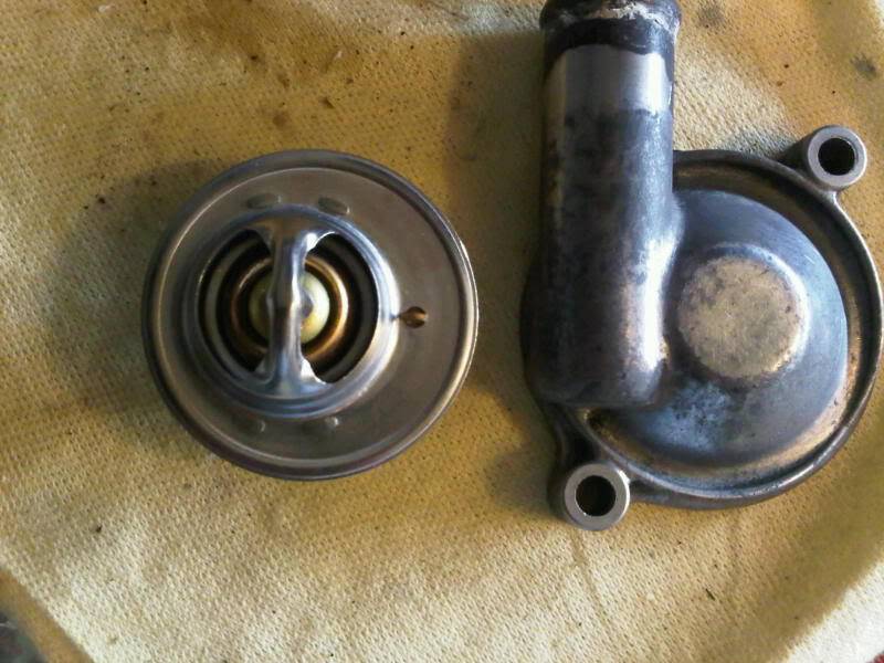

And no its not the thermostat, I have sat that in hot water and it opens fine. Plus I left it out too to see if anything changed, it didn't.
The only thing that is not suspicious about that is that there is no cooling passage there, seems if it was leaking it would be leaking down the side of the block. Maybe the other head will reveal something for all the effort.

If you pull a thermostat, always break the center (valve) out of your old one and reinstall the plate as a restriction... a completely missing thermostat allows too much coolant flow and can be the cause of overheating all by itself when driven that way. At idle, for testing only, less likely to be an issue. For small time racing or street builders who want to run without a thermostat: Moroso Water Outlet Restrictor Kits 63440
I always, break the center out of an old thermostat if I have doubts, I'll just replace it at the end of the job anyhow.

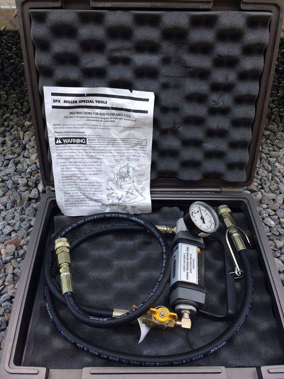

There are no automotive cooling system flow gauges that I am familiar with... a quick search turned up this Miller(Mopar) tool, but I bet it's application is more related to HVAC functions... judging by the hoses... maybe someone else can tell me about it's application.
