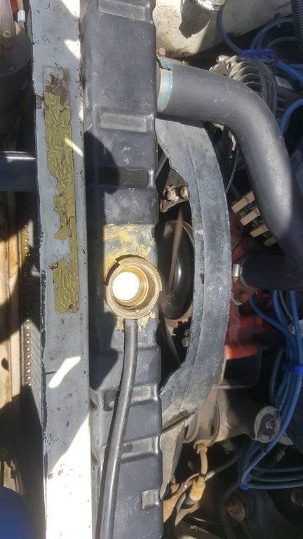

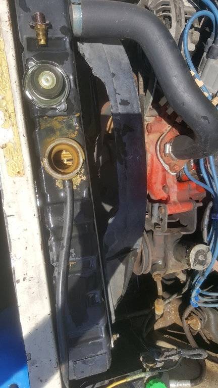

since i jumped into the middle of the thread with a totally different topic (thats how we do right?) about the snake oil radiator treatment (evapo rust thermocure from summit) I wanted to post a couple of pics about it:
View attachment 132145when i drained and flushed with water, i thought i had milkshake, figured the treatment ate something and let motor oil in. i was pissed.
but then after a up to temp warm up to get the t stat open, the foam cleared up - i guess its just some flim flam left over from the additive.
so another drain, and another water flush:
View attachment 132146 that sukka is clean as a whistle in there.

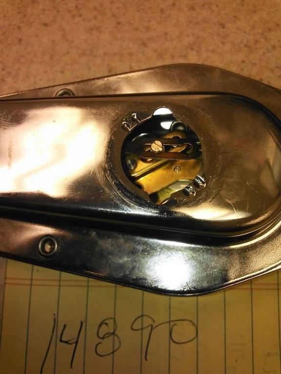

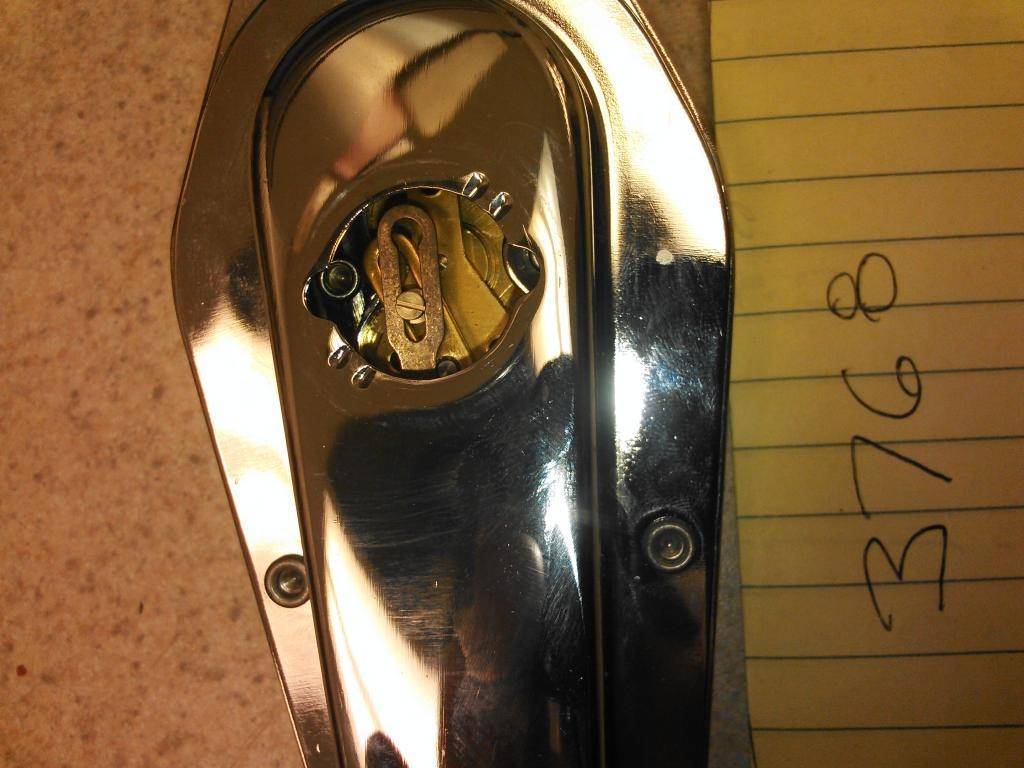

Here's a couple Snap-On dial wrenches that were screwed up. These are really nice... usually accurate if not abused.
The slotted piece with the screw in it is part of the bending bar. It should be in the center of the opening... The wrenches have been pushed past their limits.
And no... that's not a granite surface plate they are sitting on...
