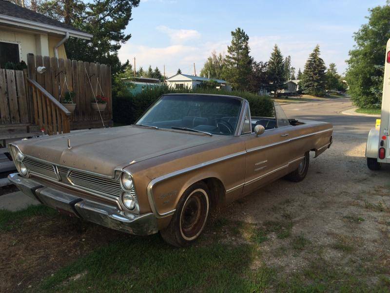

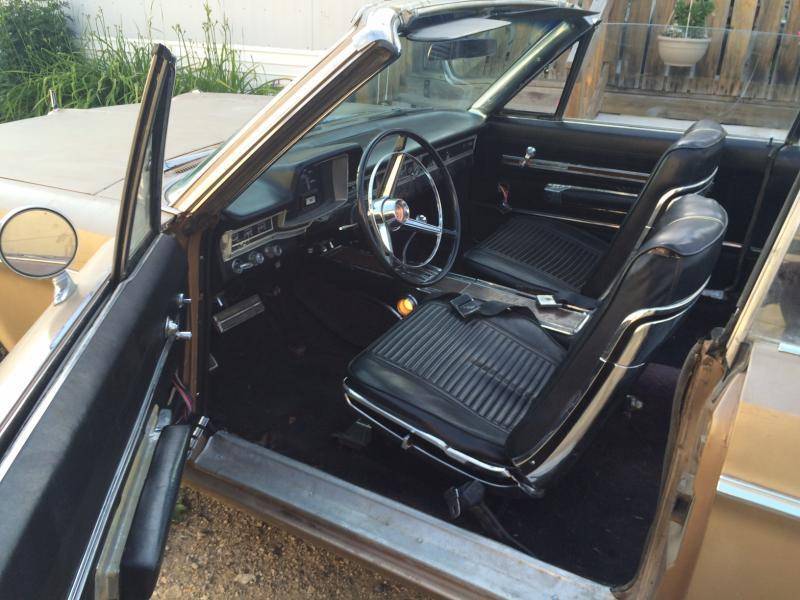

I finally took my barn find 66 Sport Fury for a ride and it worked great. Wanted to find out if there are any issues with it before I start doing the restoration. So far I have purchased a new top, carpets and tires, new seat covers will be ordered soon. Mechanically this car is in excellent shape so I am looking forward to the restoration on the body.
Will post pictures as soon as the work begins, probably sometime in September. IMG_0657.jpgIMG_0658.jpgIMG_0662.jpg
What a beautiful car. Is that original paint? If it is,maybe a good wet sanding and buff would be better than a repaint. It's only original once, from the pics, the interior looks great. Clean the engine bay up, new top, etc, it will be a worthy candidate for sure!
Thank you for sharing.
Wish it were the original paint but sadly it isn't. It is going to need to be done properly to make a real nice car but I knew that going into it. The car is solid so and I didn't overpay so I figure it is worth it. I will try to keep it original as I like the looks of it, more pics to come.

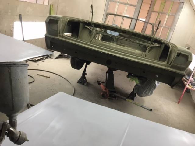

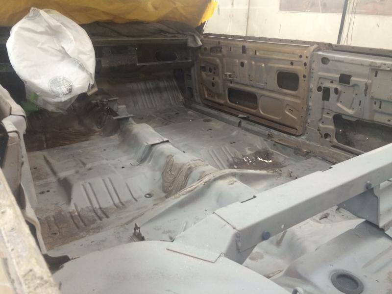

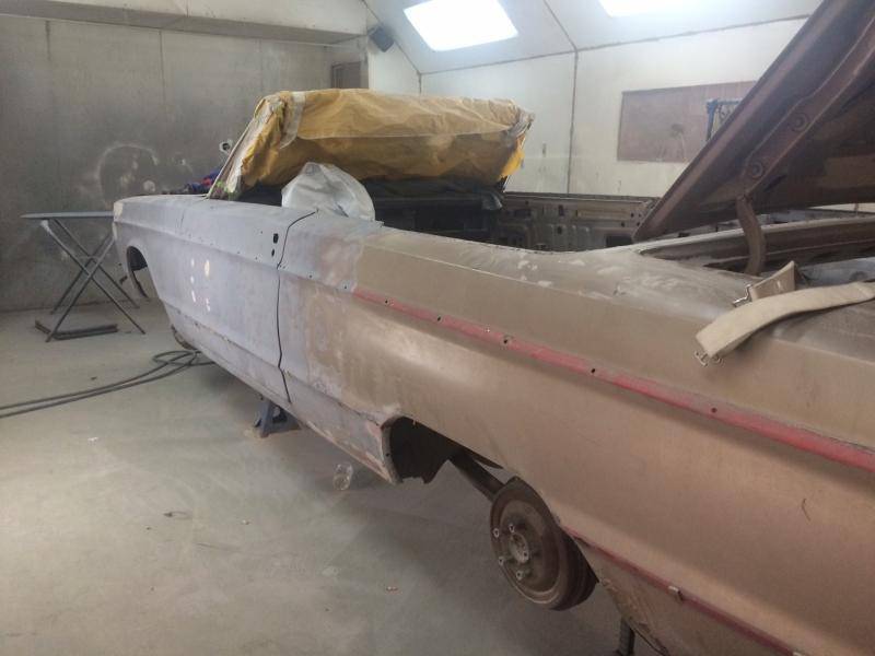

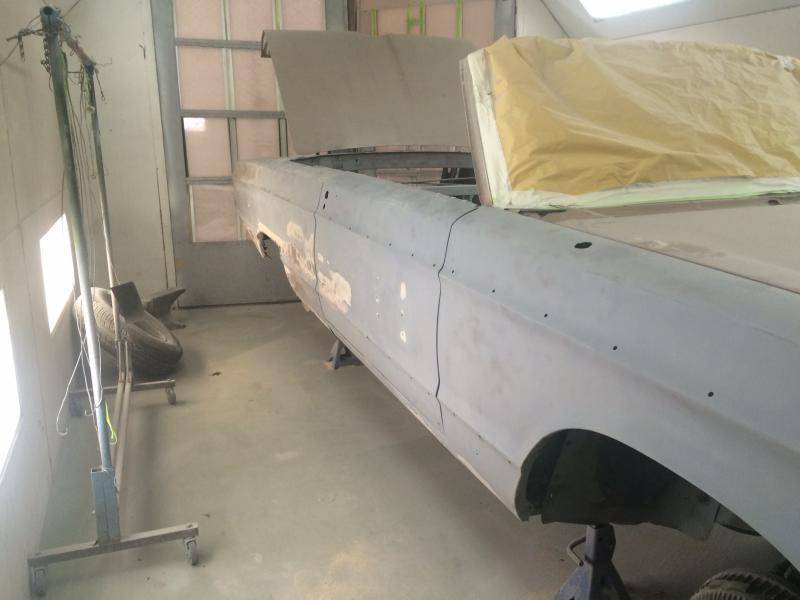

Well things are progressing and the body work is underway. I am attaching some pics to show what has been accomplished to date. The car is at a shop in Silver Manitoba called Paint it Black and they do awesome work, you can check out their website http://www.paintitblackcustoms.com.
I was hoping to get a recommendation on the rear quarter panels. As you can see we need to replace them and I have read a lot of posts about them, most don't sound all that good. Any ideas would be greatly appreciated.
http://www.paintitblackcustoms.comIMG_0791.jpgIMG_0916.jpgIMG_0917.jpgIMG_0923.jpg
Just to let you know we are planning on taking the windshield out, I figured it would be better if they do it so I don't butcher the trim too bad. Then the rest of the dash comes out. Also still pondering the engine and tranny, we will have to see how far the money goes.

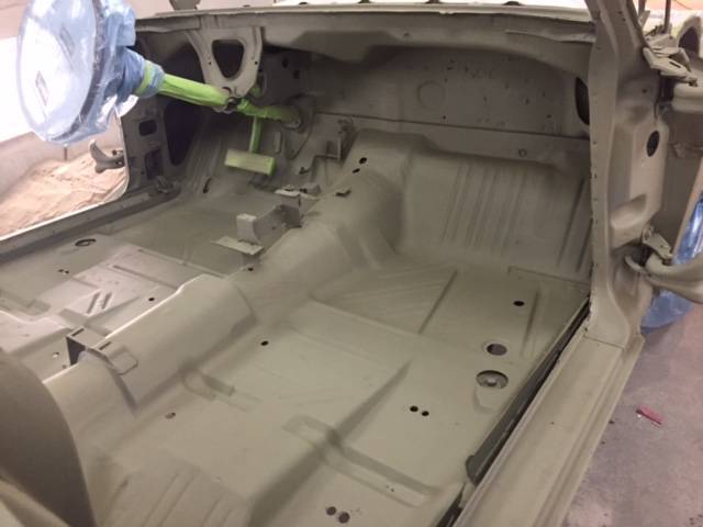

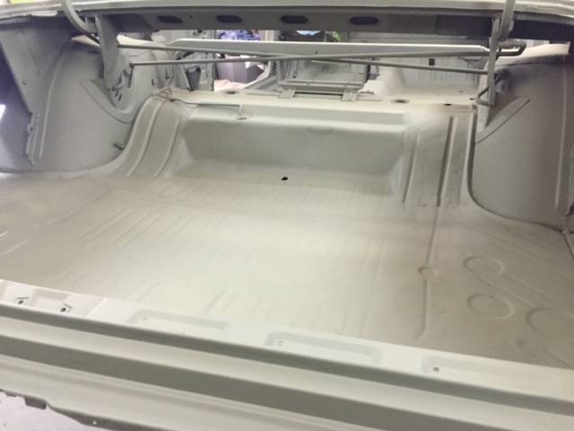

To date they have done a great job. The car media blasted, new trunk floor, new rear quarter panels, doors repaired, new floor panels and fenders repaired. It was in a lot worse shape than I had anticipated and we didn't realize it until the media blasting was done. At this time there are about 300hrs into it and still working on it.
Looking forward to the color being put on. Hope to have it on the road by the end of May.

This will start a good conversation. I purchased the trunk pan and the floorboards from C2C, not much choice with this. The guys were quite pleased with them and they said they fit well. The rear quarter panels cam from Nor/Am not as lucky here. One side fit well the other side needs work. They were still pleased though as it is simpler than making new ones. I think the pics tell the story on the fit.
