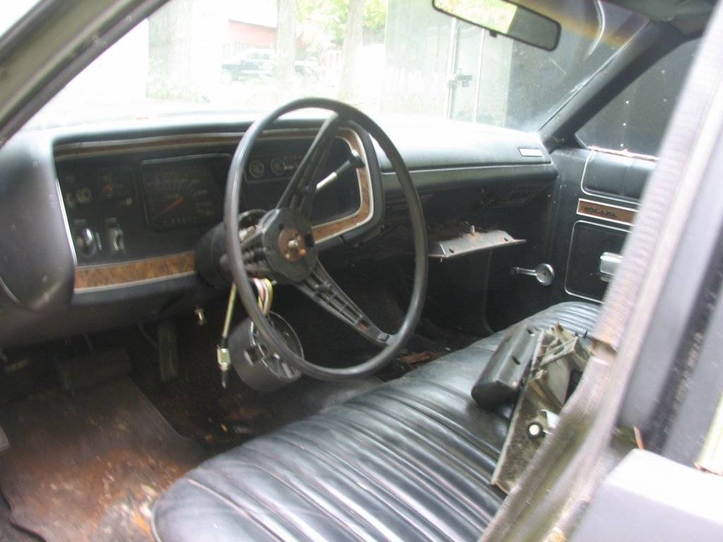

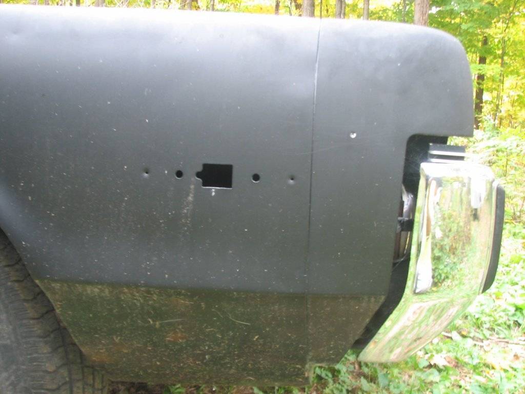

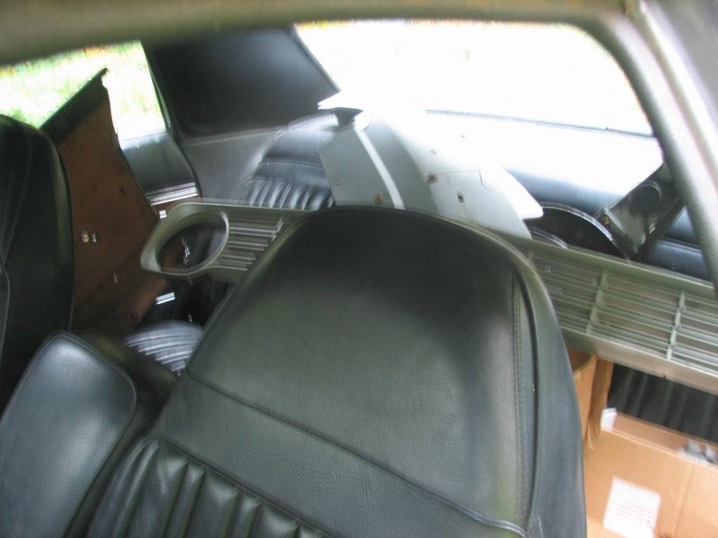

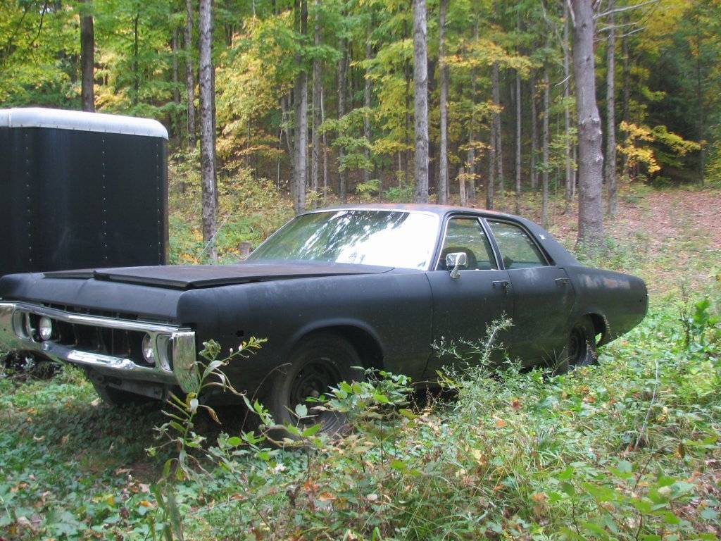

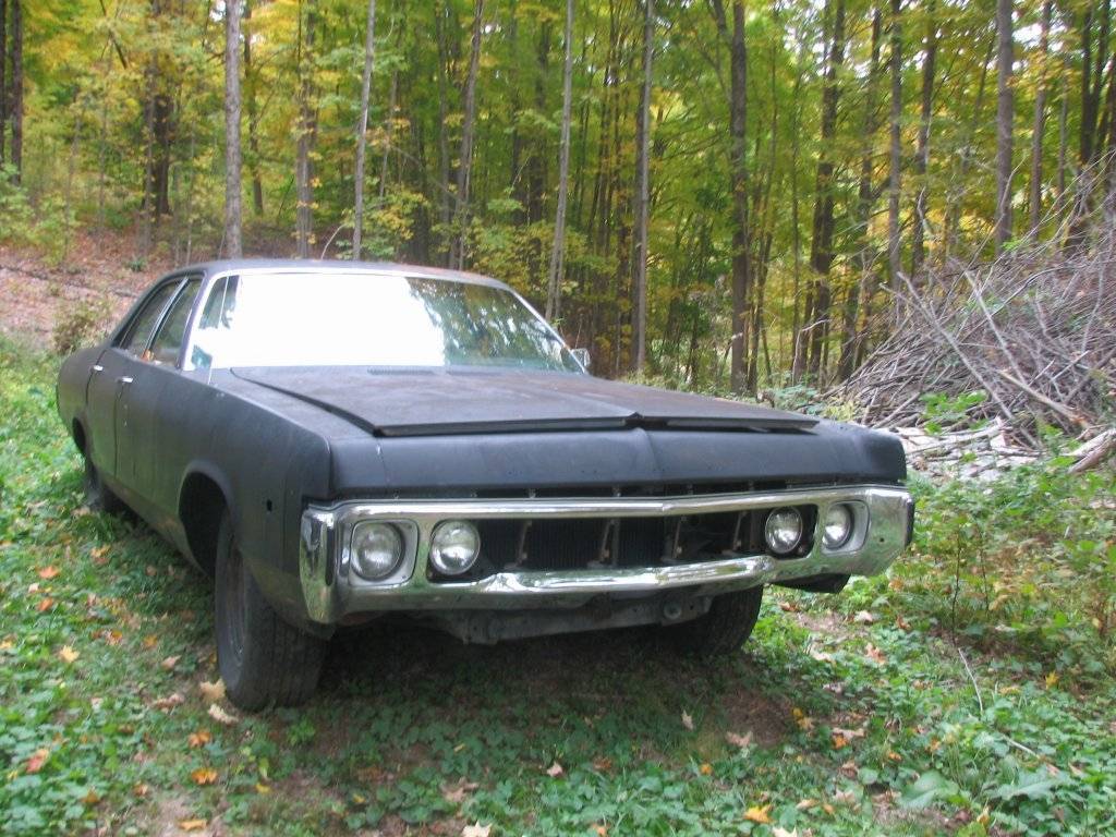

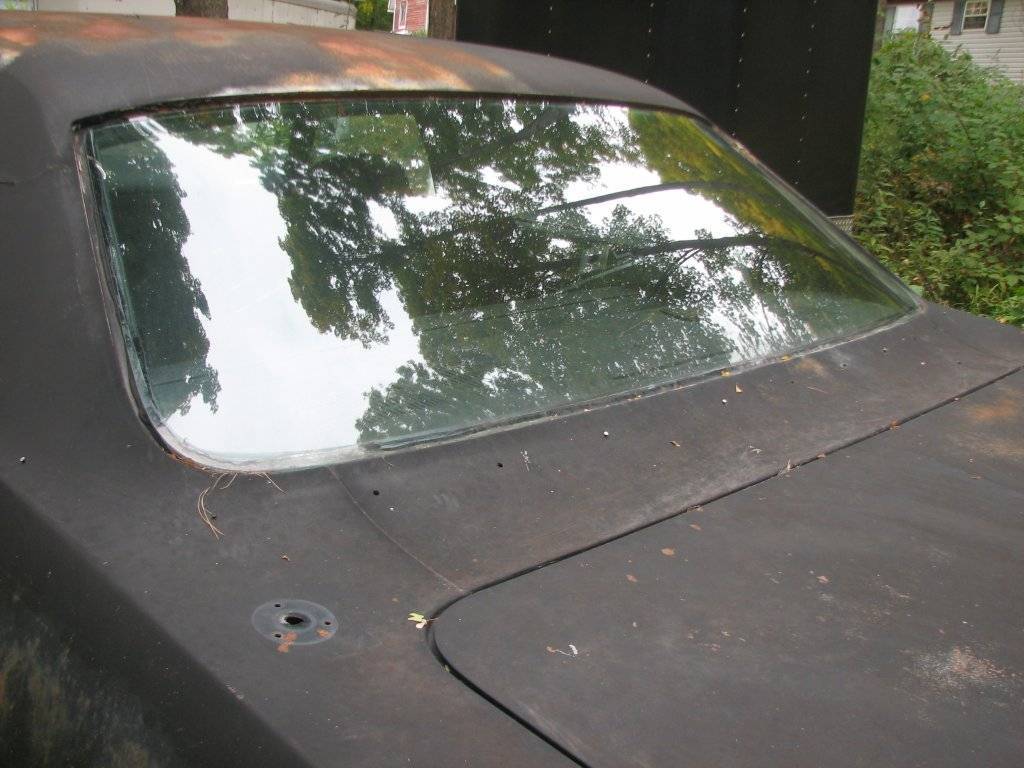

Here's what i'm working from. Car is pretty solid, interior is good, no rips in the seats and dash is OK. Can't get into the trunk yet (who takes the lock out of the deck-lid, then closes the trunk? i wanna slap the happy out of somebody). Something i want to see is what the original paint scheme looks like. i can't picture where the Body Stripe is supposed to be, does it follow the contour of the fender/sill moulding, or what? At any rate, the car is decent, and for a first attempt at resroration, i hope i don't frig this up too badly...

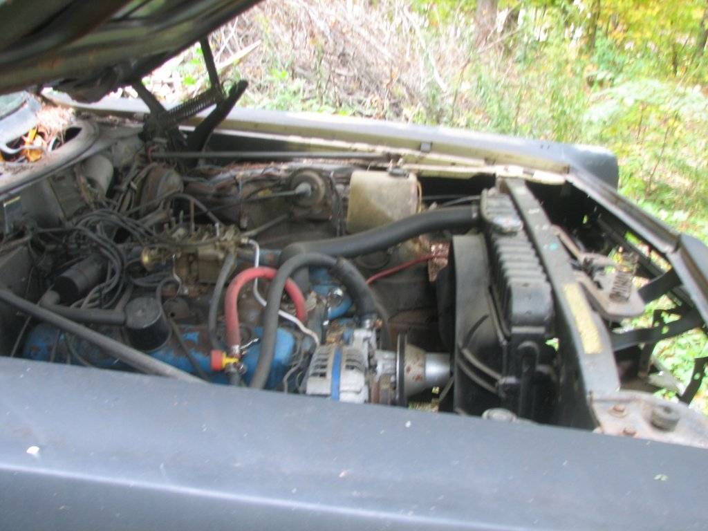

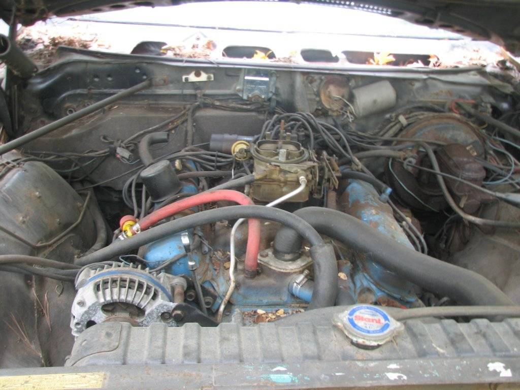

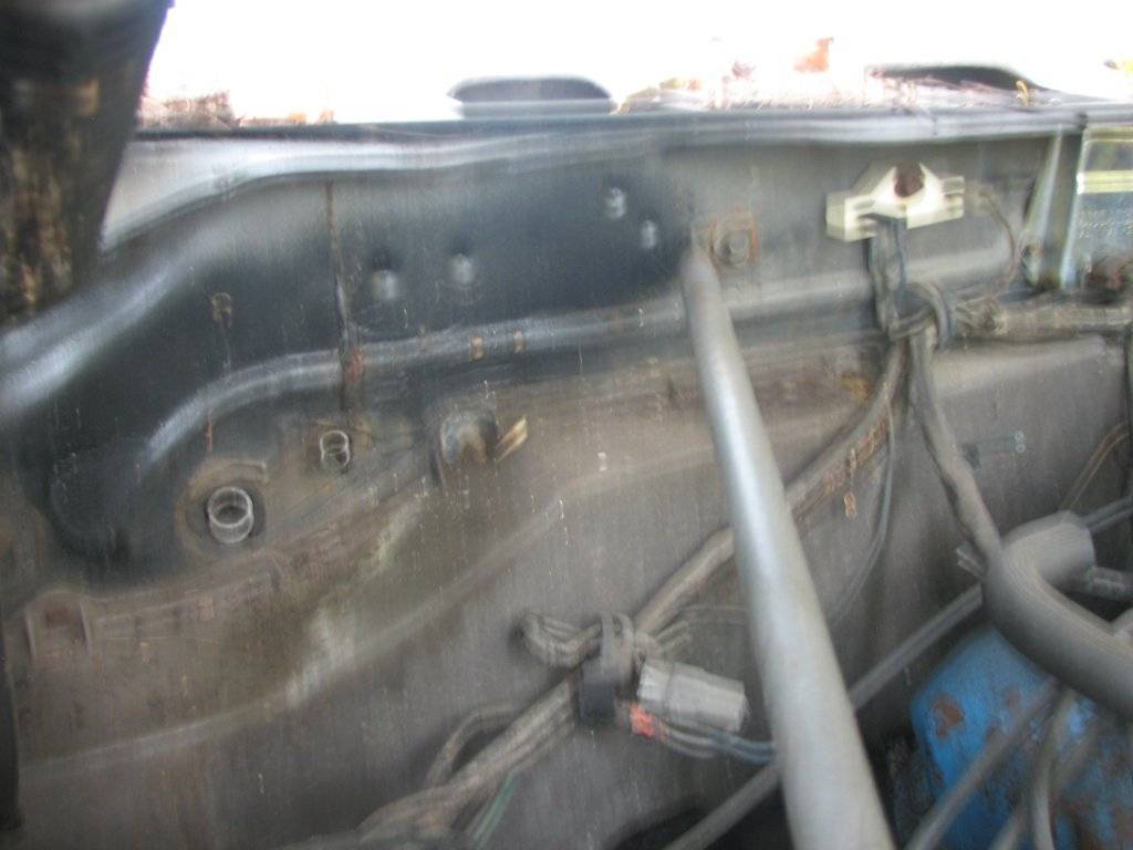

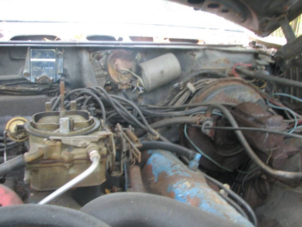

One thing is clear. The A/C is clearly MIA, and the connections on the firewall have been sheared off clean. Note pic 0933. (Sorry, i thought i had the focus more clean)

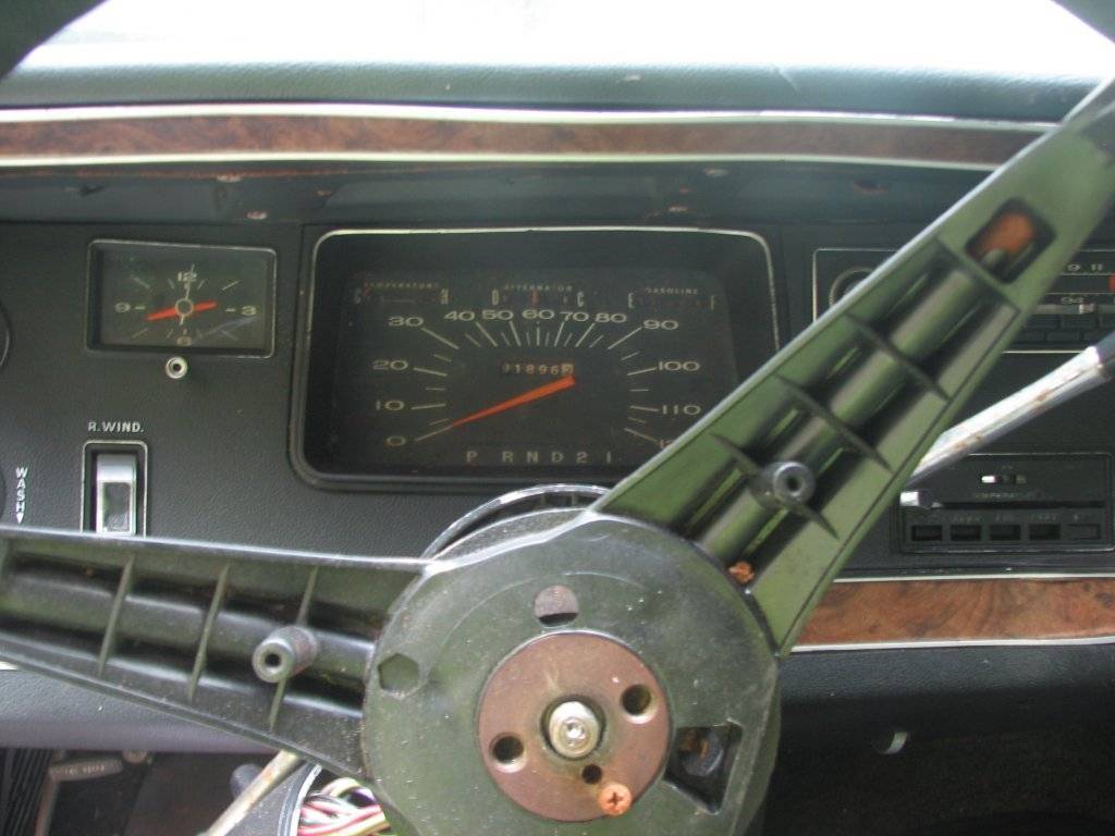

Pic 925... not easy to see, but the clock reads 01825. Obviously turned over, but i'm pretty sure only once. Sticker on the radiator core support lists a Florida service center. Most likely the car follows a familiar story... Dad buys a car. Works, retires, moves to Florida. Estate gives car to offspring, car goes back home, offspring don't want it, goes to General Public.

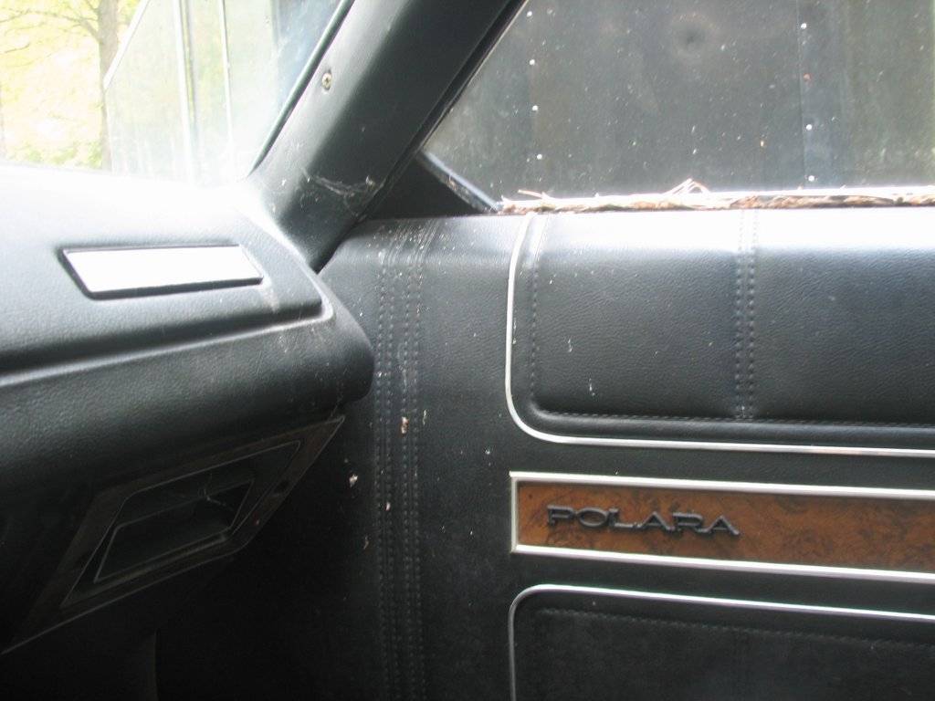

Pic 927, it's not clear but the dash has an emblem attached, 'Custom'. 'Polara' is embossed on the door panels
i've been searching and searching, but i haven't found what the paint scheme is supposed to look like. If anyone has a link that shows what the paint schemes from 1972 look like, i'd really appreciate it...
Update: the 'black side stripes' indicate the inserts that slide into the molding that holds the inserts matching the paint scheme. Several colours of side molding were available, depending on body colour... This info comes from Scott Dodge, owner of Fair Haven Dodge in Fair Haven, VT (Yes- he's one of THOSE Dodges)
