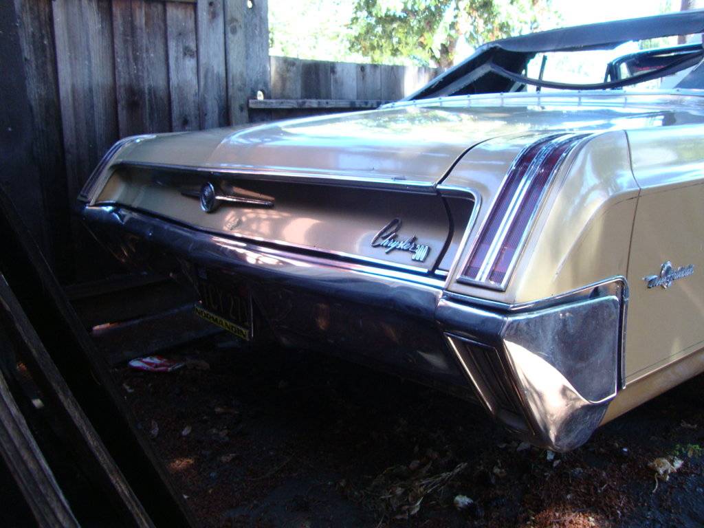

zymurgy , i've got nos 67 300 tail lights lenses , would you want to pull a mold from them ?
View attachment 240285 zymurgy , i've got nos 67 300 tail lights lenses , would you want to pull a mold from them ?

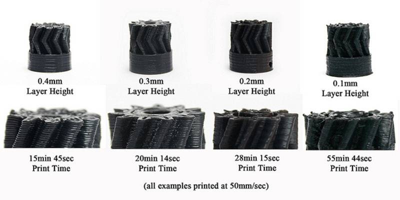

BTW, making lenses will be easier when 3D printers are cheaper.
The resolution needed for translucent 3D printing isn't going to happen anytime soon and it sure isn't going to happen in the desktop consumer quality machines.
There is a stereolithographic process that can produce "clear" objects using liquid resins, but they require a lot of secondary polishing. It's a very time consuming process with a finished product that will be marginal in quality both in appearance and durability.
In short, 3D printing isn't what everyone seems to think it is. Molding is a economical process that produces quality parts.

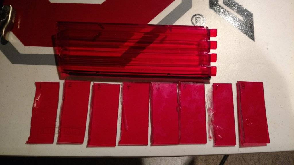

Plus if affordable 3D printing transparent colors ever comes around do you really think it will ever have the control I have for the exact color. I really doubt it, plus I agree the polishing process would be tedious and even impossible on some lenses.
Its number 6. :)

This is a good comparison of the resolution (layer thickness) and time needed. .10mm is about as good as it gets for desktop machines.

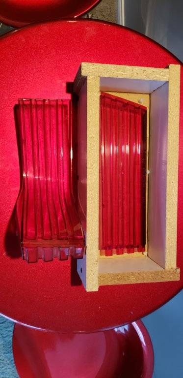

First mold box is made.
