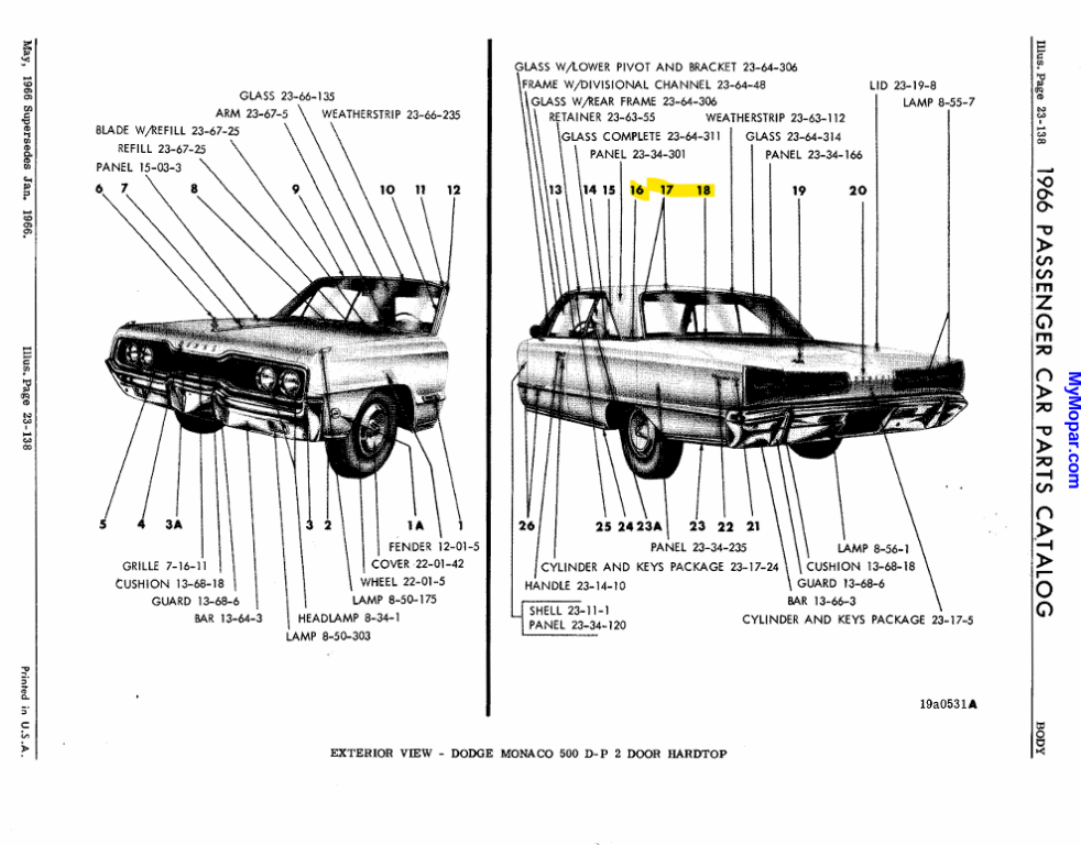

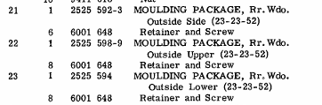

For D-P Dodge Monaco 500 and D-H Monaco, Show that the cemented in window had a different trim and was available, but seemed to share the same trim P/N's
D-L Polara (No D-M Polara 500 in 66?)
Has different trim numbers and does not mention cemented in Windows. Nor does it mention any difference on window trim between vinyl and non vinyl. Belt line trim does mention the difference.
Trim may be different between D-L and and D-H/ D-P but as shown above the windows were not specific except for glued in or weather strip. Not sure what is / was different on the glass frame between the two.
DL below, which is not the same rear window trim as the 500.
