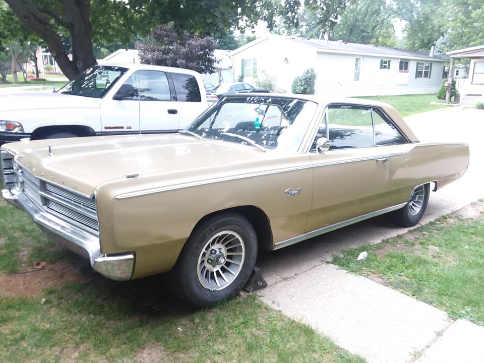

I turned 19 a week ago and bought myself a 67 fury two door hardtop the day before. So now im seeking some knowledge and help.
I was wondering what the cheapest way to convert my brakes would be? Ive got manual drums (11 inch) all the way around. My father says I could take the brakes from an 80s dodge and swap them. Any thoughts or ideas? Thank you!

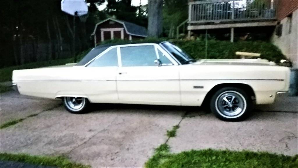

Great looking formal roof Fury III. I still have the drum set up on my 68 Fury III and they perform just fine. I always inspect and maintain them as needed. They stop straight with a high, hard pedal, even driving through the hilly terrain that is south western Pennsylvania. On a few occasions when going down a grade to slow down I'll drop down to 2nd gear to avoid getting the brakes too hot. I was lucky enough to find some older Chrysler riveted brake shoes a few years ago and they work great. They have a softer material and the rivets help dissipate the heat. You just have to remember you can't expect these cars to handle and stop like a lighter, late model car with 4 wheel disc brakes with ABS. I believe if you thoroughly go over your entire brake system and drive accordingly the drum set up will serve you just fine. By the way, I bought my Fury when I was 20 years old, in 1982! Have fun.
