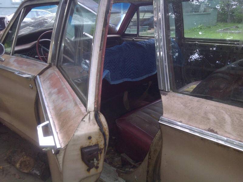

Got the rear doors opened today, had to get inside and hold handle whil repeatedly kicking the door. The drivers door and front passenger are going to take a little more work - I have the door panels removed and can see the mechanisms are quite rusty - PB Blaster evry few days and eventually they shoud work.

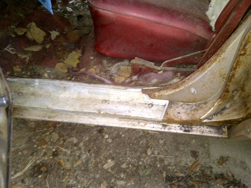

Surpisingly the door jams and the sill plates are not rotted as I though they would have been, the floor however.................well lets not go there.

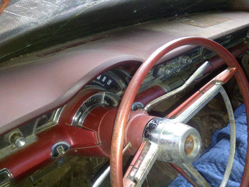

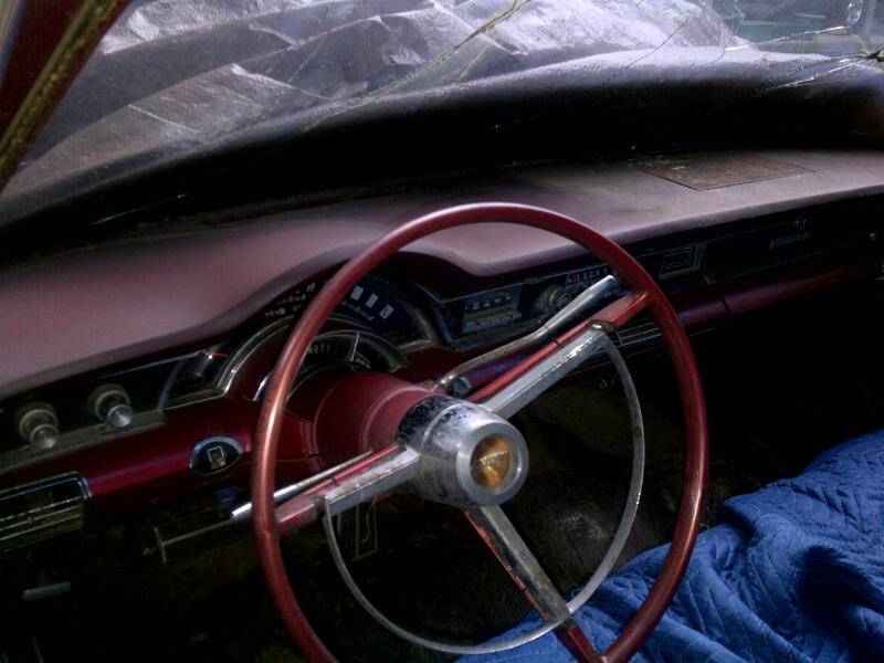

Steering wheel is not even cracked! I think the biggest mistake that is made with these cars that sit for years in these situations is that the owners don't care to prepare them for it. For Gods sake people remove that old carpet and pull the body plugs in the floorpan if you know the car will be a catch basin for rainwater!
