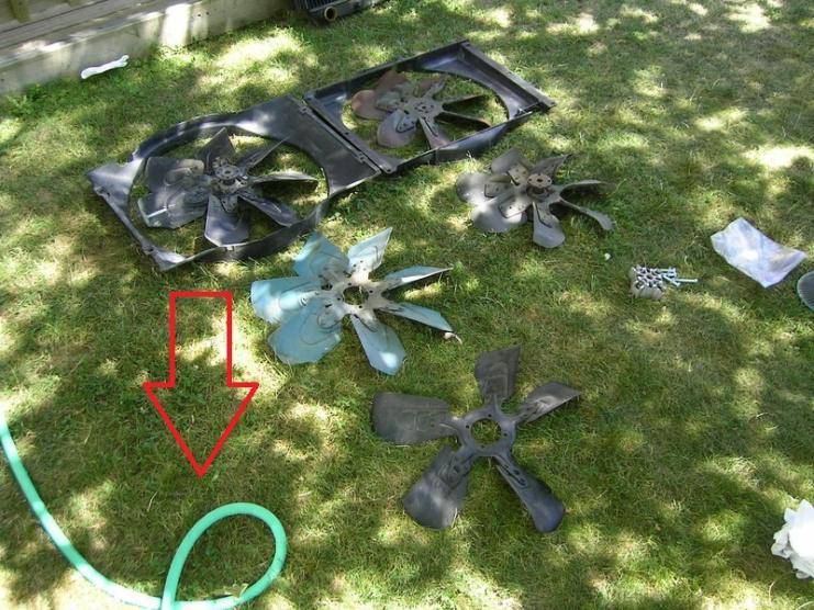

Then I spent quite a bit of time figuring out my fan and shroud. Here is all the fans and shrouds I have to work with....
The one on the left is the combo I've been running since I got the wagon on the road. It's off some mid 70's C-body? Can't recall what it came off of. The rad I was using was from my 71 300 4dr parts car that donated the 440/auto and parts to get the wagon back on the road. I had to modify the shroud to clear the upper rad hose, and then get it to mount...but it worked well.
The new rad had a different mounting set-up for the shroud. Luckily I had the proper shroud, again from a 69 300 parts car. Has a crack I repaired on the inside, at the center top, but at least it mounted properly. Then I had to figure out if I was going to use a clutch and fan or a solid mounted fan. I went with the 7 blade solid mount since we have been in a bit of a heat wave, and we plan on using it on vacation again this year so AC cooling is a must!

All the measurements were darn close. everything went in properly, except I had to trim off the two little tabs/ears on the inside edge of the shroud or it wouldn't sit flush. Only other issue was with the thread pattern of the studs to mount the shroud. They were some weird metric pattern. I never did figure out exactly what it was. I had to dig through my bucket or nuts to find 6 that would work.
