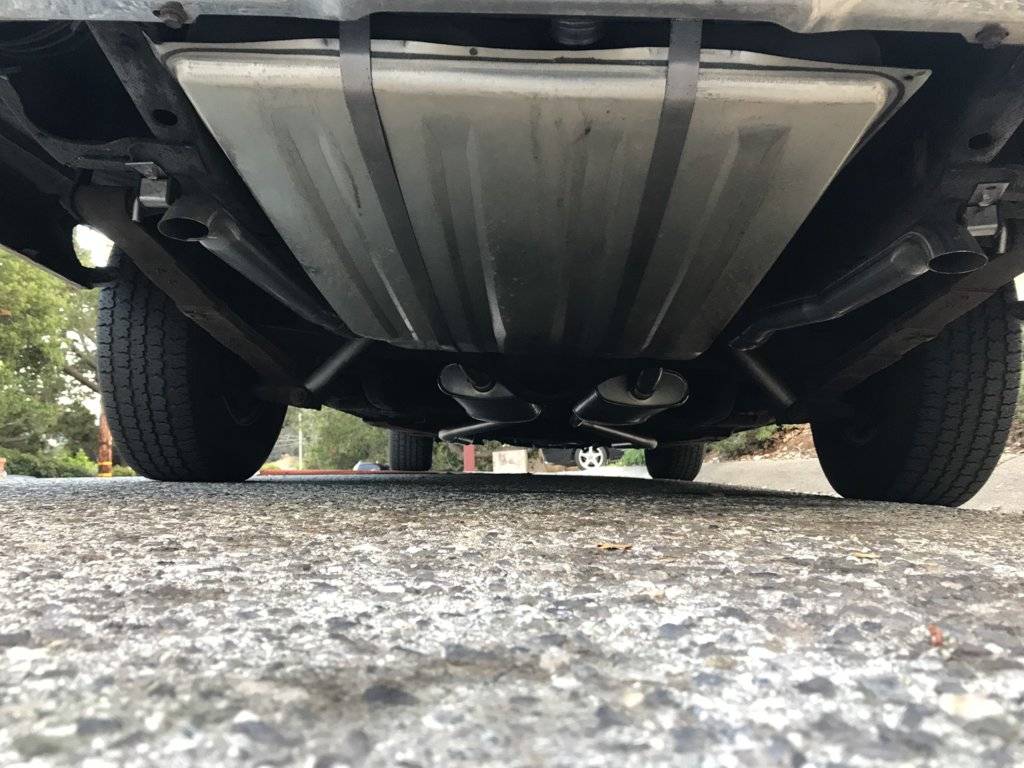

It's finally in!
Tips done perfectly, and terminated inward a bit to insure adequate room for future hitch. I might extend them back further pending how the hitch turns out...

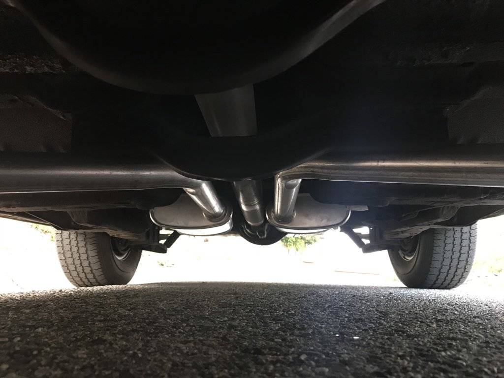

View looking back from transmission area.

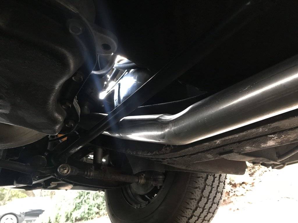

Left side exhaust pipe from manifold. He routed it just right, although it's too close to the bottom of the firewall so it comes into contact with the body under hard acceleration.

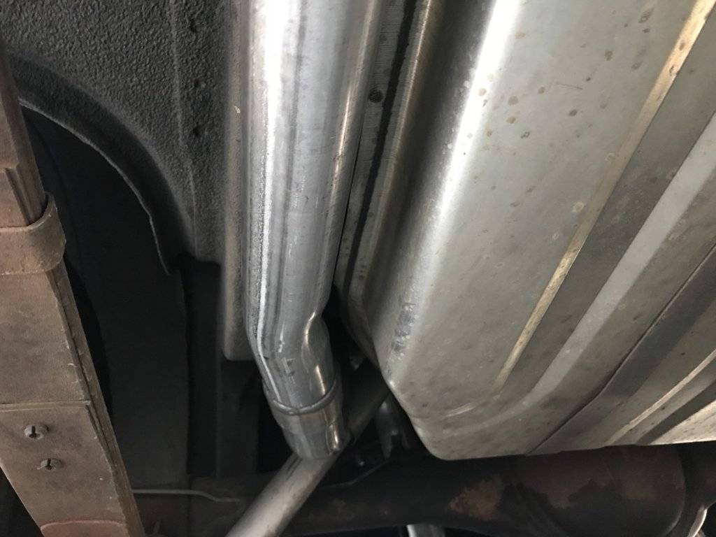

Right side pipe.
Rear view.

He installed Walker 17824 Sound FX mufflers. 21" body length.
For this car (and all C-bodies), the Walker catalog calls for #18381, which according to them is the same type of construction, just 4" longer. These are non-insulated mufflers and definitely "ting" when you rap them with a knuckle.
The Walker tech line guy recommended #21063, which is about 22" body length and their "Quiet Flow" line. It is SS construction.
For all of you who have had dual exhaust installed, what mufflers did you use and how do they sound?
I feel that it should sound like a sporty luxury car, understated power until called upon. Does that make sense?

IMHO, a lot of that drone is caused by your pipes being too short. The exhaust resonates under the car... basically hits the pavement and bounces back up. I had an issue like this with my '70 300 vert when I first bought the car. Ultimately, I replaced everything with a TTI setup, but the short term "get me through the summer" solution was a cheap, short glasspack muffler added to the end of the pipe with the tip extending out to the edge of the body.
Another improvement to the sound, and one that Chrysler did with their high performance B-bodies, would be an H pipe connecting the two pipes.
I've had a couple C-bodies, including a '73 NYB, with class III hitches and never had to shorten the pipes. They can be moved slightly outboard if needed, but the custom fit hitches I used to buy missed the pipes nicely.
Improperly hung...even with the rubber block? I don't think I've had any vibration problems (that I know of yet).

Good info. Once I get a hitch I will probably move the tail pipes as rearward as possible. I am going to build a hitch setup like Will did on his 'Jezebel'.
Going to add an H-pipe too. I requested this and he forgot.
Nice job for sure. I bend exhaust as part of my glorious job of an auto mechanic. It can be hard to get a system bent the first time on a vehicle you’re not familiar with, even giving due diligence, example being your rub issue under acceleration, seeing the craftsmanship on the job I’d guess you’re guy would make that right free of charge.

I use the same hangers as you have, it’s not original but they are the best option available to exhaust fabricators. They are more rigid than most original hangers and I’ve run into vibration issues from having too many, all part of the fun.
