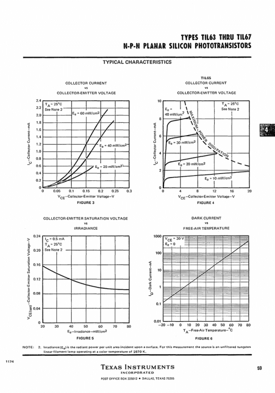

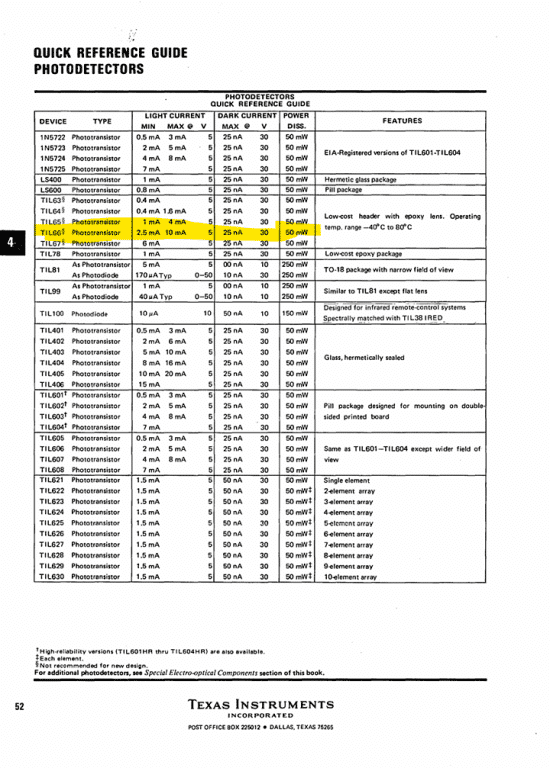

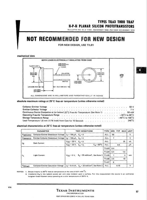

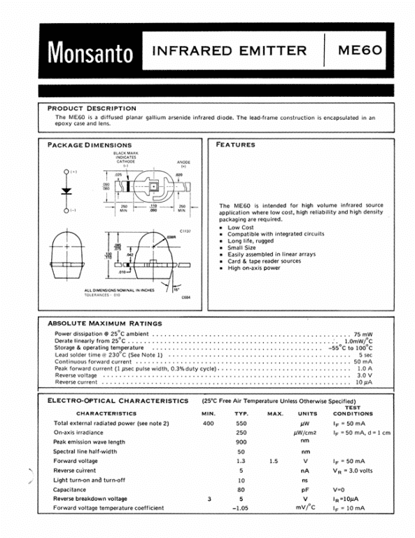

Not much luck on the Photo- transistors. At least the TIL66, I am trying to do some research to see if I can find a compatible replacement. I may have to switch out both the IR LE and the Phototransistor's with a new matched set.
Here are the ones I have.

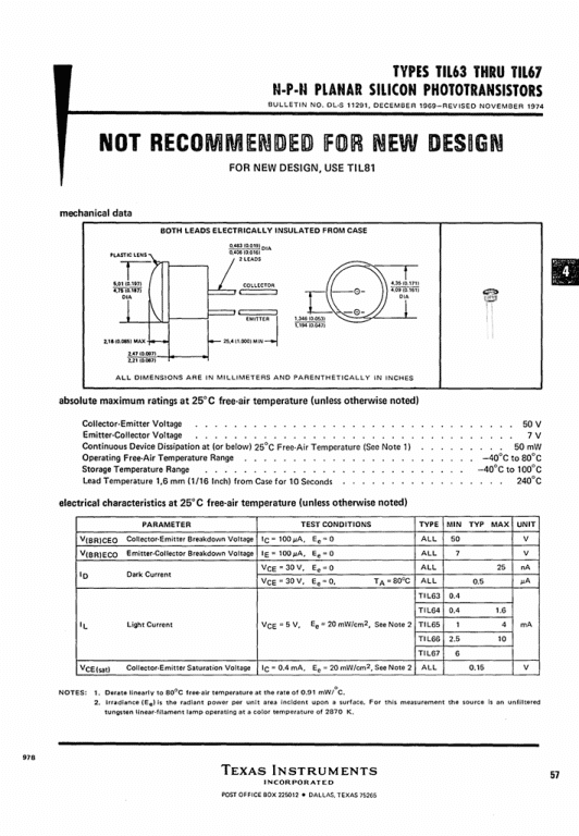

I also found a book from Texas Instruments with a 1978 copyright, that say do not use the TIL66 in any new projects. Page says revised November 1974 so likely out of production since the mid '70's
