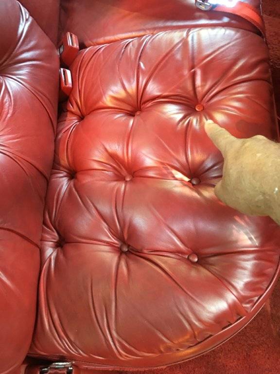

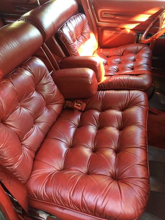

not on the list but while I was at it: repaired the missing button on the pleated leather rear seat:
missing button that was driving me nuts is finally in. Ended up making it out of some red vinyl I found that the previous owner left for the next owner.

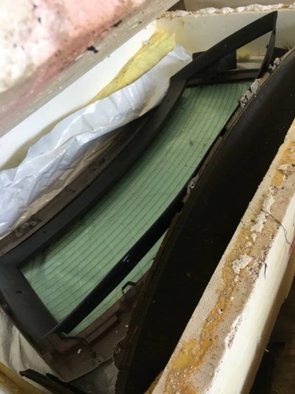

Here’s a picture of the plug and trim. I also got a black dash pad that looks to be great... any takers before I put it on EBay??

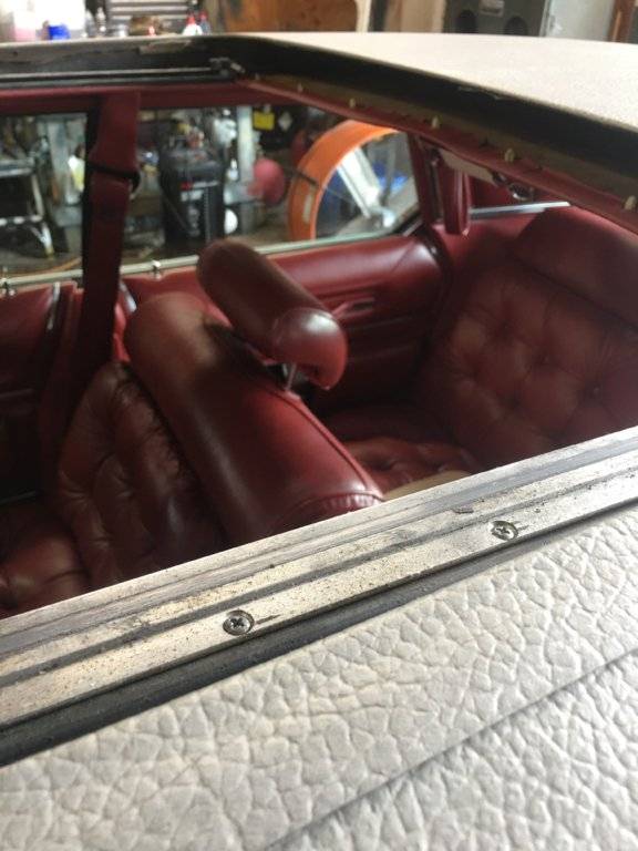

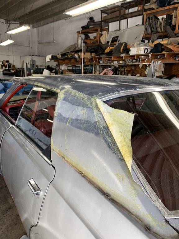

Well.... it’s Friday. Yesterday I took the New Yorker to get its Salon roof as scheduled.

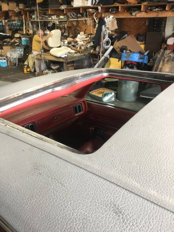

Arrived after lunch. Can’t wait to see it finished but first want to check condition of steel under the top.
I had already removed the sunroof panel and put it in the trunk prior to going over. The guys at All in Leather are great but I like to do the little stuff and make it easier for them when I can.
Another view of roof opening. The seal was actually glued on and it took some doing to get it out whole. It is my intent to rehab it and reinstall it.
New top material looks great.
I also have 5 yards of the correct silver pebble grain for a non Salon 78 if anyone needs it before it goes on EBay as well.

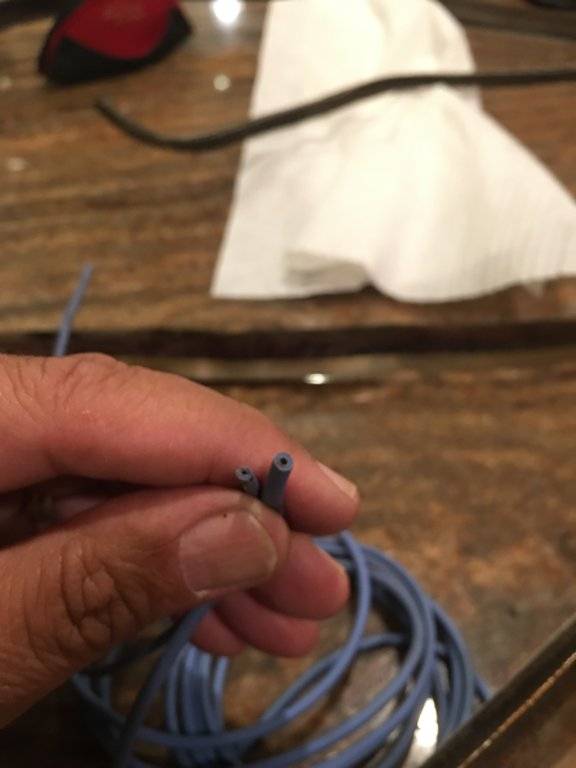

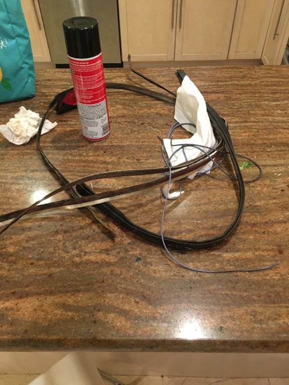

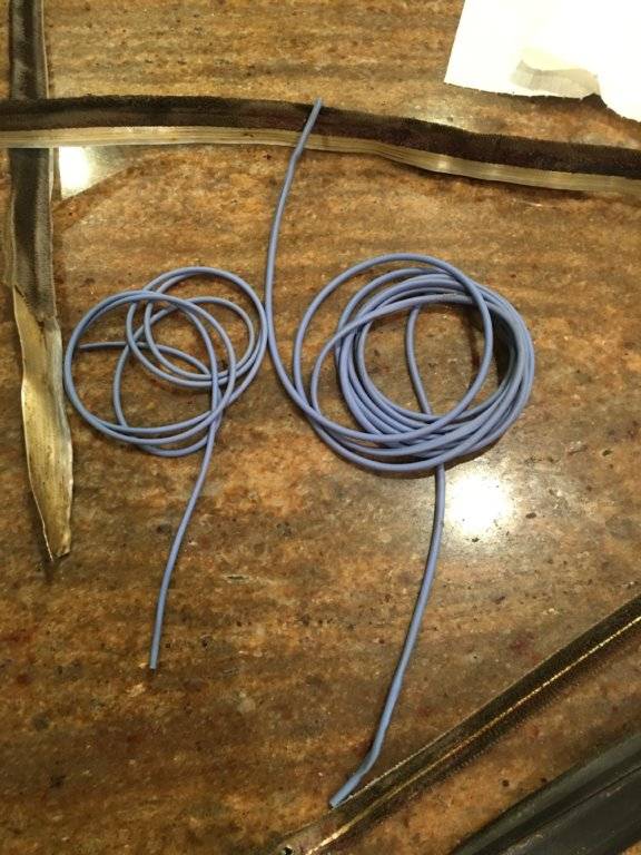

Back at the ranch.... started working on the rehab of the seals. Starting with a good cleaning of the components. I was able to save what I wanted, namely, the aluminum backing and weather seal strips strips that go under the flocking.

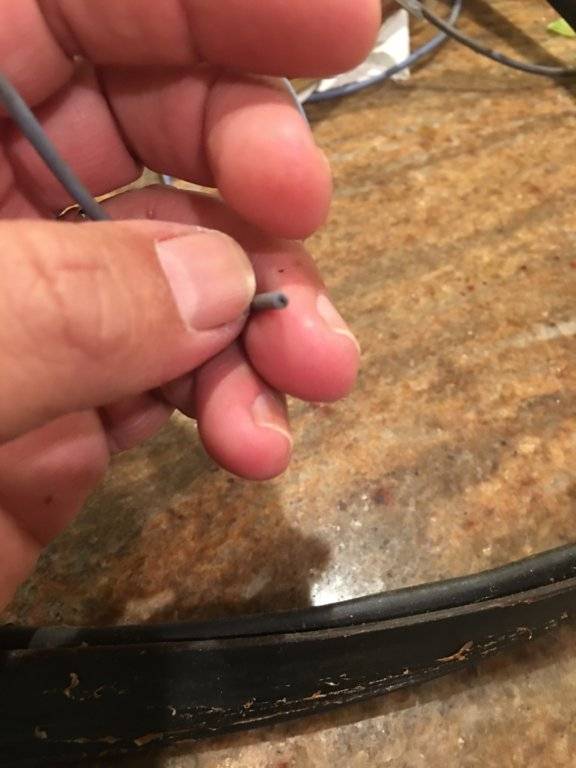

The strips themselves are actually silicone tubing.
There is a narrow gauge (3/16”) for the rear of the panel and a thicker gauge (1/8”) for the seal that is mounted to the roof along the front and sides of the opening.
Everything cleaned up and almost ready to start reassembly with the new flocking.... maybe tonight???

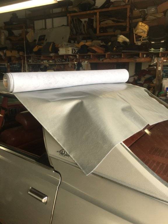

Here’s a picture of the original top material I bought. Any takers? 5 yard and original material from SMS. Will take $125 (half of hat I have in it) plus freight.
