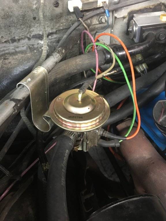

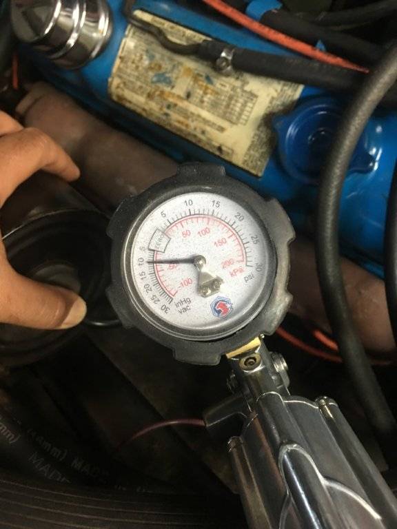

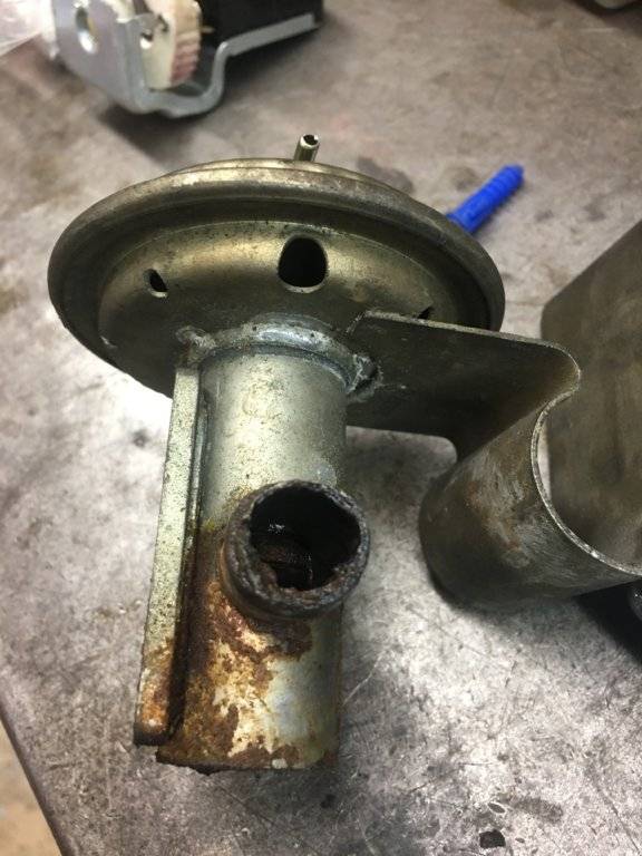

Heater valve was stuck open. I got t it to pop closed only with 30inches of vacuum.
New one moves with as little as one inch of vacuum.
Here it is in place.

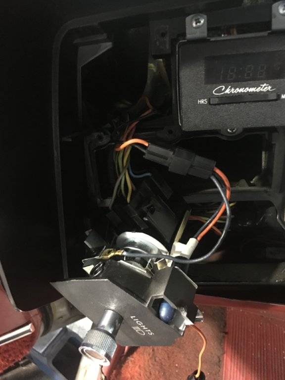

Headlight switch and system check:
Here is the old switch with the lead to activate the headlight doors obviously loose from overheating.
New switch in for testing while I wait for replacement plug to come in.
That the switch comes out the front is a godsend!!!!

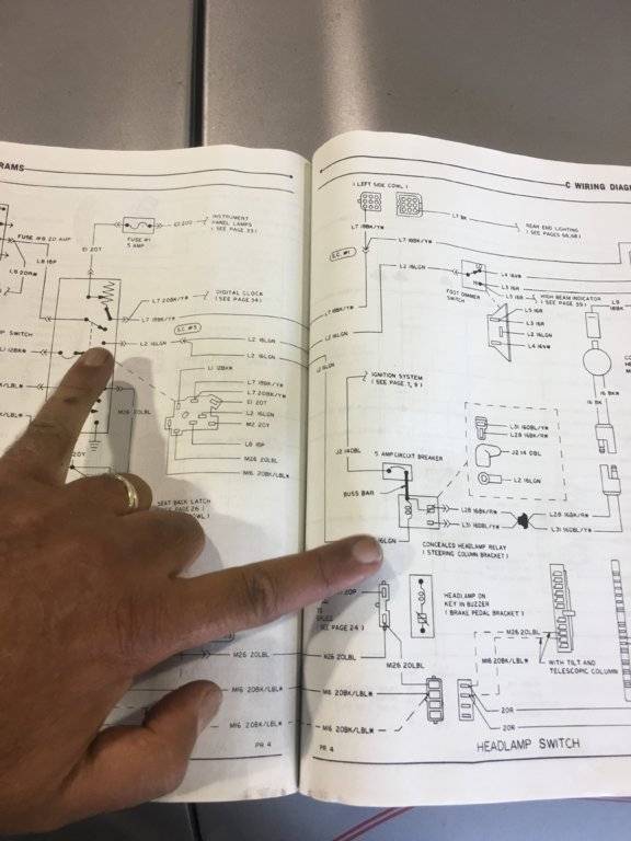

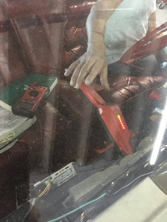

Problem with melted lead traced to headlight relay/motor.
Power good to relay with no short. Power for miter drive is through ignition.... which answers question of needing ignition in to operate headlight doors. Commentary below.
Power clean to motor..... check motor.
Internal motor relay checked partial open manually. Snaps closed (noisily). Cantens nurse to open (noisily) with ignition circuit energized.

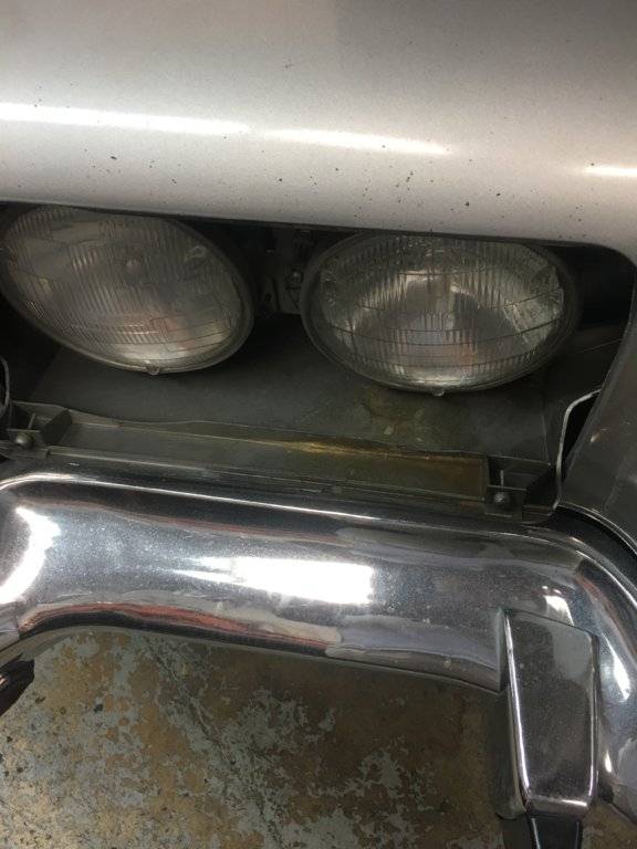

Checked operation of door.
Bingo. Right hand door was damaged which explained two things.
One: the passenger side door must have jammed in opening or closing cycle which back fed the system and overloaded the switch connector to the relay.
Two: explains the extra headlight door in the trunk.
Commentary: I don’t like that the headlight doors do not open only with the ignition circuit enegized. Should be run directly off main buss for non ignition cirquits. Bad design. Cheap solution to allow for use of same wiring harness only. Saved one power run. Dumb!!! Will need to run fused direct power to main buss.

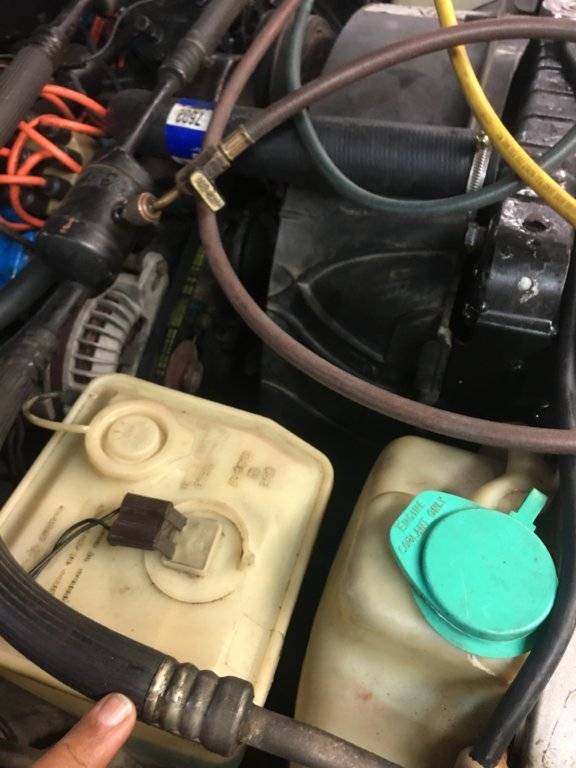

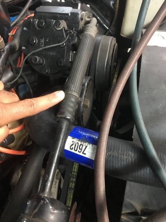

Just noticed some bulges in the high side lines I don’t like. Will pull and replace these while waiting for evaporator.
More than likely you will have to have your original hoses rebuilt. Any hydraulic hose shop can repair it. They will reuse the original fittings/ends.
I had mine rebuilt with a 24 hour turn around at Benz Hydraulics in Bear, Delaware.
Thanks! That’s what the meant... replace the rubber part of the hoses using the original fittings. Even NOS hoses are 40+ years old at this stage of the game.
Cheap reliability insurance. In for a penny....
