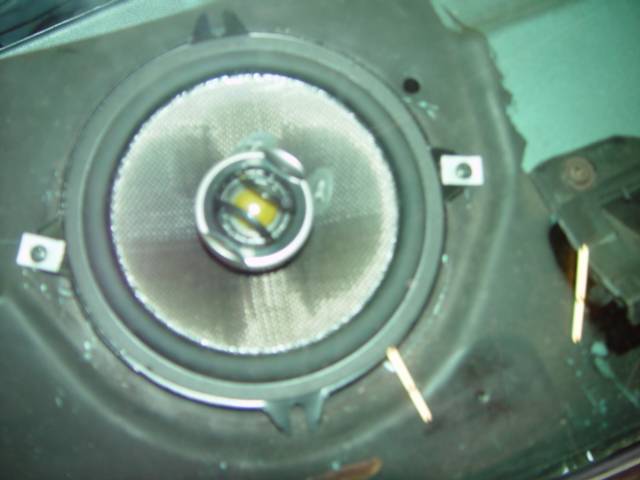

Also, you probably discovered that what ever you have for speakers are shot and if they still work sound like crap. The wiring for the factory speakers won't work for aftermarket you probably discovered by now. The ground wire on the factory speaker only has a single power wire going to each speaker. The ground wire goes from the speaker to ground. I used some decent pioneer speakers with a little sheet metal mods and I ran speakers wires to the front 2 speakers and the rear 2 speakers under the carpet and sill plates and snaked it through the rear seat to the trunk.
I think this was the only picture I took.
