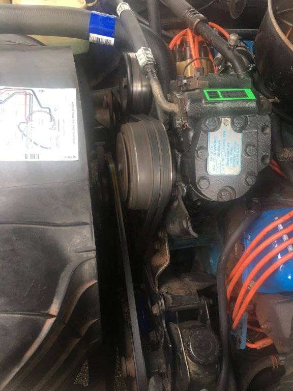

Now to the pulley noise......

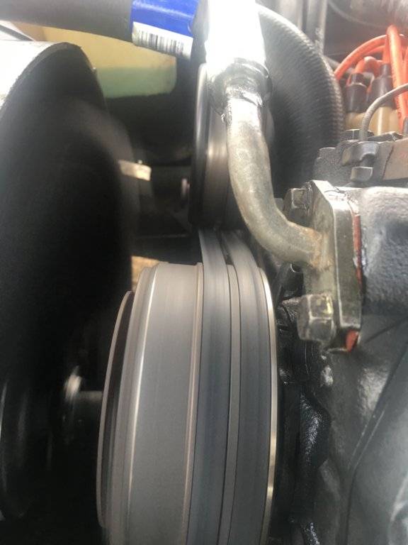

Thought of something regarding the idler pulley. Looked at it head on, in line with the belt to see if it wasn’t the bearing but the belts slapping the wheel making it sound and clink like a bell.
Bingo! Saw daylight! The moment the R2 compressor engages the belts were popping around and slapping the idler-wheel which was making all the racket.
Tightened the belt to about 1/4” play with a couple of pounds of my thumb.... and problem solved. At least until the belt stretches.

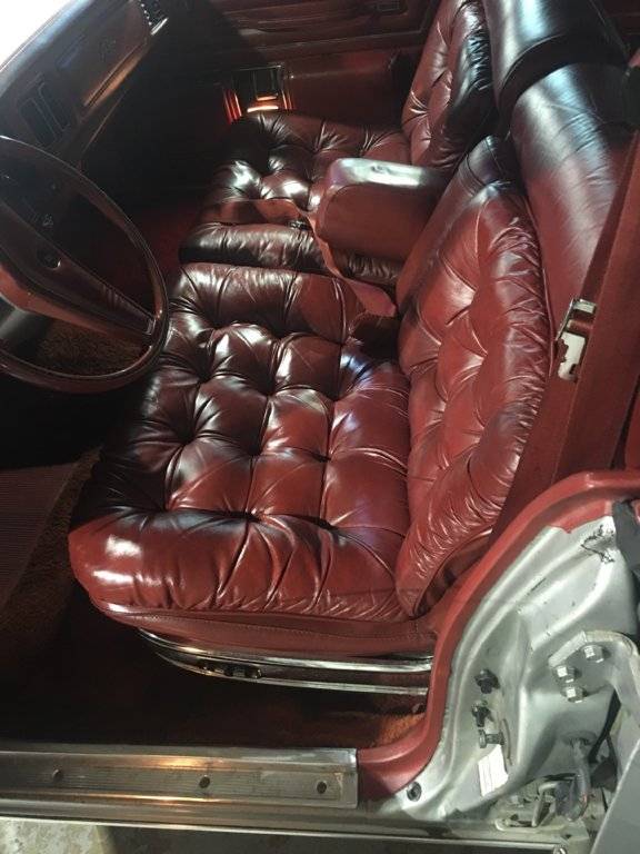

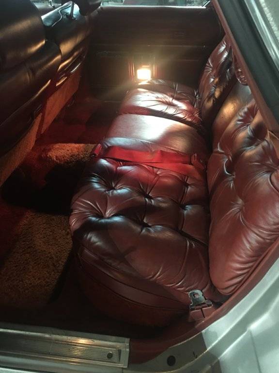

Took two hours of gentle cleaning to get the grime off with some very mild saddle soap for the front seats. Then I hit it with Lexol leather preservative (very diluted mink and kneeds foot oils). It also has a little parifin in it so it will need to be buffed out with a soft rag tomorrow.
Back seats were mostly dusty and took less than a half hour to bring big them back to like new.

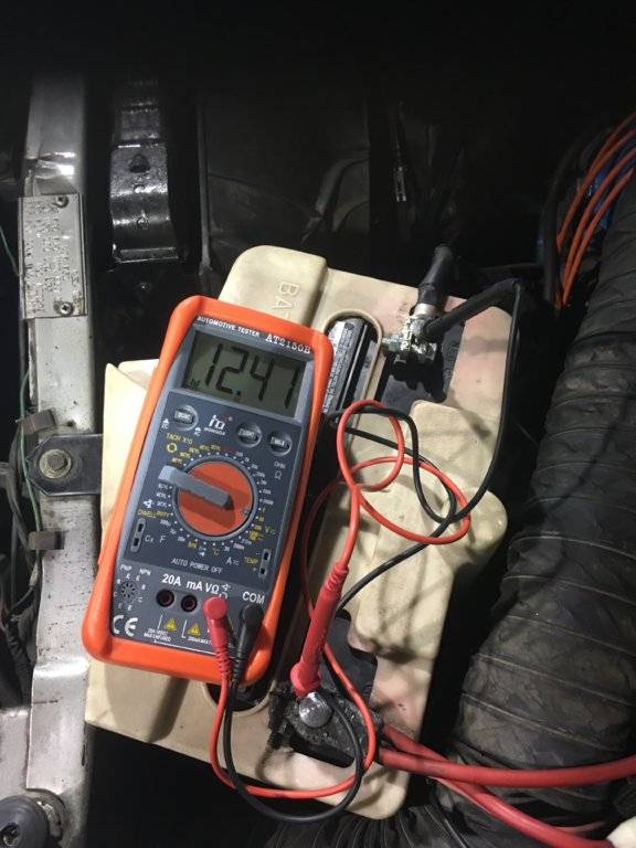

Back at it today starting a check of the ignition system. Starting by checking the battery. First thing in the FSM they say to check.
Just over 12.v. When I opened the door to put a little load on it, it started dropping fast.

Took two hours of gentle cleaning to get the grime off with some very mild saddle soap to coral up the front seats. Then I hit it with Lexol leather preservative (very diluted mink and kneeds foot oils). It also has a little parifin in it so it will need to be buffed our with a soft rag tomorrow.

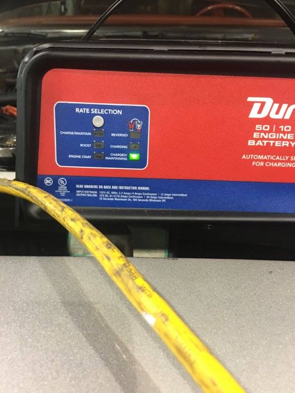

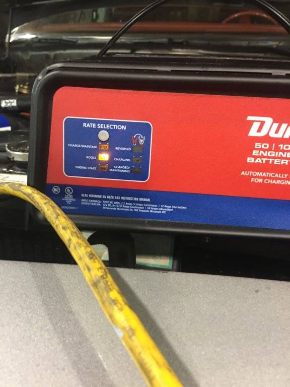

Five hours at 10A charging later......
Started up first Turn of the key... a little rough because I blew some gumout down the throat and all over the throttle plates to clean off some of the soot from the backfires I was experiencing yesterday. Then it settled right out.

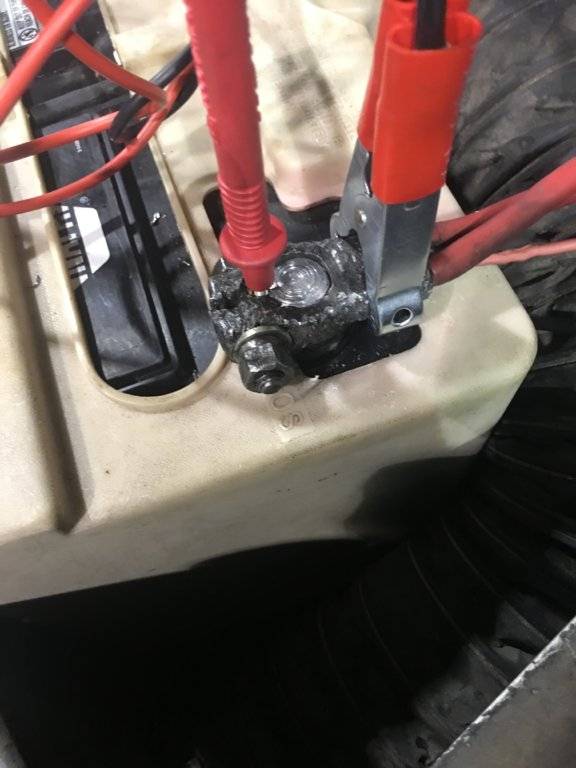

Checked the alternator and took a little of the down time to refurbish the positive terminal a bit so it would sinch down on the battery post.
A washer, some gentle squeezing with a vice grip and some gentle persuasion with a hammer to realign the ends of the terminal.
Alternator putting out 14.75v.
The FSM was right. Check the battery voltage first.
