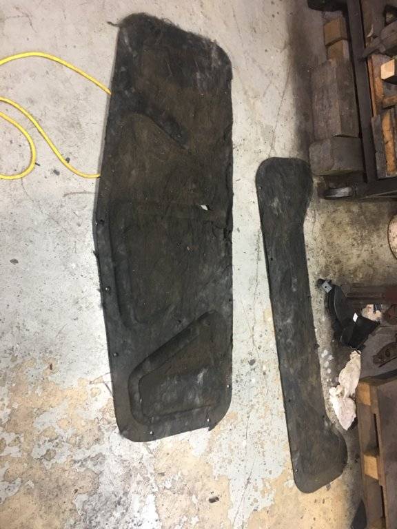

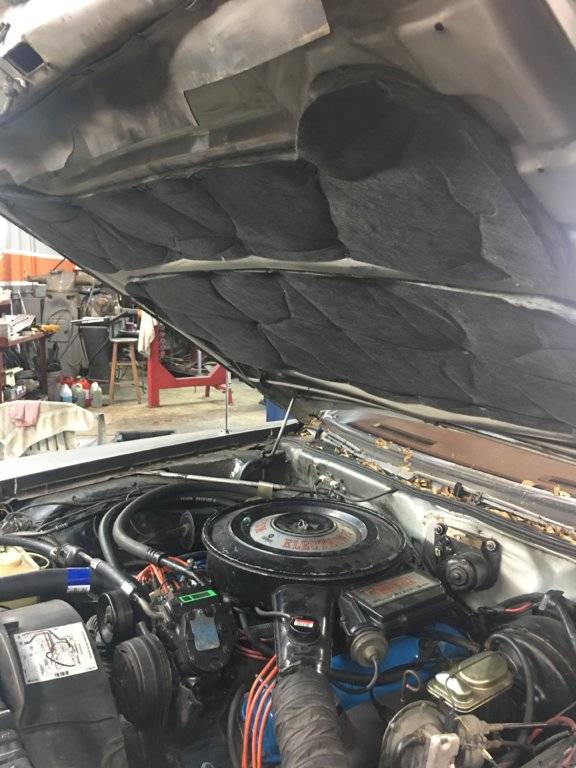

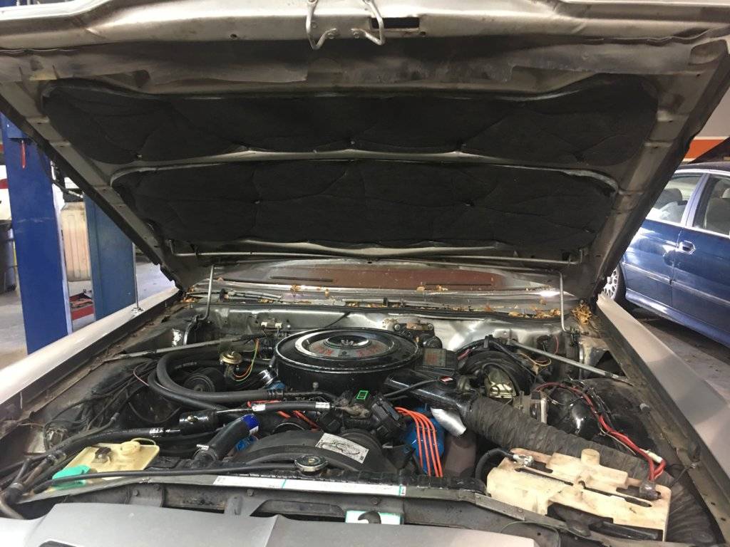

Ok Stan.... the hood insulation story. Just for you....

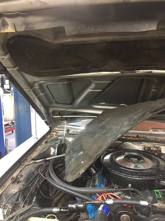

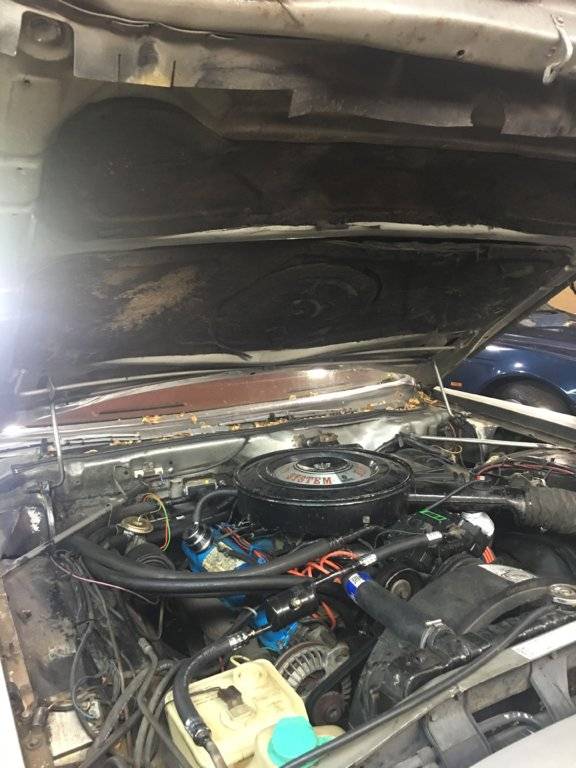

Original hood insulation pads. Forty years of crib about to say goodbye.

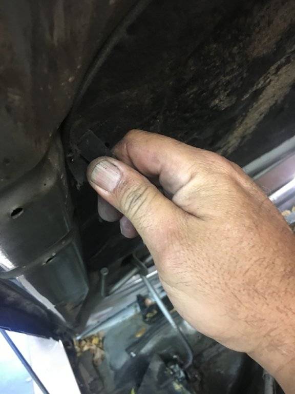

Attaching clips come out easy enough. Pull and a little twisting. It helps if you groan a little too.
I should have put a drop cloth over the engine. The pads were so filthy they we literally dropping clods oh dirt and dried grease.
The original pads were die cut and formed for a clean tight fit. I guess I could have steam cleaned them...but no.....
I’ve actually done that before and this ain’t no Maserati. New aftermarket ones will do just fine.

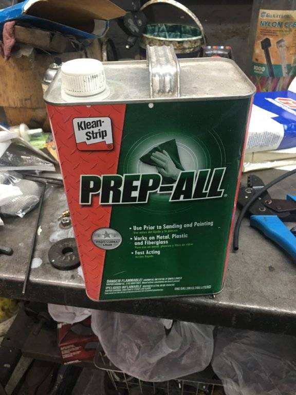

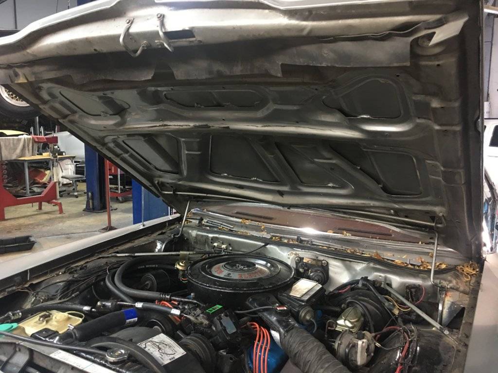

Underside of hood. Was also not very clean. Time for some.....
Prepsall .... easy on paint and tough on baked and caked grease and oil.
REM is the manufacturer. They include all the replacement clips. New clips are a dead match for the originals. I was afraid I’d have to straighten the new pads out as they were wrapped kind of tight to fit in the shipping box. But they sprung out of the bag just as you see them here.

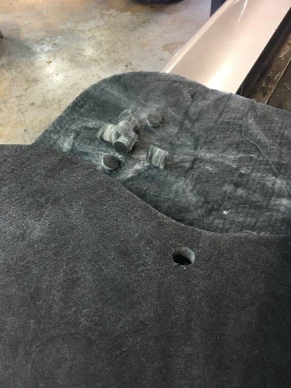

They also have two sides. A black side with a tighter compressed fiberglass mat; and a fuzzy side with open layers fiberglass.
The die cut pads still have the plugs which is a bit of a pain and itchy to get them all out.

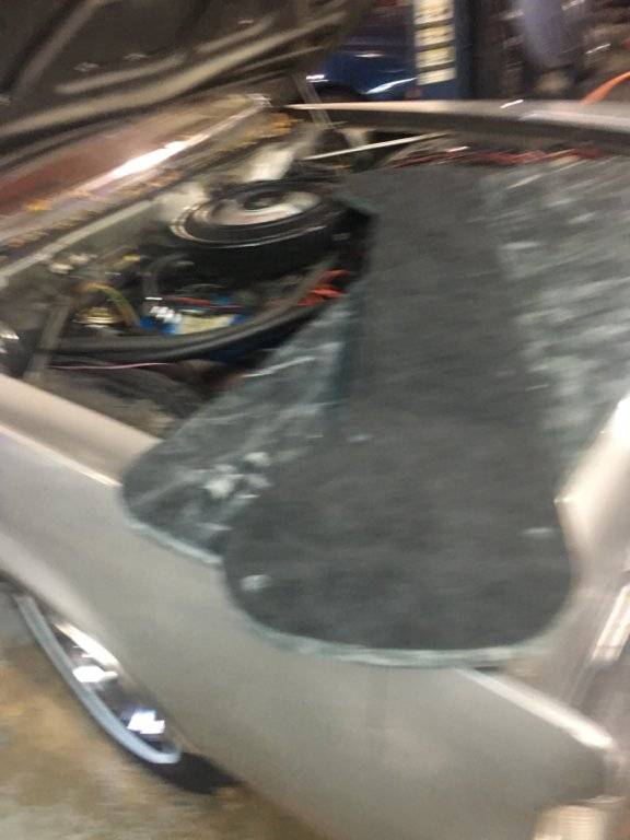

All in but a little wrinkled.
I decided to mount them with the black side toward the engine. Wrinkles would not be visible had I put them in the other way.
See what I mean... a little wrinkled. Hopefully the material releases a bit after a few heat cycles. And..... Speaking of heat cycles....

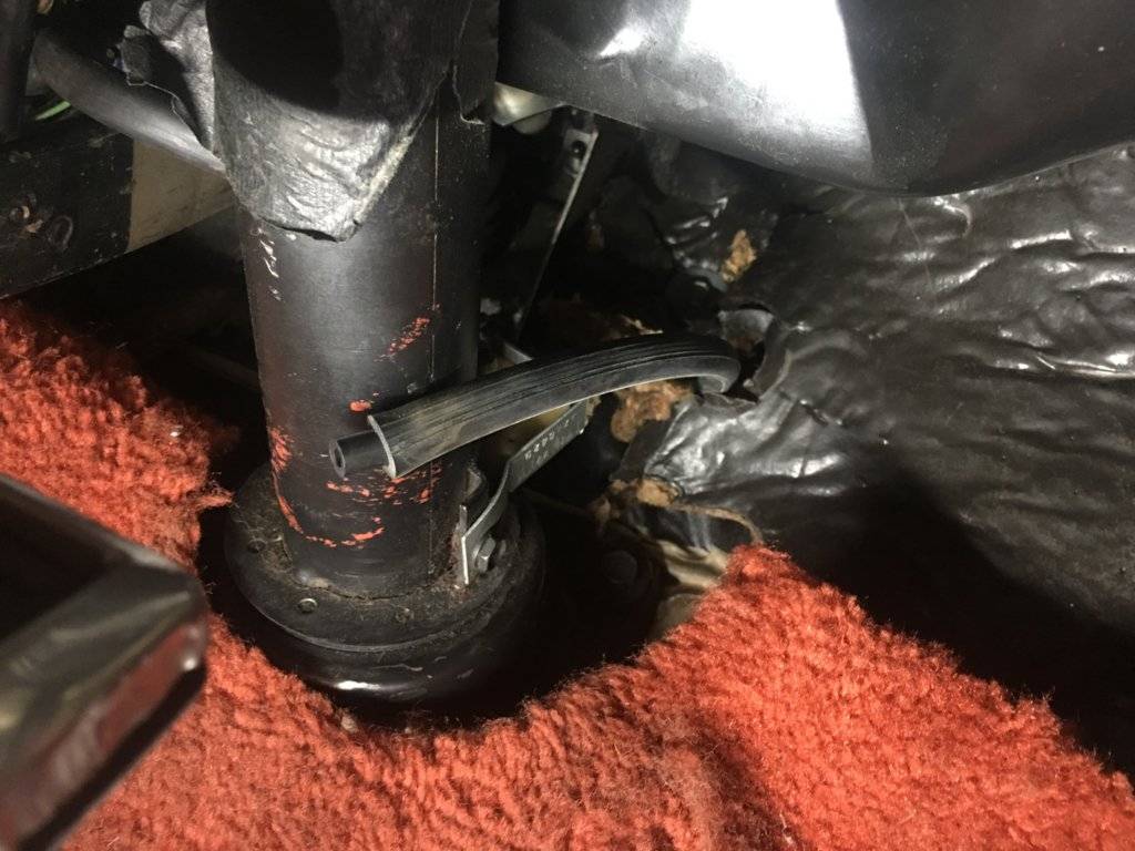

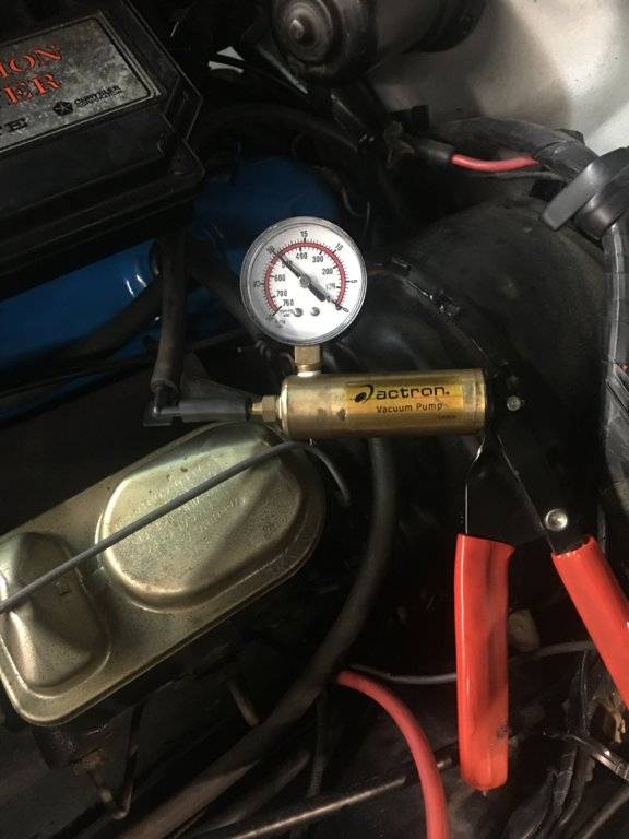

Went in today and started to look for where a vacuum leak might be. Since the auto parking brake release wasn’t quite working I started with that.

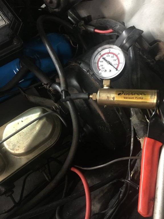

Here is my handheld vacuum guage and pump connected to the line that feeds the parking brake release switch on the steering column. Transmission was in park so it should have held some vacuum off or least given some resistance. No discernible vacuum accumulation. No resistance. Sucked on it and it was like drawing on an unlit Churchill cigar. It’s a big line and I gave it several good pumps but it just wasn’t going to hold vacuum at all.
Went down to plug the line to make sure it was the switch and not the line.
No problem with the main line to the engine that feeds the switch. Need new switch.
Next came the line to the vacuum motor. No vacuum building at all... need a new switch and motor.
Put a plug in the line down by the switch. Need to start sourcing switch and vacuum motor. Project for another day.

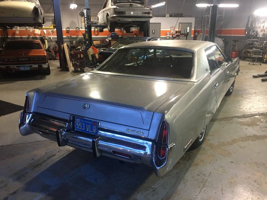

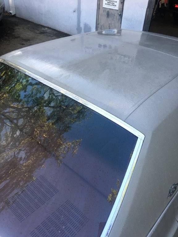

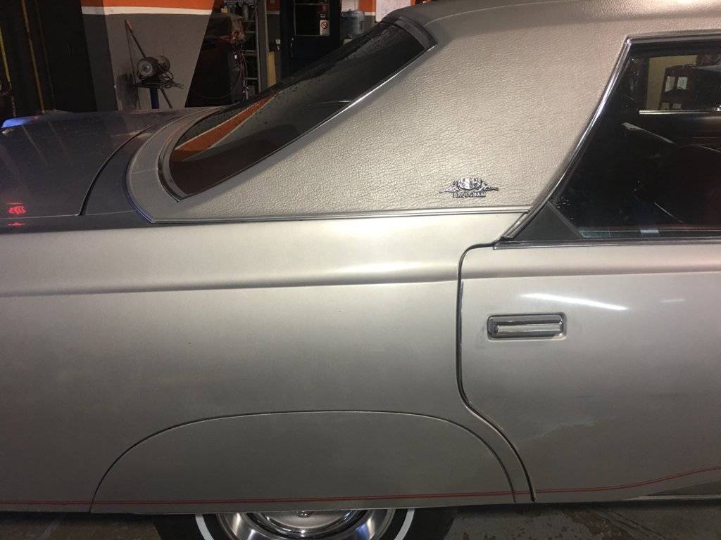

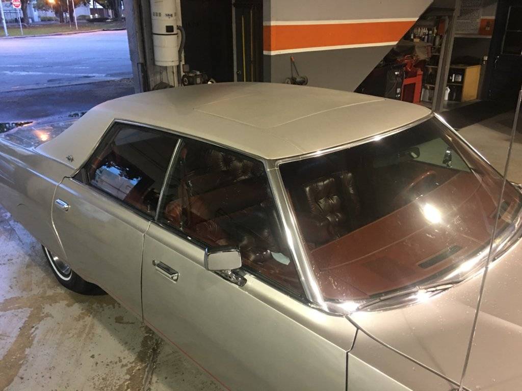

Meantime, I figured I would give the vinyl roof a good cleaning. Soap and water were just not cutting through the grime of 40 years.
Took out my Wesley’s Bleach White to cut through the grime and oxidized vinyl. It made a difference but I would never recommend anyone do the same. It is great on white walls but contains a weak acid and strong surfactant that works great on tires but can damage anodized metal if not used very carefully and removed quickly. To minimize this I washed and left the mild soap on before using it on the wet, soapy top. The difference was impressive on the first pass. The second pass made an almost equal difference. The picture is actually of the second pass.
After careful washing a second time with soap and water. The difference was impressive. The top and paint are almost the same color. I dare not do it again but it was worth the effort I think. I dried the top and dressed it with some Armorall vinyl dressing and cleaner.
Usually the cleaner/dressing comes away with a little dirt but not this time.
Detail view of same color top and paint... almost.
Now if I only had some NOS Brougham emblems....
view of top from behind.

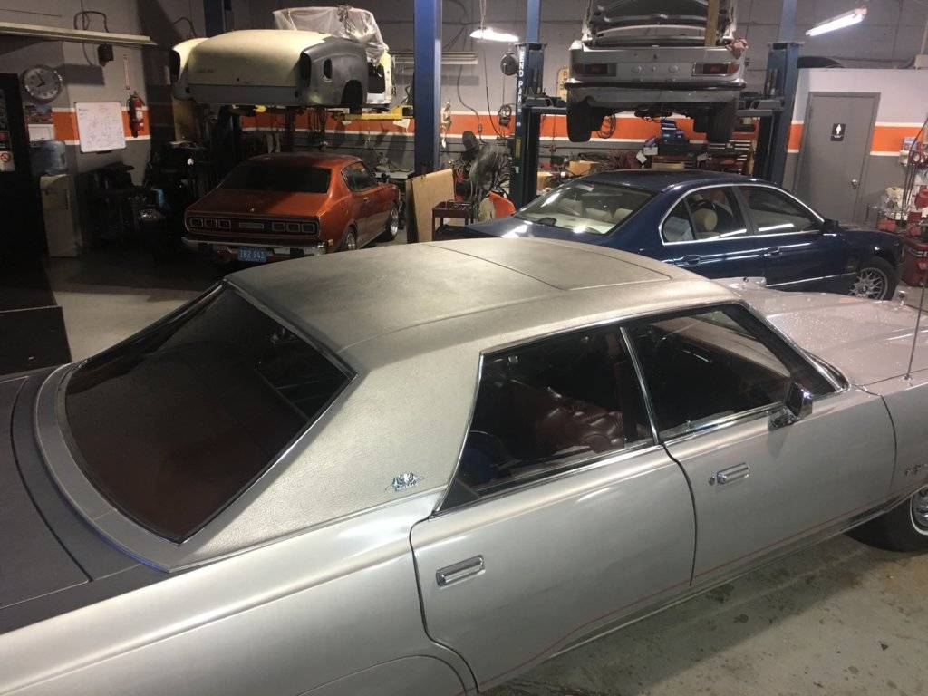

View of top from front... notice the worlds tallest antenna. That itself was a project that I didn’t document but would have been worth it if I had.
I even made a little time to hand polish the front bumper. Still need to raise it as far as I can.

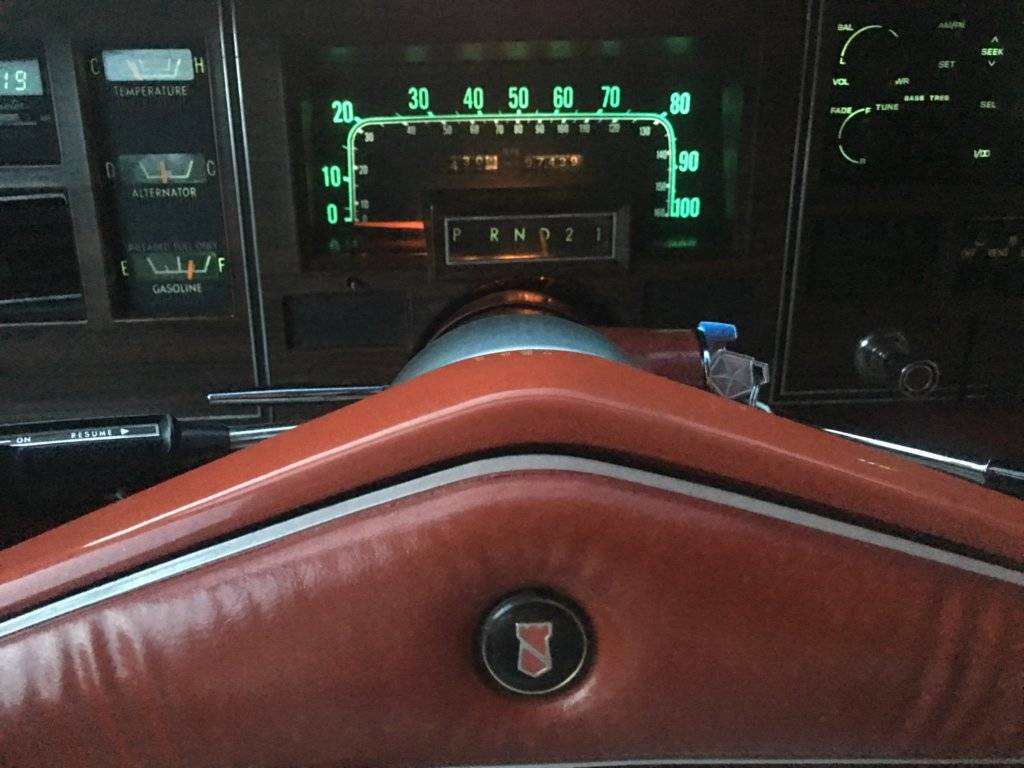

Oh and here are the dash lights working.

Went in and started to look for where a vacuum leak might be. Since the auto parking brake release wasn’t quite working I started with that.
Here is my handheld vacuum guage and pump connected to the line that feeds the parking brake release switch on the steering column. Transmission was in park so it should have held some vacuum off at least given some resistance. No discernible vacuum accumulation. No resistance. Sucked on it and it was like drawing on an unlit Churchill cigar. It’s a big line and I gabe it several good pumps but it just wasn’t going to hold vacuum at all.
Next game the line to the vacuum motor. No vacuum building at all... need a new switch and motor.
LED light bulbs for the dash? I like the brightness of whatever bulbs used. What’s the secret?
Javier, I can't find the right words to express how thankful I am that you chased down and isolated the vacuum leaks rather than try to tune the engine around them... This is a "Role Model" thread. :thankyou::thumbsup::thumbsup:
That's what it looks like with all the 194 dash bulbs working at the same time. I had one light bulb barely illuminating and replaced them all and the dash looks and lights up like a brand new car again.

I'm not too impressed with the hood mat. I'll skip that part until I see a better one.
Let me know if you find a better one but for now it was the best thing I could do. The original, besides being filthy, was all cut up around the air cleaner..... I was just trying to avoid it coming down all by itself.
