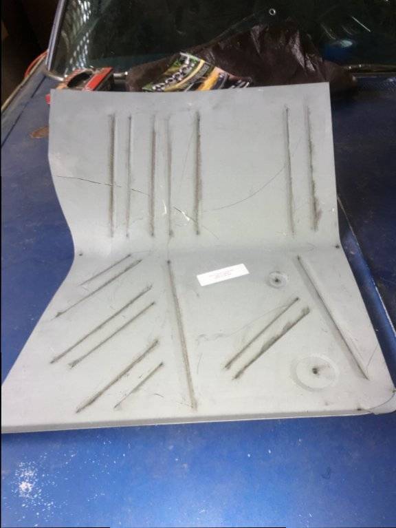

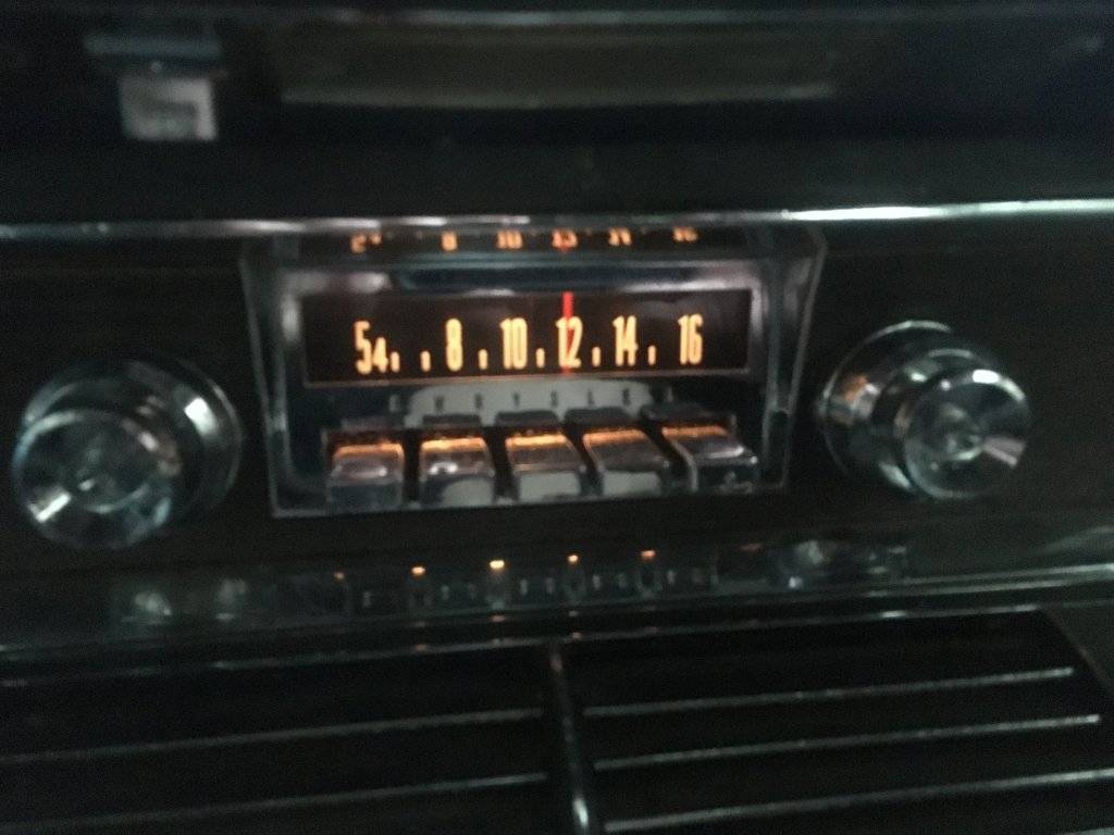

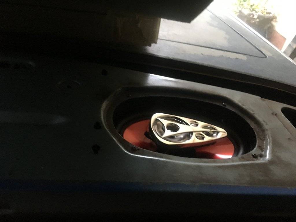

Got my 6x9 speakers in the package tray and the two 4" speakers in the dash wired up, got my radio back from Gary Tayman and installed. Everything looks, works, and sounds great! Did the FMR-2 and Bluetooth conversion. I also decided to go with the floor pan from Classic 2 Current and it looks like it will work better than the donor floor pan I got from the derby car. So that's ready to go in as soon as my welder is ready to do it. Getting closer and getting excited to drive it again.

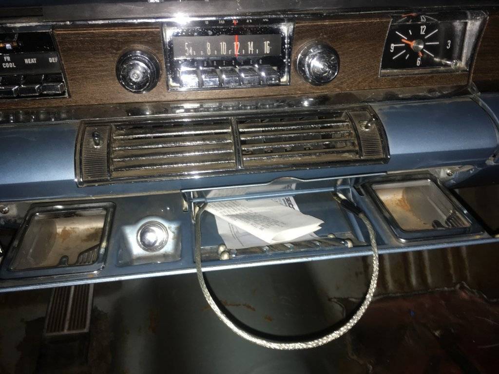

That dash looks awesome! I usually think of myself as perfectly happy with AM radio and a 6x9 but these conversion jobs are growing on me. Not exactly where I need to put my $$ right now but I can see it coming!

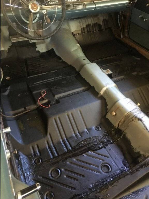

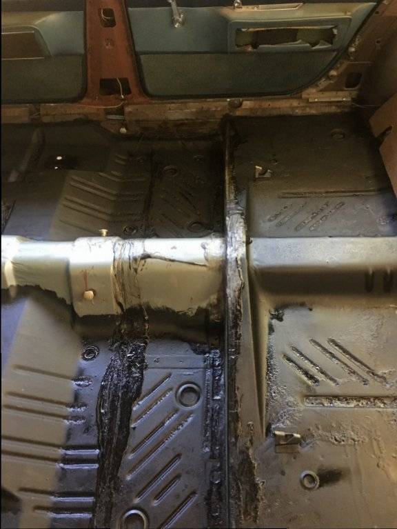

Just a little update here, POR15'd the floor yesterday. Just waiting for the carpet to get here from Stock Interiors. But I have some bad news, Friday after work I was driving home and my 2005 Dodge Ram 3500 was shifting weird like I lost second gear and had no power. Yesterday morning I was taking it to my friends transmission shop when I left the house I had nothing. Had to get a tow and got the call later in the day, bands were gone, torque converter done and the rear u joints were bad. So looks like I'll be working long days and weekends to pay for this one. Bummed on the truck but stoked to be getting closer with the car

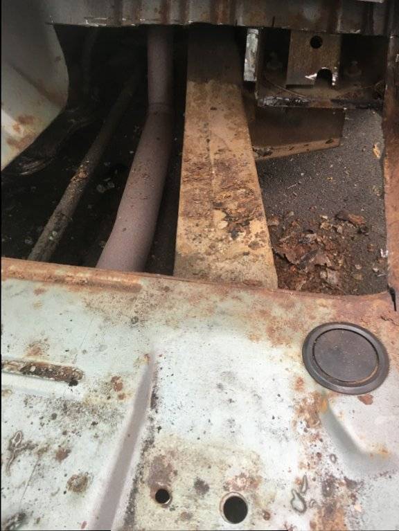

View attachment 124092 View attachment 124093

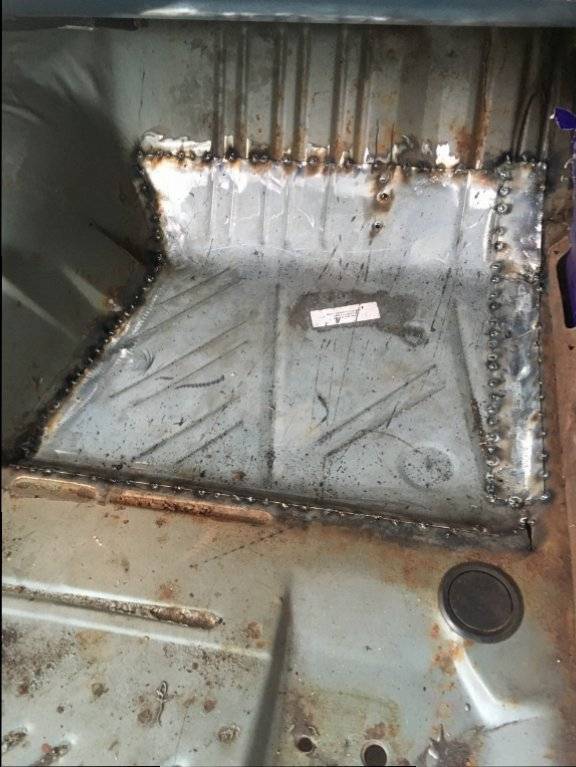

Pat: Your car is lookng great with the new dash pad color, and the floor work is mighty fine. Please tell me what steps you followed to apply the POR-15. It looks like it was sprayed - not brushed. I'm getting ready to do the same to the floors in my car.
Also, the replacement floor panel looks like factory. And is that the panel everybody poo poo's?
Rip, I vacuumed and cleaned the floors real good, scraped off all the big chunks of rust and brushed the por15 on. The floor pan came from Classic 2 Current, we cut it to fit what we had to cut out and welded it in then I put some roofing silicone over the seams. I figured if it's strong enough to seal a roof and holds up to the heat of the roof it'll be good enough for me. I don't plan on driving in the rain too much or storing it outside. Thanks for the positive comments

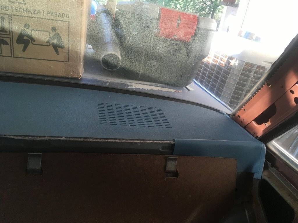

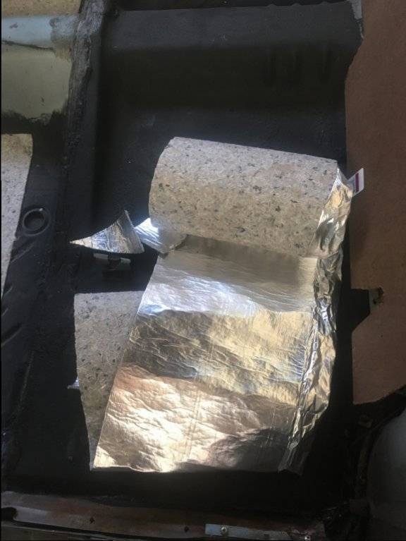

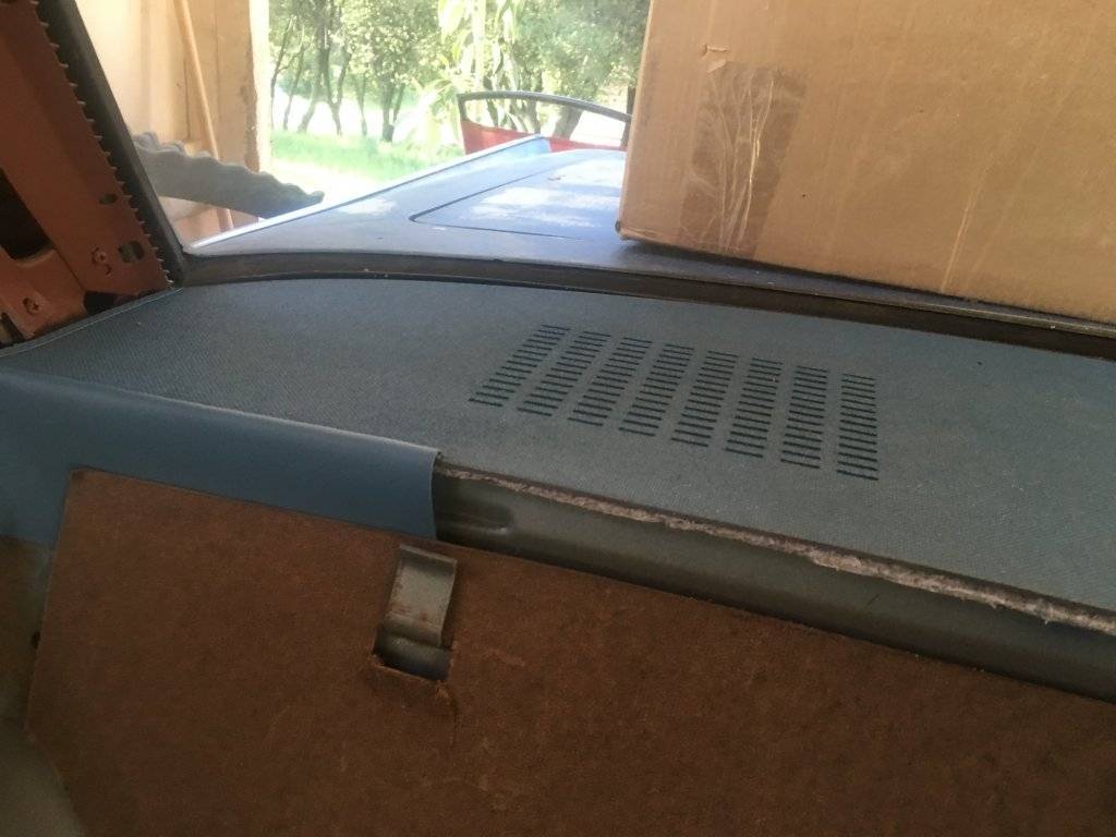

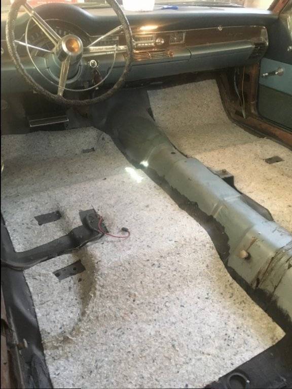

Oh yeah... my carpet came yesterday! Putting in some hardwood floor underlayment that's foil on one side and carpet jute on the other. It's about 3/16" thick. Hoping it helps with the heat and some road noise. I also got the package tray in last week. I'll post pics in a little bit
