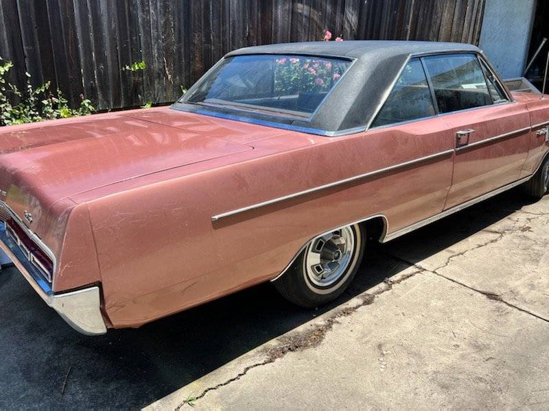

The 14 inch Wheel covers are correct.
However, will look much better with 15 inch Magnum 500's especially with the color combo.
The body side vinyl molding can be removed safely without damaging the paint.
It really is ugly on that car as it detracts from the body lines.
Be careful with the side molding. Some were just press on, but others had a removeable plastic strip.
The wheels and the strips would be at the bottom of my list. I agree that 15” may look good, but these 14” are really nice AND original.
In the same vein, if the add-on moldings have been on for the life of the car, I’m not sure that I would remove them. Ar least not at first. And I’d make triple-sure that there is not going to be some shadow or slight paint discoloration after removing them so many years later?

Nice looking Fury. Check under the vinyl top for rust or bubbles, especially around the rear glass.

Agree with not removing the side trim. It looks OK, plus removal could expose holes and detract from appearance.

BUT - From what I see in that one pic, I would like this prospect car enough to consider buying if it checked out (meaning, you have found an eye-pleasing example)
Like most Mopar cars from the 60s, most of the aluminum trim, grilles, bumpers, taillight lenses, and 1/2 of the sheetmetal is specific to that car, and that year. Some sheetmetal parts can interchange, but usually only for 2 years at most. If this car is complete and in GC that's all that matters.
Being a Sport Fury brings bucket seats, possibly console, and the H-code 383-4 barrel is a nice upgrade over the G-code 383-2 barrel. It is common for folks to upgrade and call it a 4-barrel car, so check the VIN - 5th digit is the engine. In 67 the H-code got better exhaust manifolds than prior-year 4-barrel engines, they curve upward a bit, while the standard ones run parallel to teh valve covers.
An H-code 383 doesn't make this car rare or super-special, but it is the 2nd most powerful (other than the rare 440) and it will make for a well-balanced car that will be fun to drive. You won't win races with it, but anybody that rides in it with you will recognize it's got some bravado.
Check the firewall for rust, from near the heater hoses, across to the wiper motor, and master cylinder. Look for pinholes. These cars can get leaves and pine needles down in the cowl, thru the vents at the windshield base, and the debris can hold moisture. This car looks well-loved, but check it anyway. There could be issues on the dashboard-side of the cowl (harder to inspect) but if the firewall is OK the interior side likely is also.
This car has the 14" 'mag' wheelcovers, so it has drum brakes (unless someone converted to SSBC brakes). That means you've dodged the 66-68 Budd disc brakes, which are pricey to repair. Flipside - you may want to convert this to discs at some point, and that can be a $1000+ proposition depending on which parts you elect to use. (but it's a fabulous upgrade for safety)

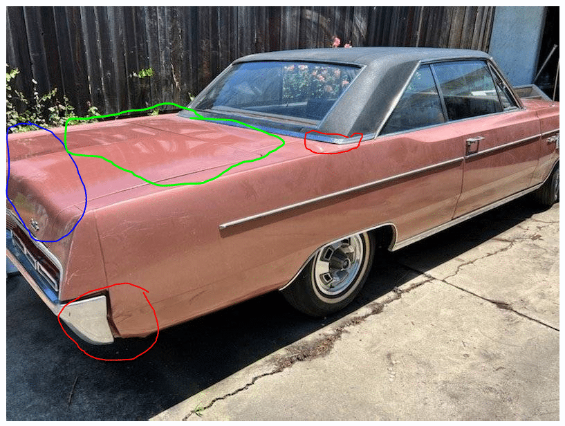

Red circle - check here for rust, and also between the trim and back glass. These would be the first spots for rust to appear. Look for any bumps under the vinyl. In my experience, this particular roofline (which it shares with the 66 300) isn't as bad for rust as some of the other C-body models.
Other red circle - someone else mentioned it - this area needs inspection.
Blue circle - might be reflections, might be peeling clearcoat if it had been repainted that way. You'll know it when you see it.
Green - this looks very much like someone wiped it dusty. Whole car looks dusty. No big deal there, though.

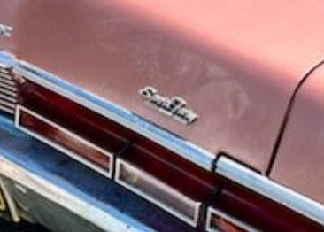

Thank you so much for putting so much time into your response and guidance! It's an "estate sale" so the seller has been less than helpful with any information and when it came time to make an appointment to see the car, I got crickets back so we'll see. I still haven't even seen it in person yet.
And I apologize for such a newbie mistake of calling it a Fury III Sport. I was going off the truck lid saying Sport Fury and side badging looking (from what I can see) like the III badge
The front fender has the red white and blue bars going vertically, while almost every other Sport Fury has those mounted horizontally. I learned recently that the vertical bars on the 67 might have contributed to the confusion, of people thinking that it stood for III. Who knows???

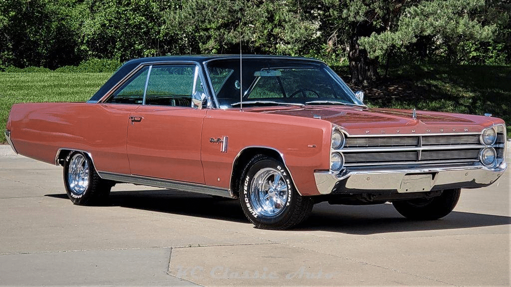

Coincidentally, here's a very similar car, and with the common 2-to-4-barrel upgrade. Eagle-eye viewers will note this one is using a B-body manifold on the driverside.
NOT MINE - 1967 Plymouth Sport Fury III 383V8 With AC $19.9k on AutaBuy
