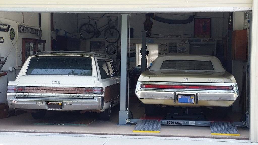

Well, since the cat is out of the bag, I bought the car. It does need some maintenance, but it is what it is. I bought it because it was not red,( i've had 2 of those) and it's a TNT car. AC is not an issue at this point. It will be a "winter driver" ( nods to Carsten). I also bought a 26k mile 1968 town and country wagon from the same seller. It belonged to the mother of the doctor who owned this 300. And it was a one owner vehicle also.

I just got power and internet back within the last 4 hours. It sure is nice to stop sweating. Both "new"cars are safe in my building. The monaco safe in a customers garage, and the 73 t and c weathered the storm under the carport, none the worse for wear. Praise the Lord!!!
