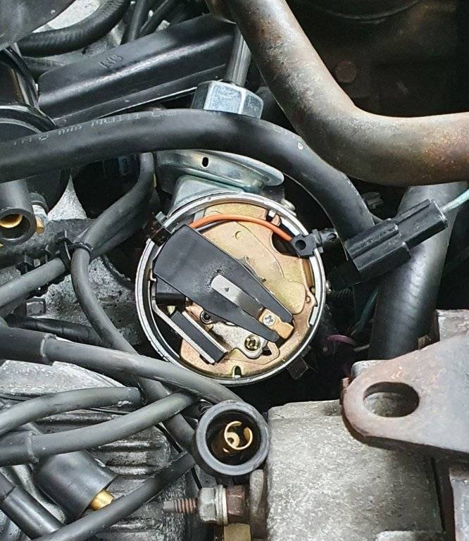

I did take some pics, this is what it was when I took it apart, looks like it should be pointing at the cylinder two wire imo, so I put the wires on using that reference

Not familiar with your setup but that distributor looks weird. Where is the pickup pointing at? Looks like a double pickup at 6 and 12 o'clock?
For reference, mine is at around 9 o'clock:
Remember that the distributor rotates counter clockwise..
Seen too many people--and I did this myself-- wire up the plug wires like a small block. Same firing order! Just backwards..LOL!
