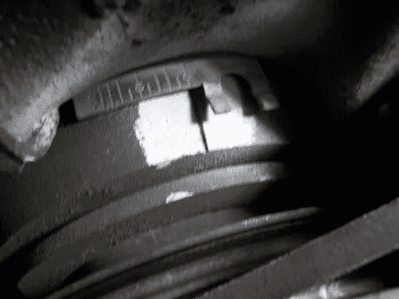

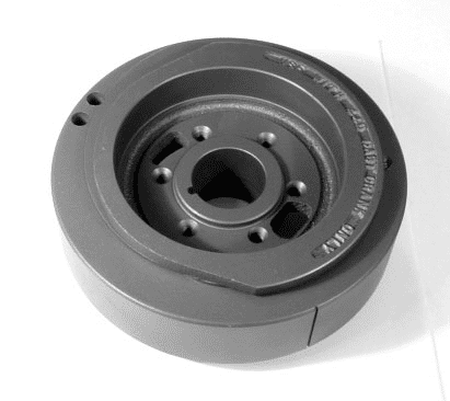

Okay, could someone send a picture of what the TDC mark on the balancer looks like? Also, on the timing cover, I have the degree notches and then a large U. Where is TDC on that? I do have a timing light, Innova brand I believe, have not gotten to use it yet though.

The groove is the TDC mark on the damper.
Timing marks:
Take a piece of blackboard chalk and scrub it across the damper slot and then across the timing marks. Wipe it with a rag and you'll see the marks better.
