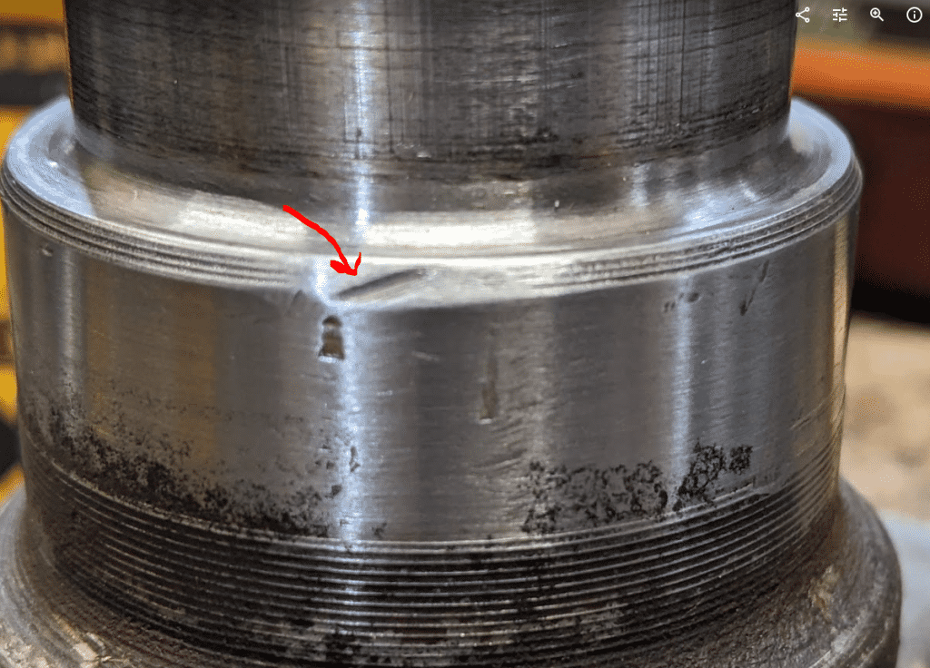

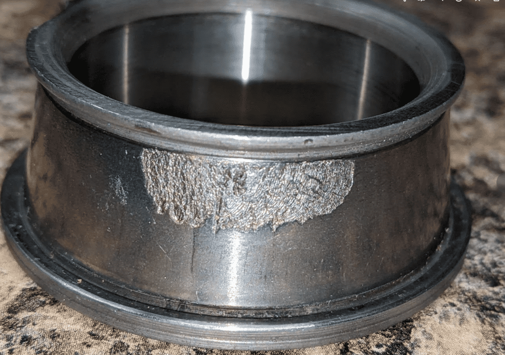

News, both good and bad.
Everything is back together and the noise is still there, although it seems somewhat quieter (but might be imagination).
Based on the debris that came out of the driverside bearing, it needs replaced (I will have both of them done).
Will contemplate over the winter whether to buy a press and do myself or farm it out. (I am at the point that I don't have footprint for even a cheap 20-ton hyd press).
This is a bittersweet result as I wanted the car to be fixed.
So I still have the ongoing problem, but perhaps those 3.55 gears are still good (which are worth far more than the cost of 2 axle bearings).
Perhaps next spring I can swap the 3.55 into my 300L for a noise comparison - the smogger 400 in it needs a little help vs the 3.23 in it.
So for now - case closed.

cleaning and repacking a bad bearing will not make a noise go away...even temporarily
