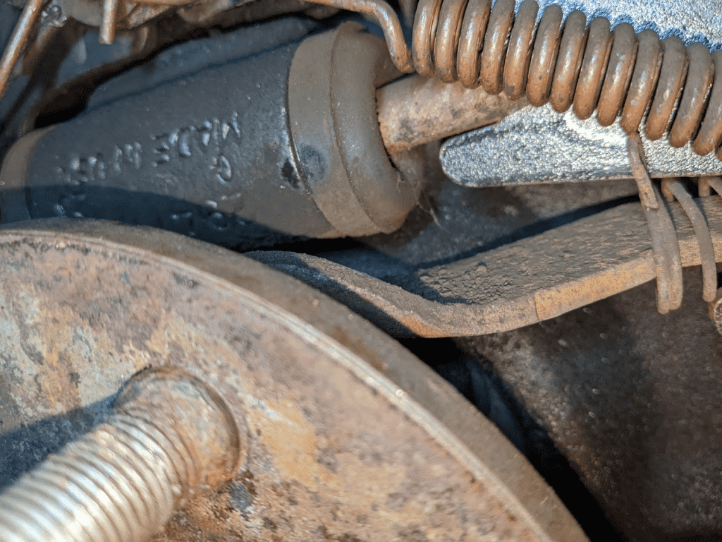

I sometimes have a very squeaky brake when driving forward and hitting the brake, it goes away after 20 feet or so. If I drive the car 1/week it doesn't happen. Only if it sits for a month or longer.
Tonight I pulled the rear wheels to check the brakes and begin a gear swap.
Passenger drum came off easily, the driver's required a little nudging with a small prybar (but not unusual).
The passenger side backing plate has some wetness from the axleshaft and lower. Teh wheel cylinders have the type of boots that are very stiff, so don't want to pop off to see if a leak, but it is pretty dry south of the whl cyl.
There is a tiny bit of wetness that starts just south of the axleshaft retainer flange.
I will presume this to be the squeaky-brake culprit. (until better evidence comes along, anyway)
Driverside brake looks A1, just some mild dust on the 'new' springs installed at the last brake job.

Pic of under the wheel cylinder:
